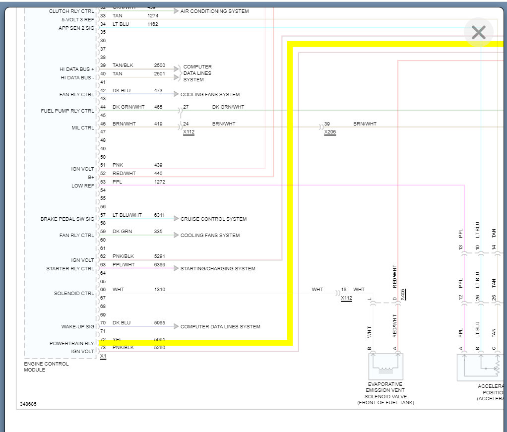

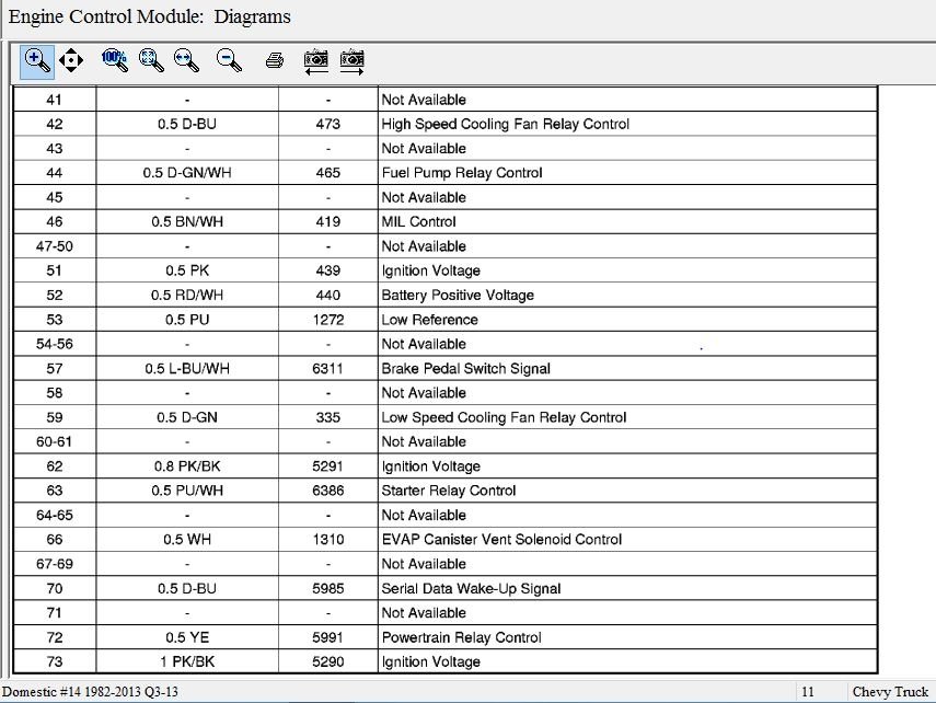

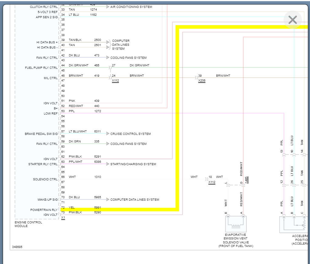

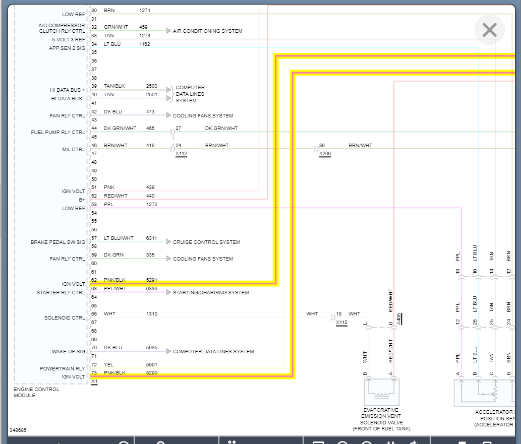

Good evening, friend!
Thank you so far, but please I want you to help me and analyze this.
From the picture below, I check ignition voltage on ECM Connector X1(LAF )51 using test lamp and it illuminated brightly. I also check battery voltage to ECM on XI(52) and it illuminate brightly. Then I further check X1(62) for ignition voltage using test lamp it didn't illuminate, I also checked X1(73)for ignition voltage, but no way it didn't, what could cause?
Wednesday, November 24th, 2021 AT 2:24 PM

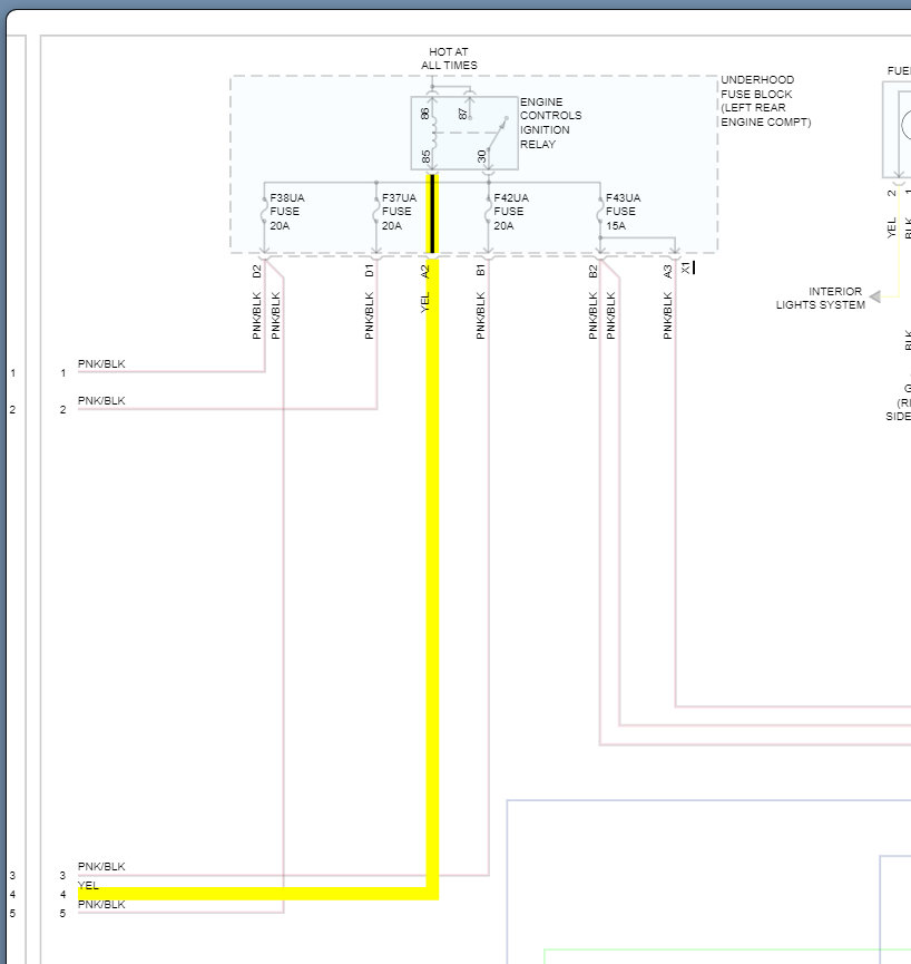

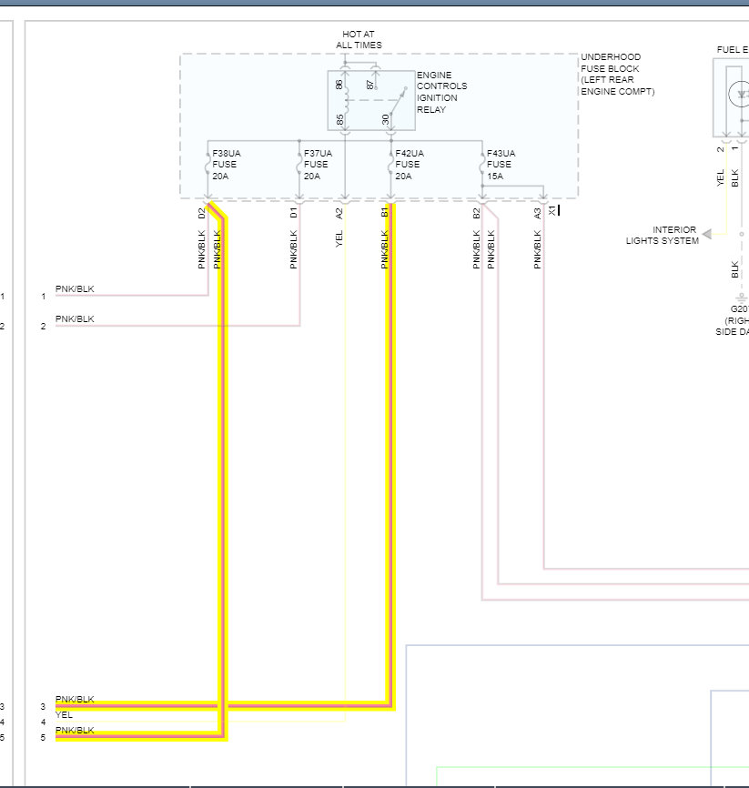

Both of these circuits are powered through separate fuses and then a single relay that is controlled by the ECM.
So, the way this works is when the ECM wants to power these ignition circuits, it grounds the relay from X1 pin 72. It provides ground on this circuit, so you need to check that by putting your test light on battery positive and then this terminal and if the light comes on then the ECM is grounding that relay.
If that is the case, then either both fuses are blown, or the relay is not closing.
Let me know if this does not make sense because it is important to test it properly or you will get false results.
Thursday, November 25th, 2021 AT 7:33 AM

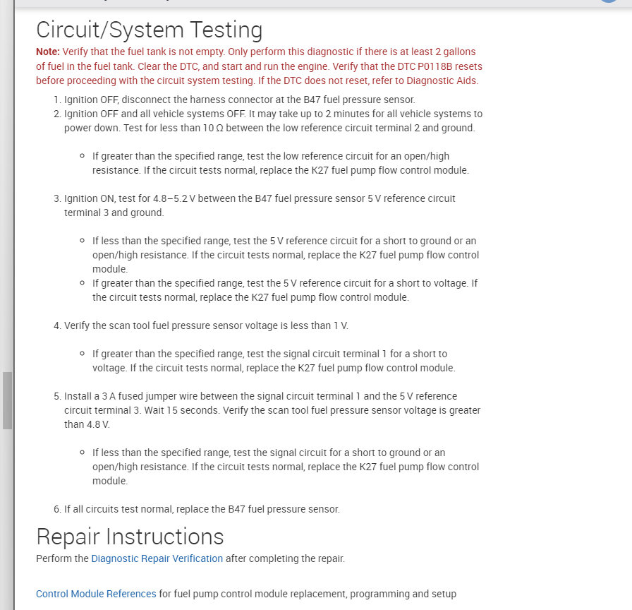

Okay. That is great however, if you replaced both the steering assembly and ECM we don't know what is causing that issue.
When we are doing something like this, you always want to only replace one part at a time so that we know what was causing the issue.
However, at this point, I would suggest just going through the testing as the vehicle sits and then repair what you find with that testing.
I attached it below.
Saturday, November 27th, 2021 AT 12:25 PM

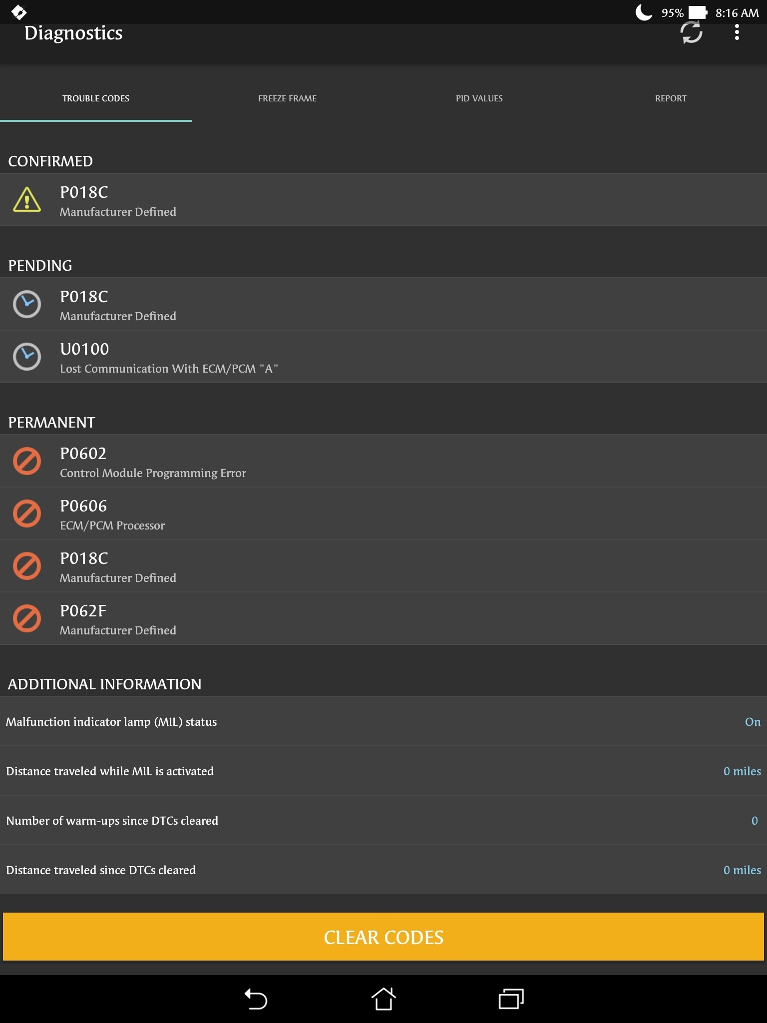

Yesterday I did a lot of testing starting from putting the old ECM and power steering module, and I diagnosed the vehicle, and it stated as follows:
1. Stored fault -p018c
2. Pending fault- p018c and u0100
Permanent fault- p0602, p0606, p018c and p062f.
Then I disconnected the old ECM and put the New ECM and diagnosed it, it displays the same code and added B3055 (No transponder modulation).

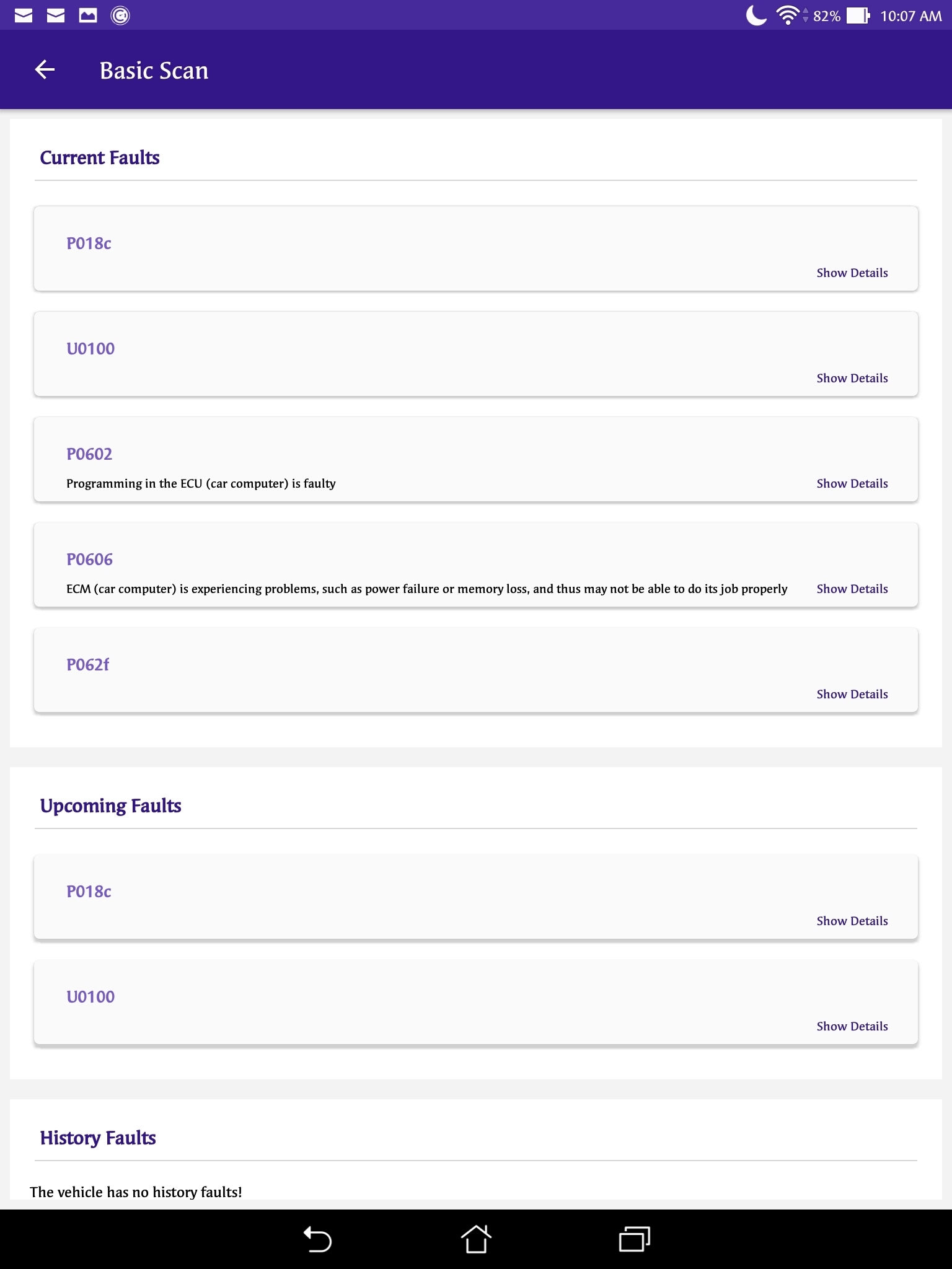

At this point I said let me disconnect the ECM and try to connect without ECM and to see if it can communicate, as I disconnect the ECM, the Check Light went off and I connect, it connected, and I scanned it still display all those codes. At this point I was confused and said this is not the problem of ECM or power steering but BCM. Then I used another scanner to scan, and it display as follows, look at the pictures below, the first picture was when I changed the 2 ECM and scanned. The second, third, fourth and fifth was when I disconnected the ECM entirely and scanned only the BCM with another scanner.
Sunday, November 28th, 2021 AT 12:49 AM

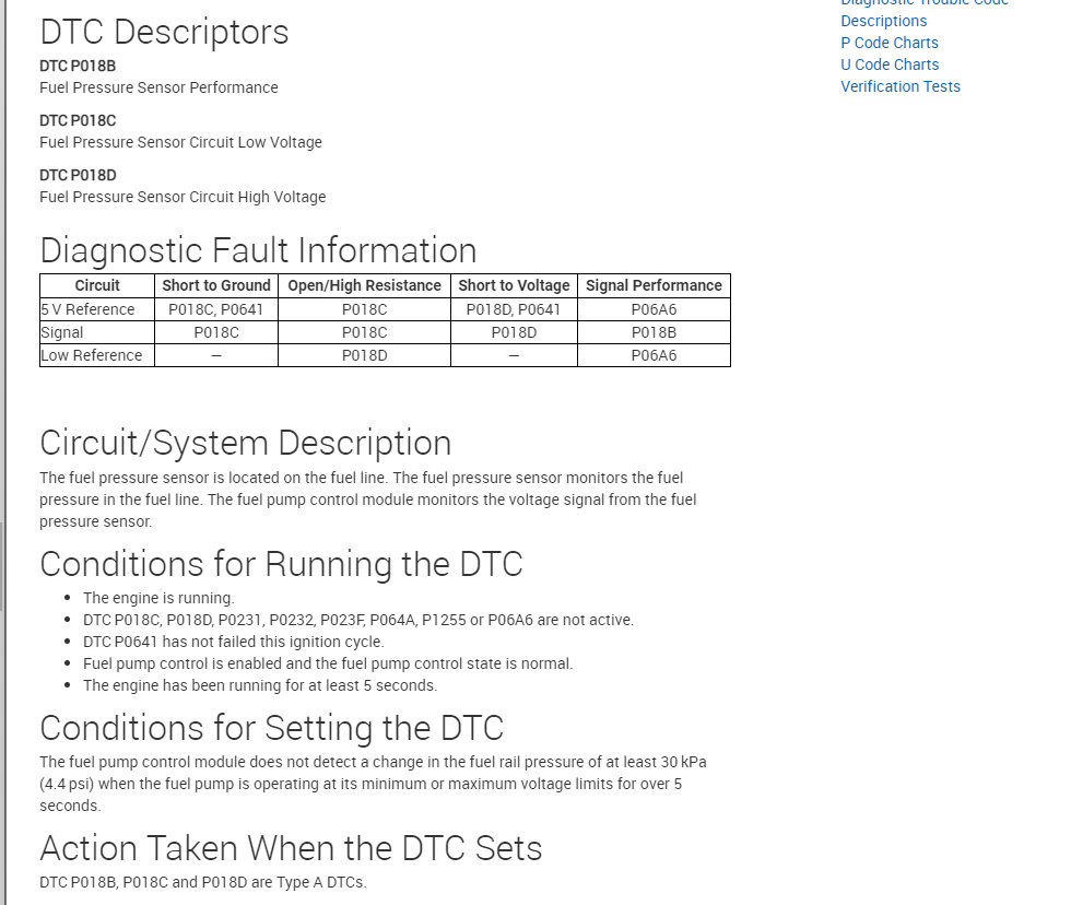

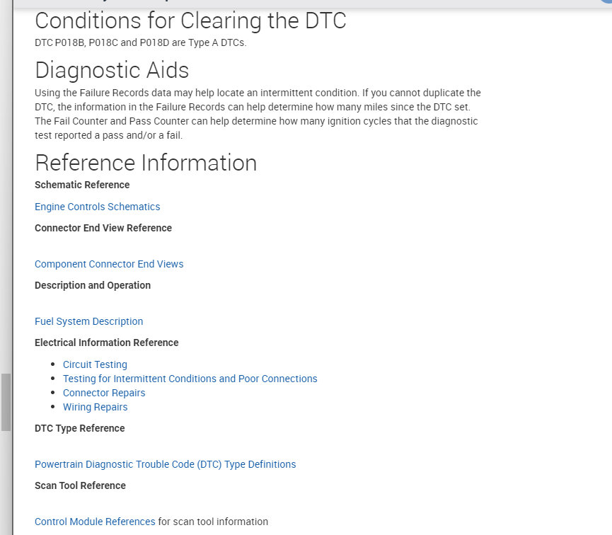

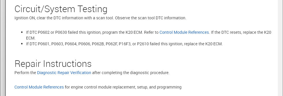

Okay. I think we need to step back and make sure we are following the testing on the info that the vehicle is giving us.
Disconnecting the ECM and checking for codes is going to give all sorts or different codes so we can't trust any of these codes at this point.
The only good info that provides is if you can not able to communicate with any modules using your scan tool and then you disconnect the ECM, and it restores communication to all other modules. If that is what is happening, then your ECMs are faulty.
However, if you hooked the first ECM back up and have the same codes plus the failed ECM codes then that ECM is faulty.
Then if the second ECM has these codes (P0606, P062F, etc.) Then that ECM is faulty as well.
Take a look at the info below on these codes. There is no testing required, basically if you have these codes, you replace the module.
At this point, I don't know if we have a module issue and a scan tool issue that can't communicate with this vehicle, but one thing is clear that if you have these codes then your ECM is no good.

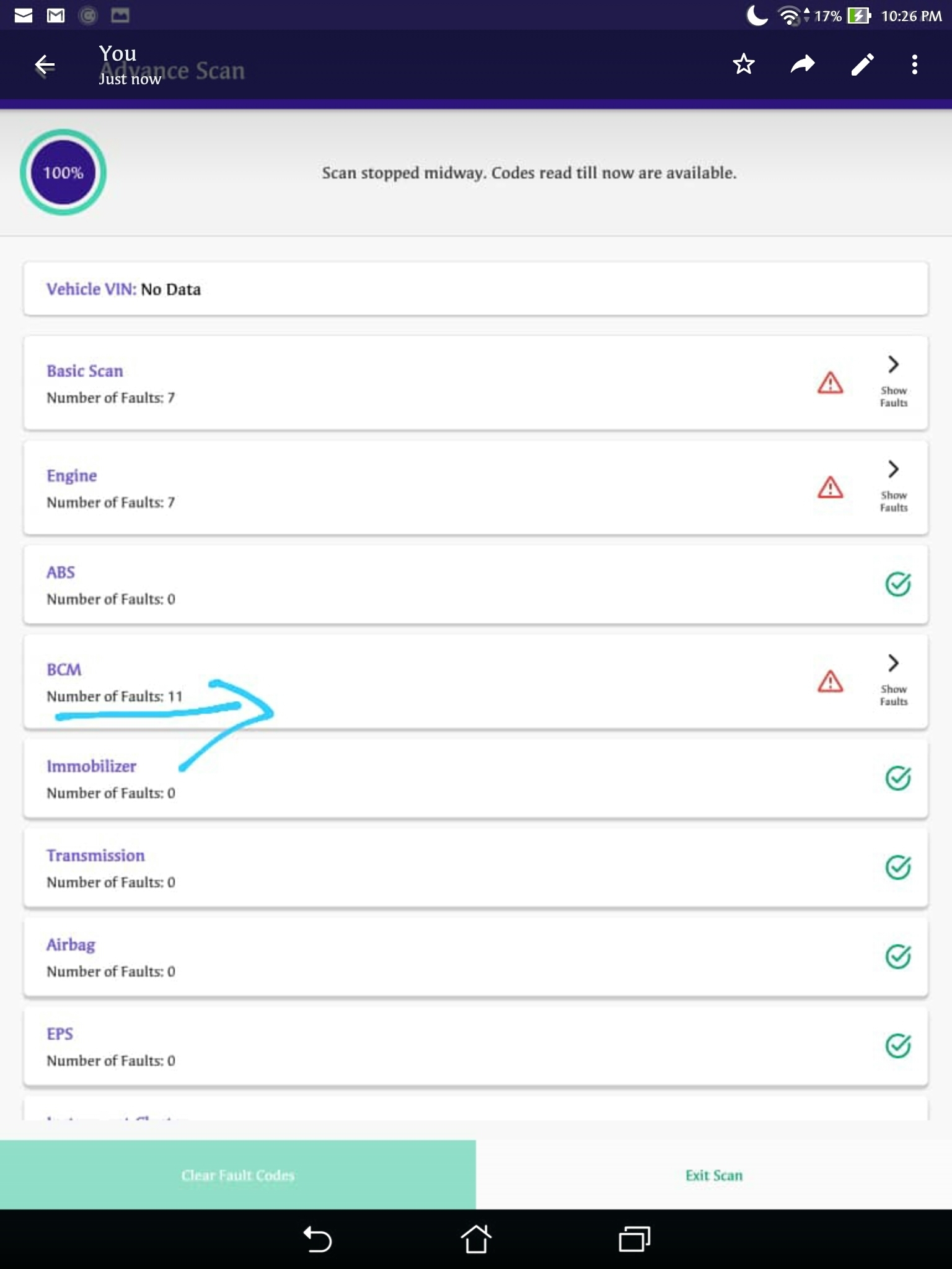

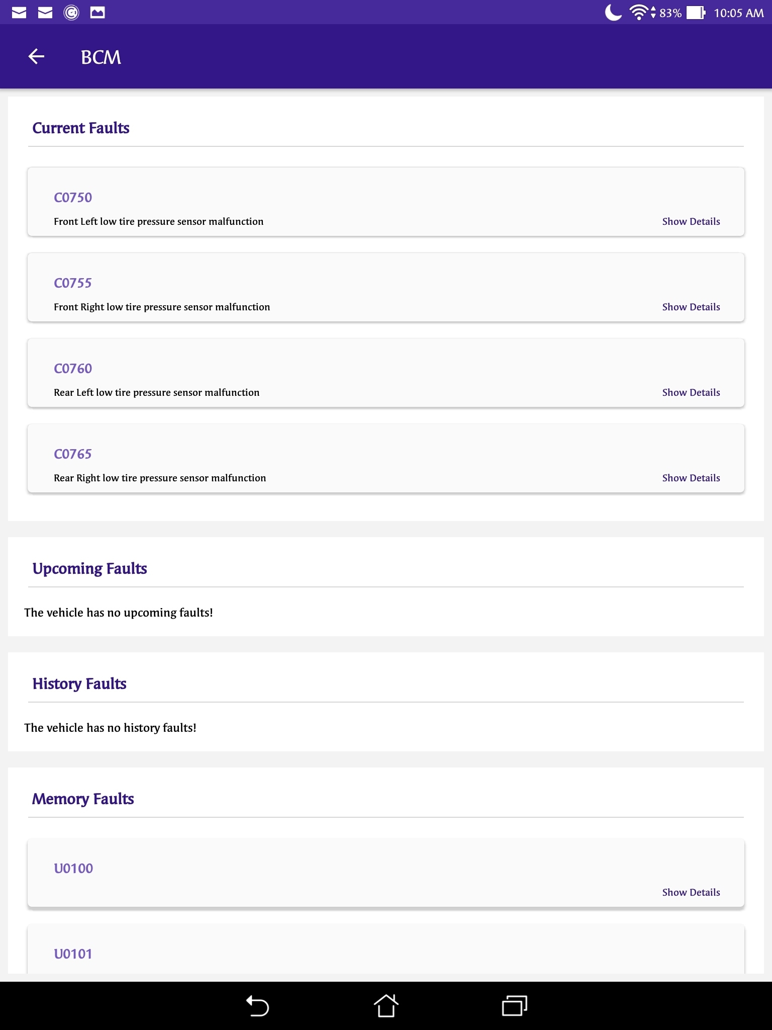

Sunday, November 28th, 2021 AT 1:07 PM
MALLYBOY
  • 338 POSTS

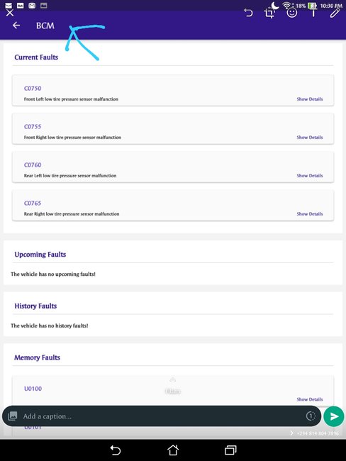

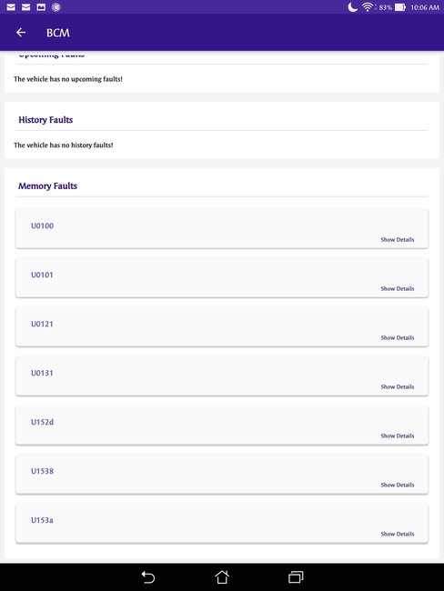

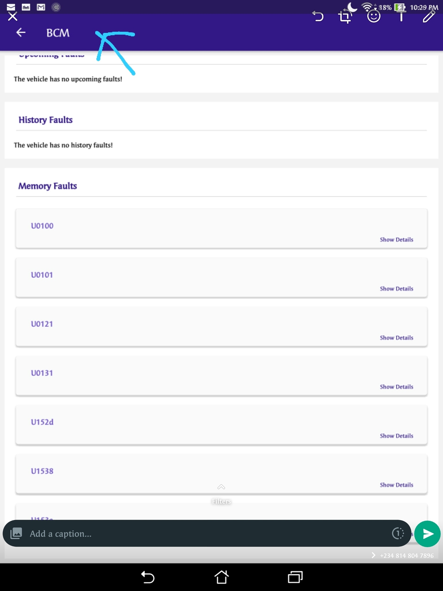

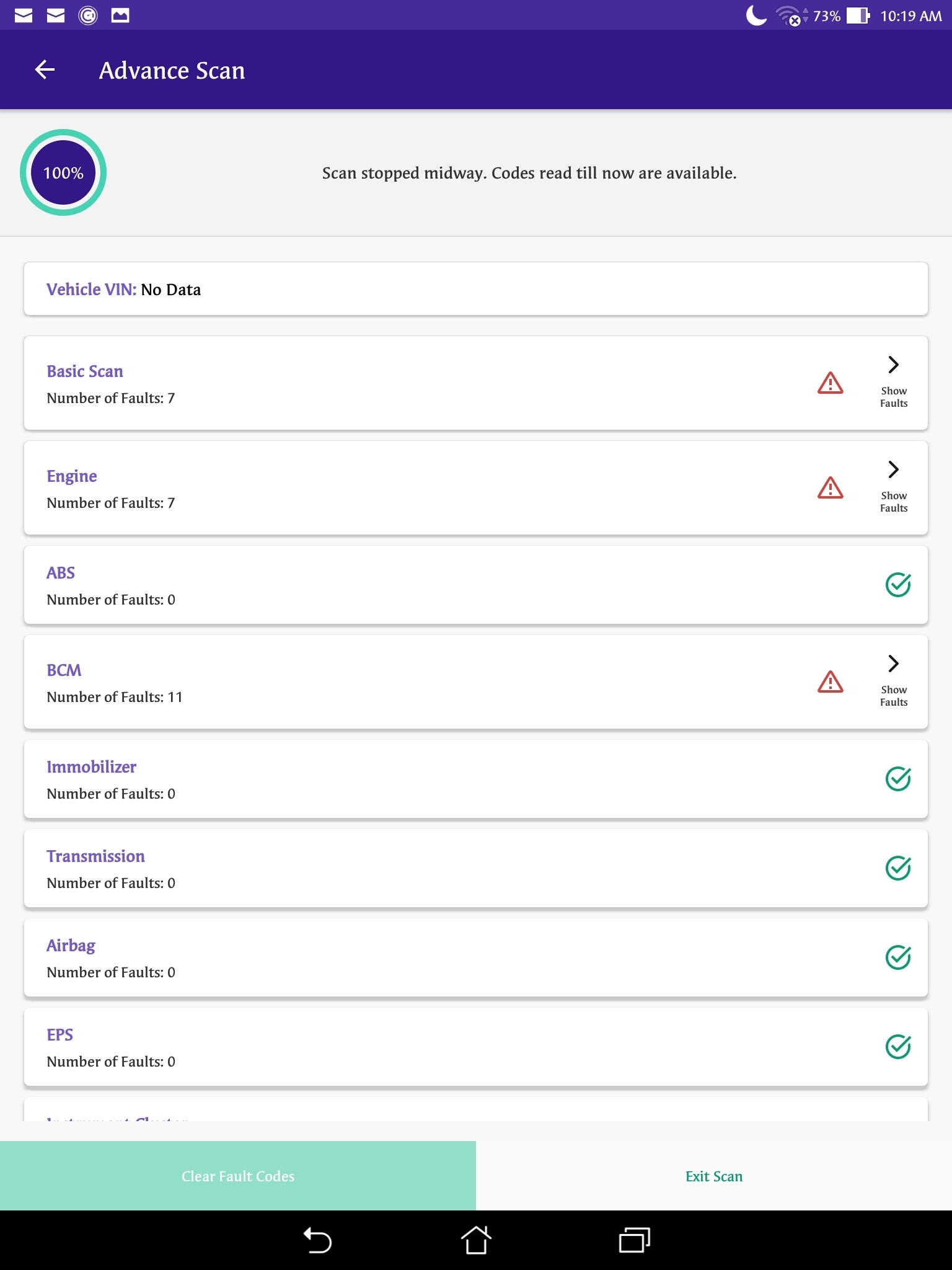

Otherwise, this code is talking about any ECU that this code is set in. Yes, look at the pictures below.
Those codes P0602, P0606, P018C, and P062F are permanently stored in the BCM memory. Even if you disconnect PCM and scan, you will still have them back, if you still plug the PCM, you will still have them. So, the best thing is to find another BCM and plug it in, if those codes disappear, then the BCM was flash or bricked.
Sunday, November 28th, 2021 AT 1:32 PM
Yep. I missed that. I apologize. If those are in the BCM then it has failed. So, if I mislead you based on the fact that I thought these were setting in the ECM.
Sunday, November 28th, 2021 AT 1:39 PM
