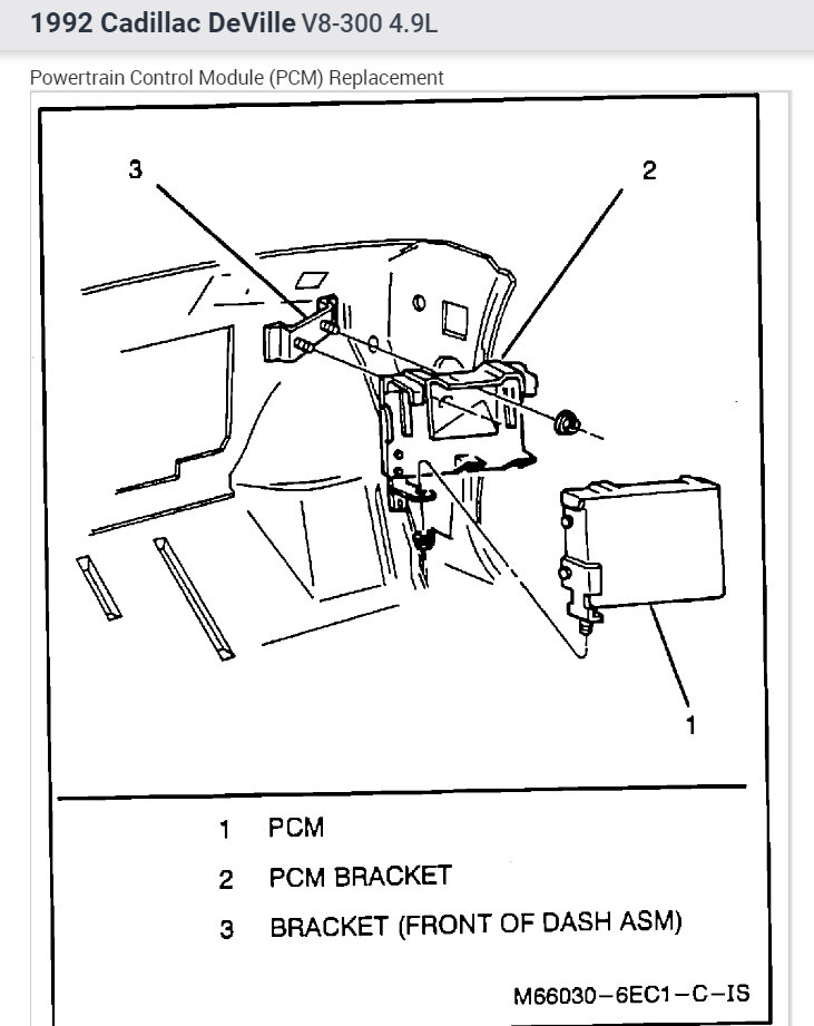

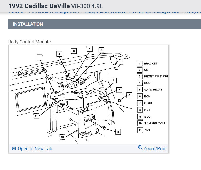

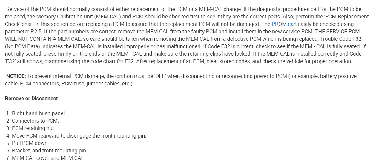

The ECM and BCM. I changed the BCM now the car shuts off while driving the service engine and service vehicle soon pop on. I pull up these codes F-F32-FF-.7'0, and E-E30- E52-EE-E30- F32. Now I'm thinking about changing the ECM, Are the ECM and the BCM the same thing? Where is the ECM location and can I get a picture of the ECM?

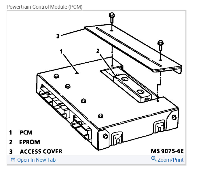

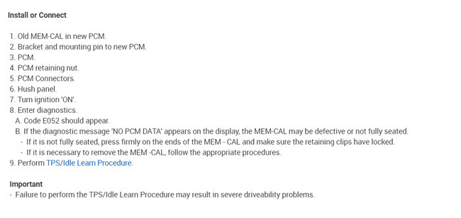

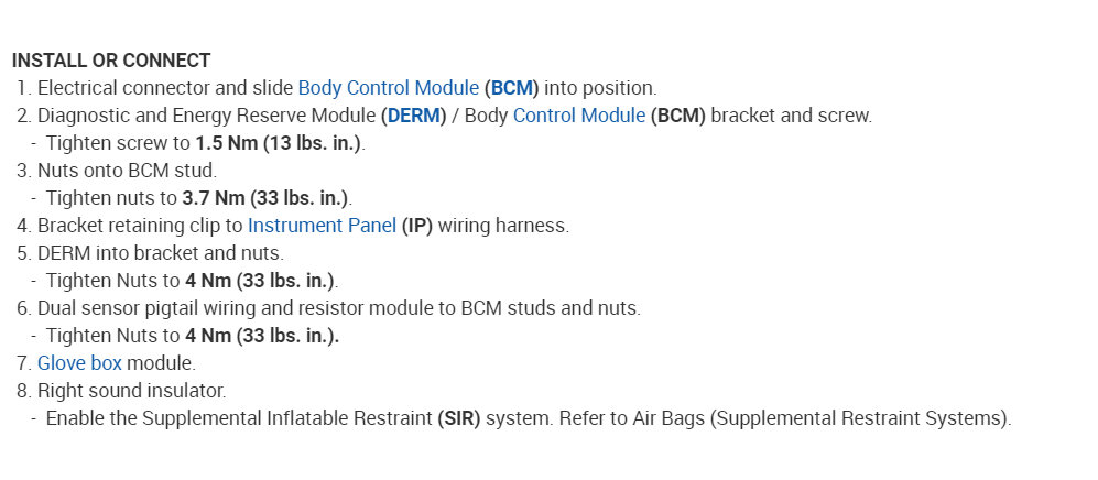

The BCM and PCM are different things but in the same location here are the instructions for changing them out. I would search google or eBay to find rebuilt units that come preprogrammed so the job will be plug and play. Check out the images (below). Please let us know if you need anything else to get the problem fixed.

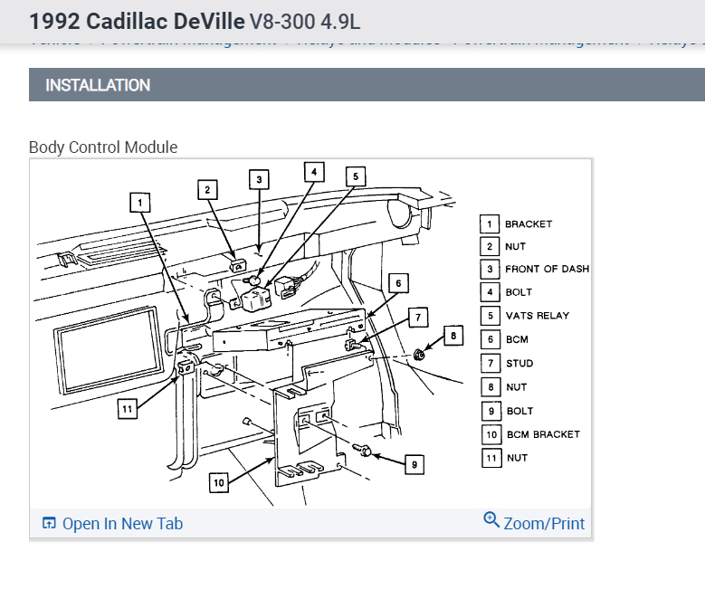

Now I am having locating the ECM it is not behind glove box, all I see is two silver module one is the BCM and the other one is the Air bag deployment control module. I removed the right side kick no ECM. I heard the ECM has red, white and blue connectors I think the ECM is silver too. I replace the BCM still get F-F32- FF-F32 service engine soon and service vehicle soon lights are on they will go out for a while they will pop back on.

When you replaced the BCM was it preprogrammed?

I got the BCM from rock auto, they stated it didn't need any programming just take the prom from the old one and put it in the new one. I found the ECM at the bottom of the A/C and heater case it set behind the A/C and heater case. Can you show me or tell me how to get to it, lot of stuff in front of it.

Okay, yep, they just show the location you need to remove anything in front of it to get it out of there. All we have is the instructions in the diagrams above but if you upload images of the problem, I can help walk you through it.
