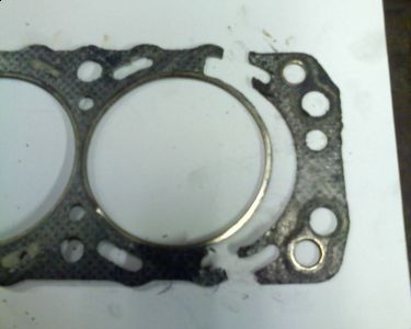

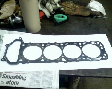

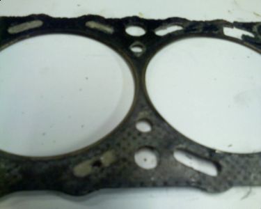

The coolant/water leaks out less than a minute after putting it in the radiator and the coolant in the reservoir remains at the same level. Is there a possibility that the engine head is cracked and if so what is the price tag to solve this problem.
Tuesday, May 25th, 2021 AT 6:07 PM (Merged)
AAP34798
  • 16 POSTS
The head gasket is probably broken around cyl 4, by the dist. and ignition coil. the coolant will be leaking out between the head and block and will start to spray the ignition coil and kill the engine(takes only 5 minutes or so during a warm up), and, you won't be able to get it going again until it dries(next day). that cyl. is the one that fails on these because the coolant is allowed to flow between the head and block, but, the others don't because of the gasket design. over time the gasket can get saturated by the coolant and it looses it's integrity, then fails.
the pics show a 2.4, 4cyl altima with this problem, however, the cyl bore was ok because of the ring aroung each one from the gasket and they kept the coolant out.
when changing the gasket . . .
