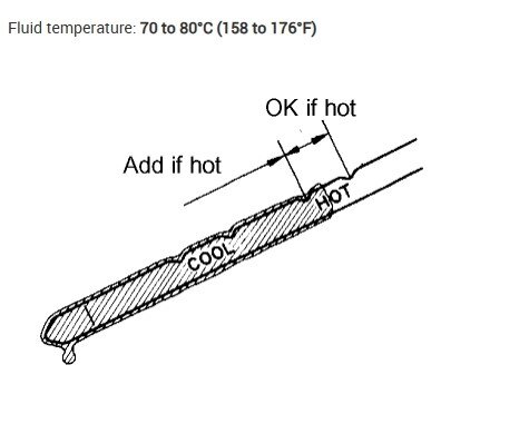

The description sounds like a combination of low fluid and internal wear. The low fluid can move around, and the filter doesn't draw in enough which aerates the fluid and with the air in the system it creates more problems. Then the vehicle has to set a while for the air to come out of the fluid. The first thing to check would be the fluid level in the transmission, if it hasn't been serviced in a while you might consider a full fluid and filter change. Another possibility is a combination of low fluid and a failed seal on the filter, so it draws in air above the fluid when it sloshes during those maneuvers. The solution would be the same, service the transmission.
This guide might help you with that:
To check the fluid level drive it some, now stop in a level spot and with your foot on the brake shift through the gears. Now with the transmission in park pull the transmission dipstick. The fluid level should be in the hot area. It should also be relatively red in color, brown or smalling burnt is a sign it needs service. I would plan on changing the fluid and filter and then see if the issue is solved.

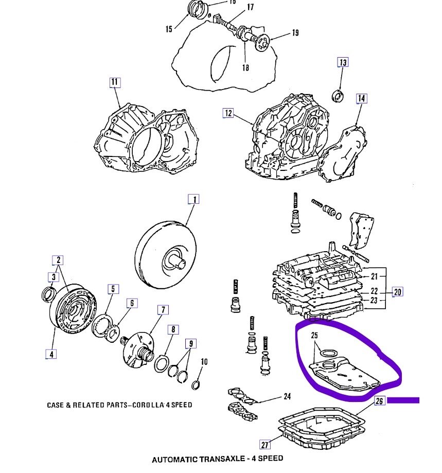

You need filter 3533012040 and about 3 liters of Toyota ATF - T-IV
plus, the pan gasket 3516812060.
The basics are in the guide above. You use the drain plug to drain out the fluid. Then remove all but 2 bolts with a drain pan under the transmission. Now remove the last two bolts and let the pan down so the rest of the fluid can drain. Now remove the filter and gasket and clean the spot the filter attaches. Replace with the new filter, wipe out the pan really well and remove the old pan gasket. Check the bolt holes in the pan to be sure the lip is flat. Install the gasket and pan and tighten the bolts to 48-inch pounds. They don't show a sequence, but a simple cross pattern should work. Now refill the transmission and check it cold with the dip stick. Now run the transmission through the gears and drive it to heat up the fluid. Check the level and add as needed. See if the problem is gone.
