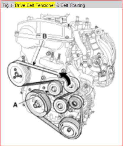

Need to replace tension-er assembly and belts. Any suggestions for easy removal and replacement?

I have attached a picture and a tutorial showing what is involved in the removal and replacement. It makes it easier if you a have a serpentine belt tool. Your local auto parts store has tool loaner programs and will rent you one. Hope this helps and feel free to ask any questions if needed. Thanks for using 2CarPros.
Danny-
https://www.2carpros.com/articles/serpentine-belt-tensioner-replacement
