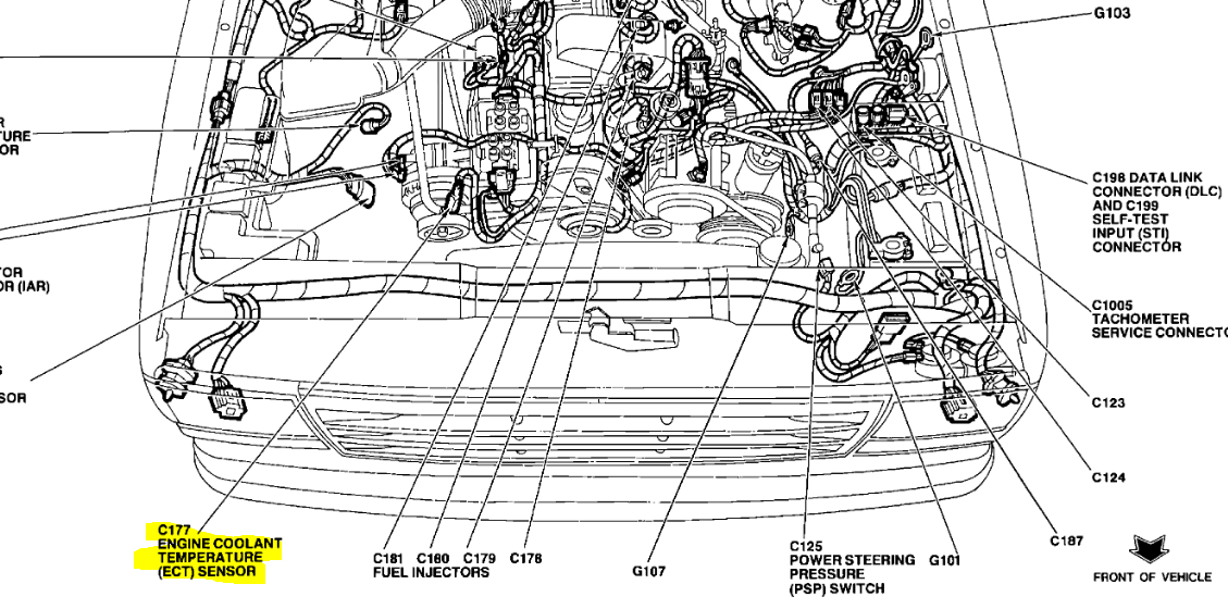

I need the location of the coolant temperature sensor. Can you please give some pics so I can find it?

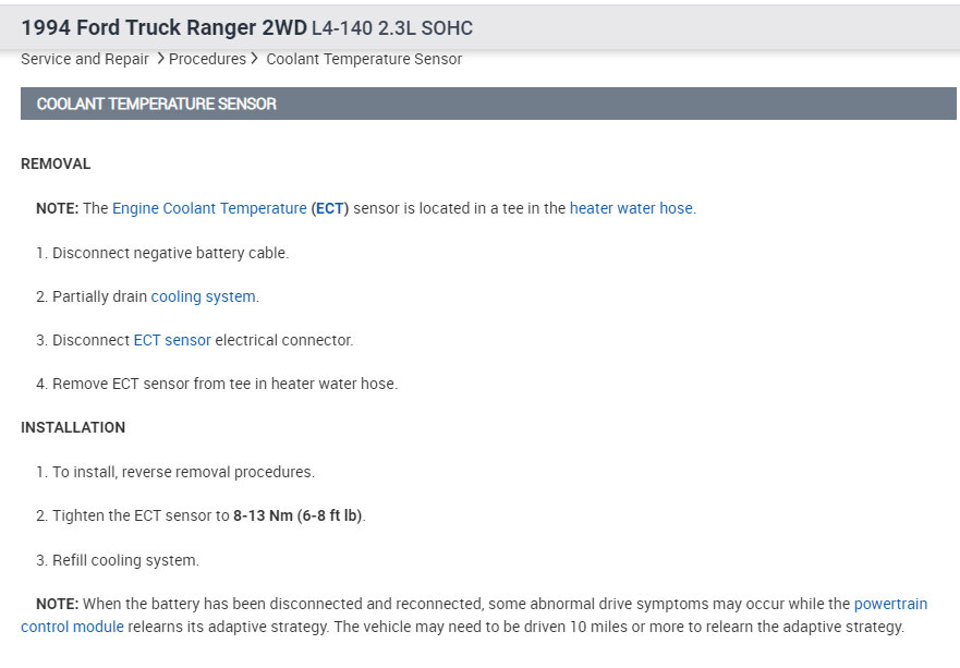

The Engine Coolant Temperature (ECT) Sensor is located at the top RH front of the engine, on the coolant line.
Take a look at pic 1 below. Pic 2 is the directions for the removal and replacement of the sensor.
