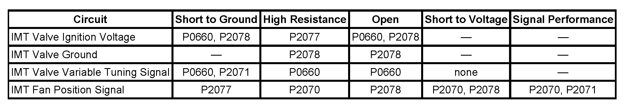

First, the codes are all related. I suspect the tuning valve needs replaced. However, we need to confirm it first.
The P0660 relates to the intake manifold tuning valve. An intake manifold tuning (IMT) valve is used to change the intake manifold plenum configuration. When the IMT valve is open, the intake manifold is configured to one large plenum. When the IMT valve is closed, the intake manifold is configured to 2 smaller plenums. The IMT valve improves engine performance at low and high engine speeds depending on the engine load.
As far as the P2070, it indicates the control module detects that the IMT valve is stuck open and the P2078 indicates high voltage to the control valve.
Both of these codes indicate to perform the diagnostics for code P0660 first before continuing. I suspect the tuning valve has shorted and needs replaced, but the test will confirm.
Here is everything related to that code. The two attached pics correlate with this information.

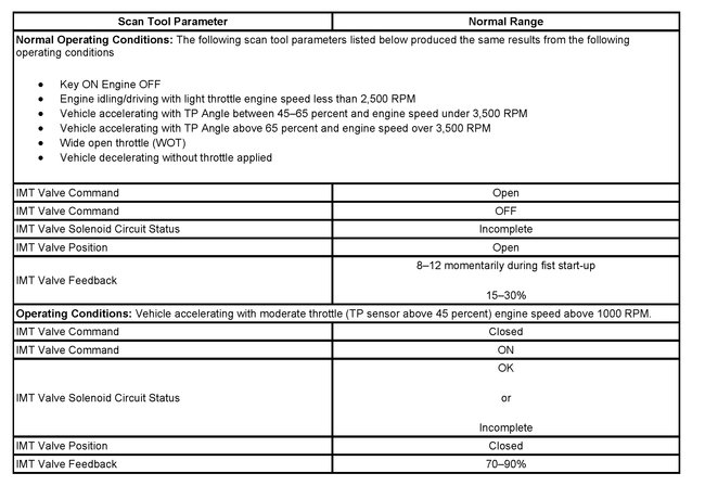

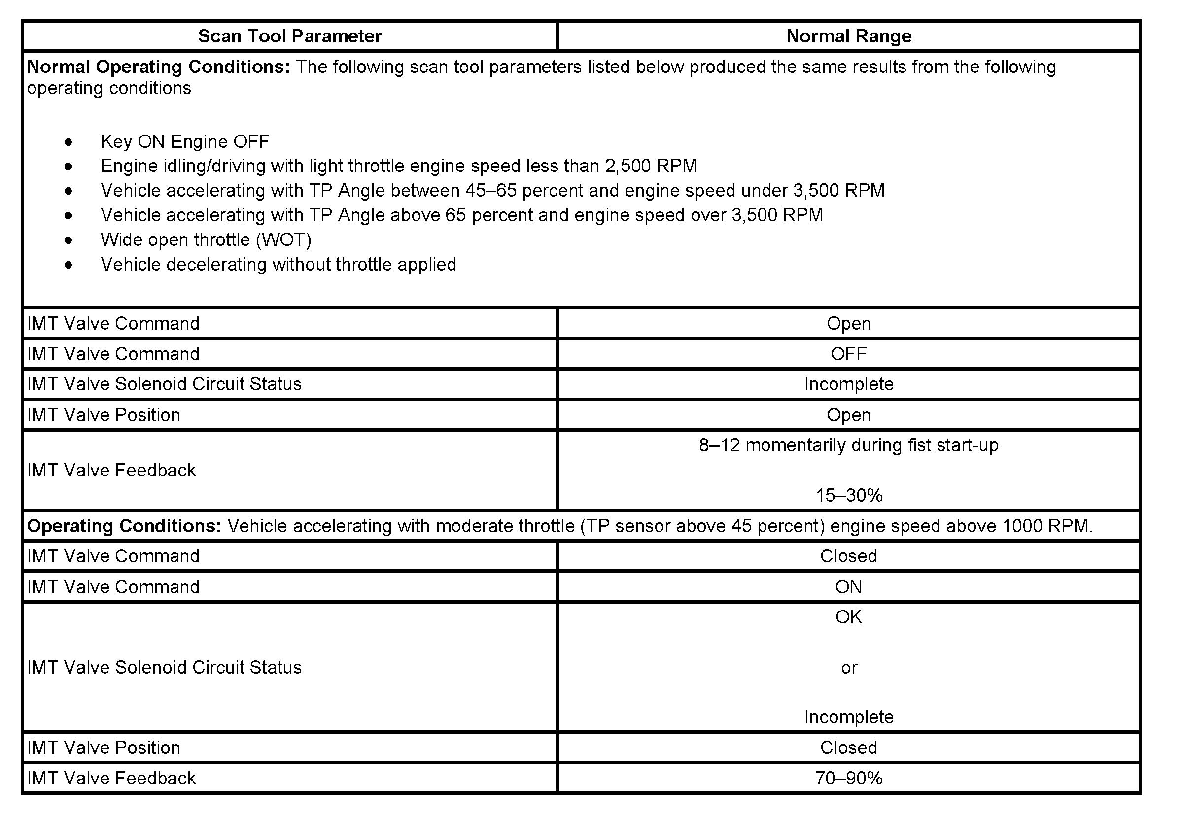

TYPICAL SCAN TOOL DATA
pic 2

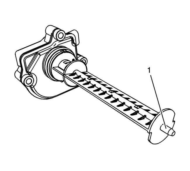

An intake manifold tuning (IMT) valve is used to change the intake manifold plenum configuration. When the IMT valve is open, the intake manifold is configured to one large plenum. When the IMT valve is closed, the intake manifold is configured to 2 smaller plenums. The IMT valve improves engine performance at low and high engine speeds depending on the engine load. The IMT valve assembly consists of the following:
- A tuning valve
- A microprocessor
- An electric motor
- A hall-effect sensor
- An ignition voltage circuit
- A ground circuit
- A variable tuning signal circuit
- An IMT fan position signal circuit

Command the IMT valve ON. The IMT Valve Command parameter should transition from open to closed and the IMT Valve Feedback parameter should transition from 15-30 percent to 70-90 percent.
CIRCUIT/SYSTEM TESTING
1. Ignition ON, measure for battery voltage between the IMT valve ignition voltage circuit and ground. Battery voltage should be measured.
- If less than battery voltage test the ignition voltage circuit for an open, high resistance or short to ground, if shorted to ground replace the fuse that supplies the voltage.
2. Connect a test lamp between the IMT valve ignition voltage circuit and ground circuit at the IMT valve harness connector. The test lamp should illuminate.
- If The test lamp does not illuminate, test the ground circuit for an open or high resistance.
3. Ignition ON, disconnect the IMT valve harness connector and measure for 0.5 volt on the variable tuning signal circuit and ground.
- If less than 0.5 volt test the variable tuning signal circuit for an open or high resistance, short to ground, or a faulty control module.
- If more than 0.5 volt test the variable tuning signal circuit for a short to voltage or a faulty control module.
4. Measure for 5.0 volts on the IMT fan position signal circuit at the IMT valve harness connector.
- If more than 5 volts, test the IMT fan position signal circuit for a short to voltage.
- If less than 5 volts, test the IMT fan position signal circuit for an open, high resistance, or short to ground.
- If all circuits test OK, replace the IMT valve.

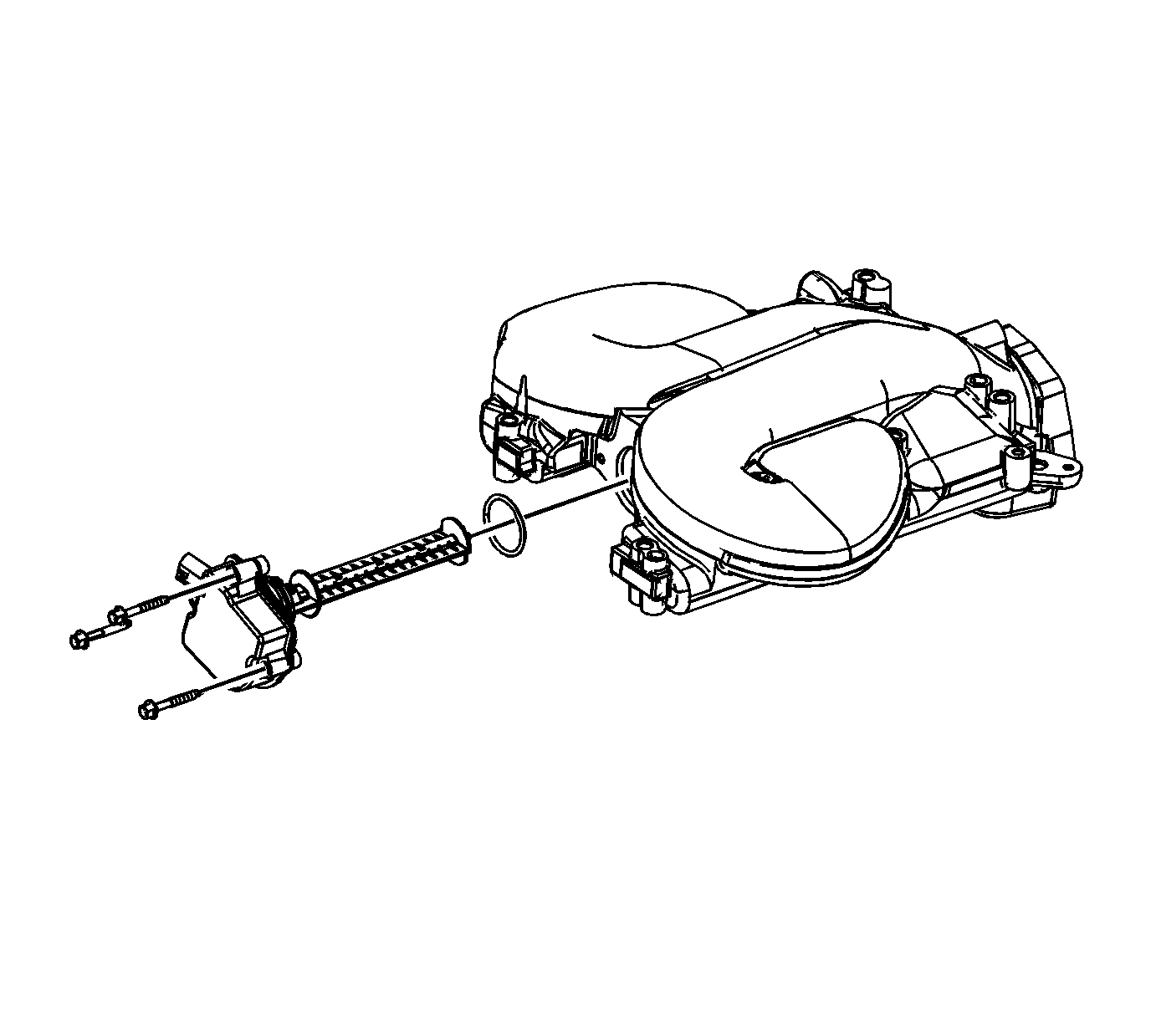

If you determine it needs replaced, here are the directions.
_________________________________________
2006 Pontiac G6 V6-3.9L VIN 1
Intake Manifold Tuning Valve Replacement

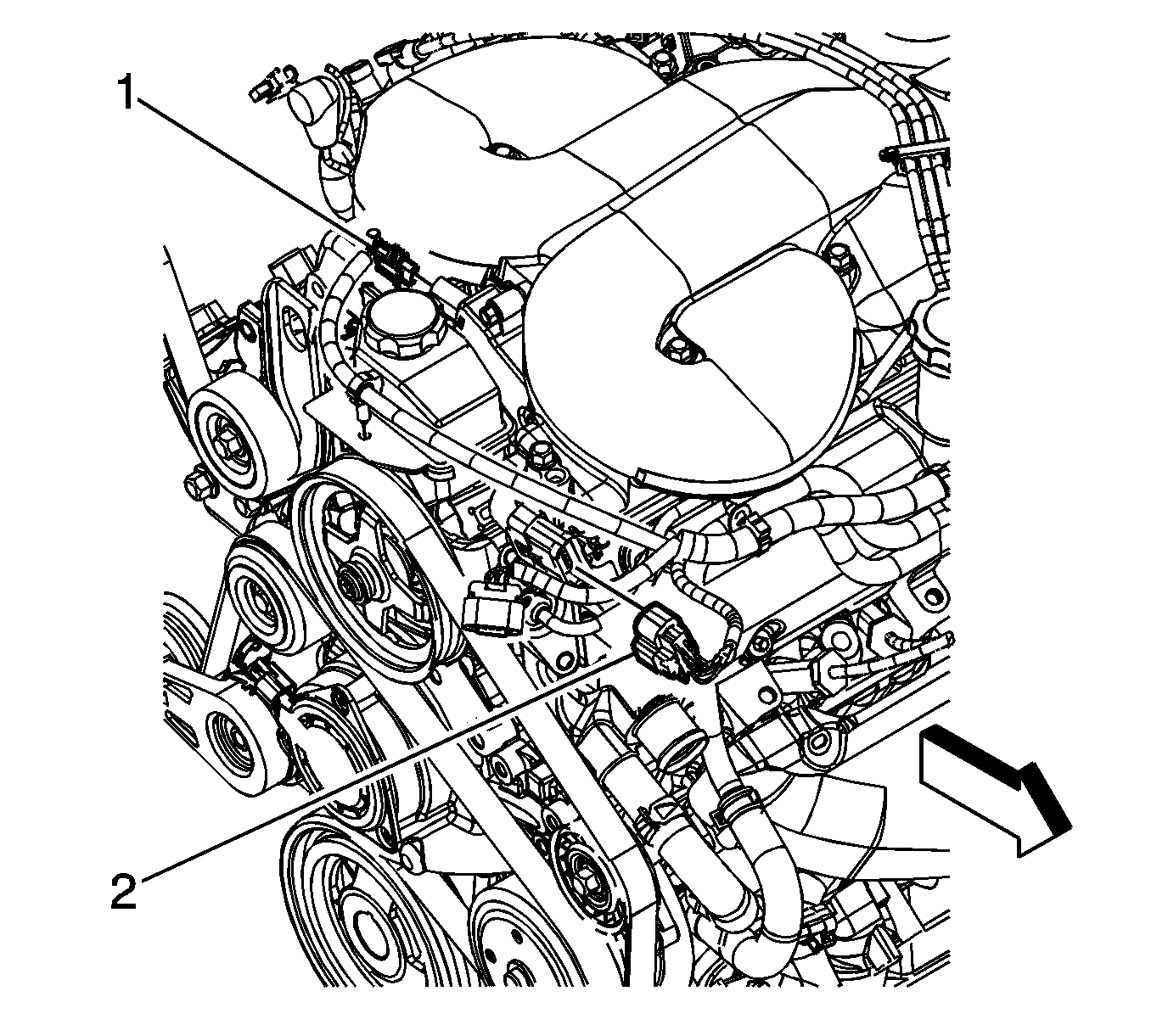

REMOVAL PROCEDURE
pic 3
1. Remove the intake manifold cover.
2. Disconnect the intake manifold tuning valve electrical connector (1).
3. Remove the engine harness clip from the power steering reservoir bracket.
4. Remove the power steering pump.
Pic 4
5. Remove the intake manifold tuning valve bolts.
6. Remove the intake manifold tuning valve.
