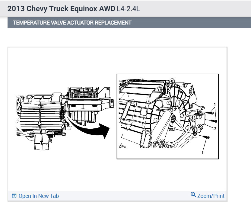

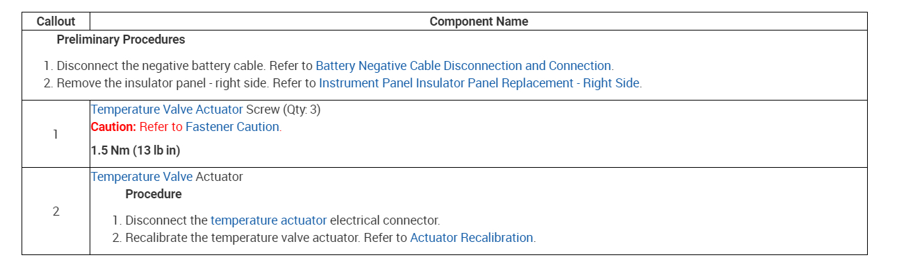

It sounds like the potentiometer inside the temperature control blend door actuator is not working correctly. We could do a CAN scan to see if anything comes up. You can get a CAN scanner (Controller Area Network) from Amazon here is a video to show you how. Also, you can try to recalibrate the system as well.
https://youtu.be/u-4syLc-ifQ
and
Here is the location of the temperature control blend door actuator in case you need to replace it. Check out the images (below). Please let us know what happens.

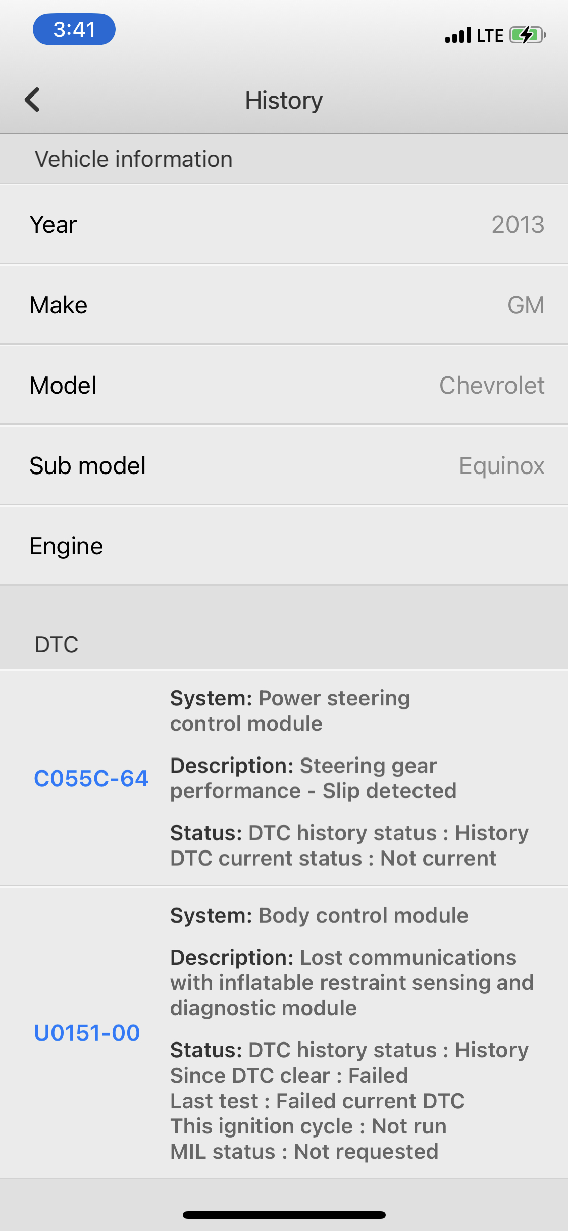

Hey Ken, I picked up an Autel AP200 and didn’t get any codes for the HVAC. Should I move on to doing the manual recalibration or do you think it’s something else?

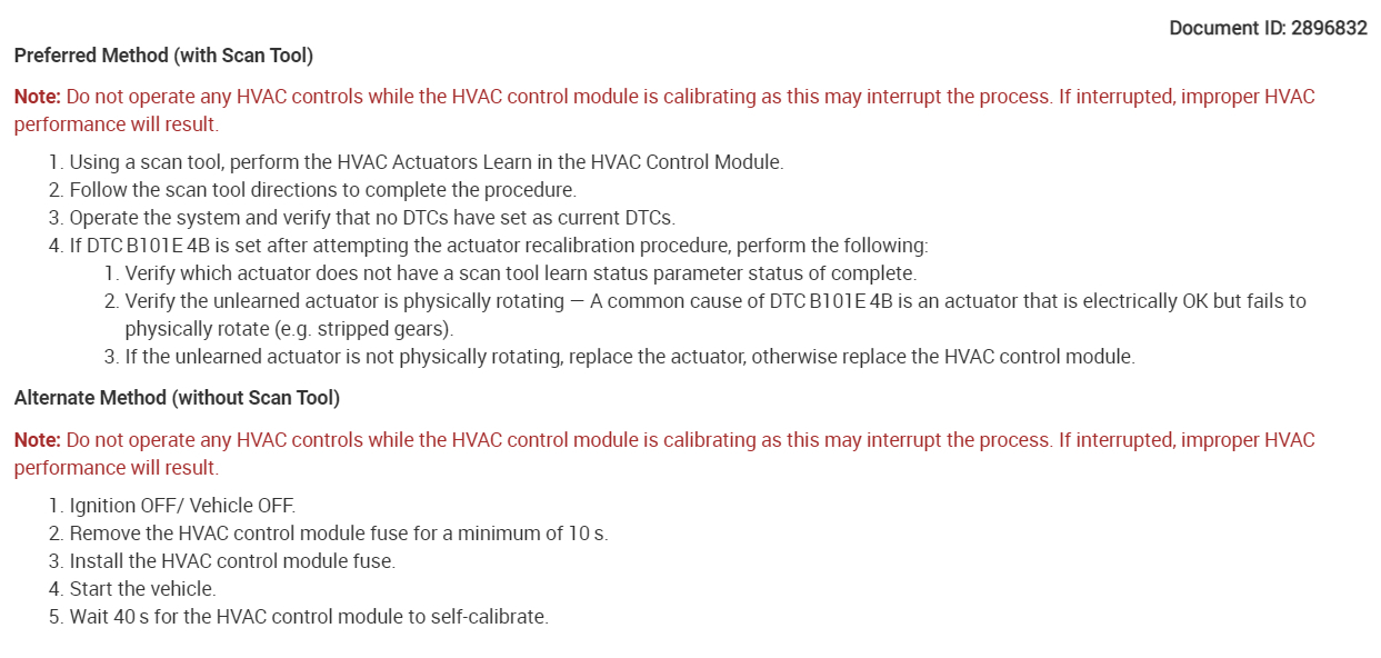

Okay, yep let's do a manual HVAC system reset. Please let me know what happens.
Sunday, March 12th, 2023 AT 6:53 PM
THINK FAR
  • 6 POSTS
So, I did the manual recalibration procedure and that appears to have corrected the problem the air feels like it is actually being blended rather than freezing or scalding. I also compared the live data on the AP200 (commanded counts matched position counts). The temperature door count was swinging from mid 50s at 70 degrees temp setting to 200 counts (max hot) when temperature was changed to 71. After the recalibration it goes from 82 counts to 129 counts.
On another note, I highly recommend this scanner. It is very powerful and only cost me about $54.00. Which brings me to a new question. Do you have any concerns with the power steering DTC? I couldn’t find any useful info on that code by searching the web.
