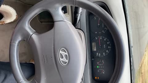

This warning light is accompanied by a shaky steering wheel at low speeds. I am not sure if these are related. The TCS and ABS warning light has been coming on and off for probably over a year now, is it a faulty sensor or something likely wrong? Is the shaky wheel connected to this light coming off and on or an unrelated issue? Is the shaky wheel a safety issue? I have been driving with it just fine for a little while. Thanks for your help! Just trying to figure out if I should get this fixed but trying to save money on an old car that's already had some decent repairs.

Also, about 2 weeks ago I had a front brake job done including new pads and rotors, but the shaking is still there. Does that help narrow down what might be causing that? It’s really only noticeable when I’m driving through my neighborhood at low speeds, I’ll let go of the steering wheel and it shakes back and forth. Thanks for your help.

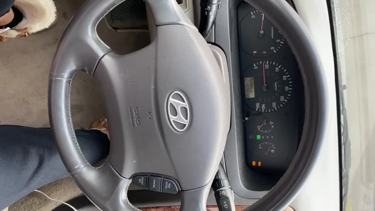

Today I actually did feel something when I braked, it was like the brake pedal hit the floor/scraped the bottom. The pedal shook and made a sound, and immediately the TCS/ABS light came back on. Not sure what that is? Brakes work fine otherwise and as I said before I just got the front brakes replaced. This has happened before the brake job was done.
This video is the best I could do to capture the shaking. It’s hard to tell.
Wednesday, January 3rd, 2024 AT 6:39 PM

What you felt sounds like the ABS system was actuated. That will make a noise and cause what you felt.
What we need to do is to either check each wheel speed sensor as mentioned above or have the can-bus scanned. CAN stands for controller area network.
