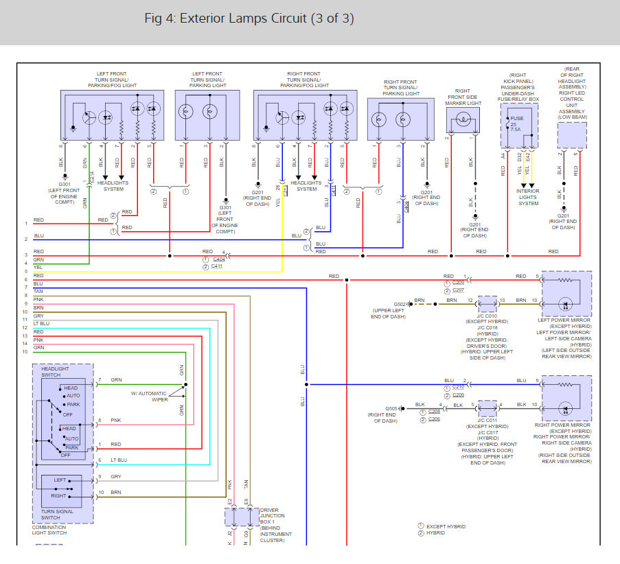

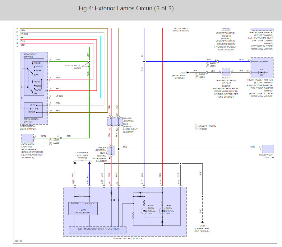

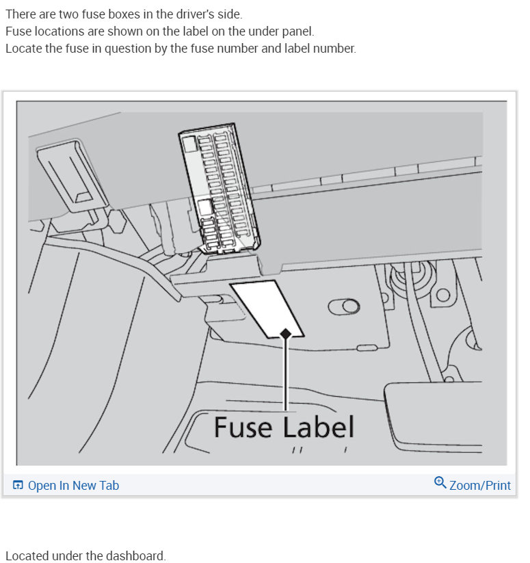

Tail light is not working and audio button that has the navi/phone/info/audio button is not illuminating. Any help in diagnosing the fuse please?

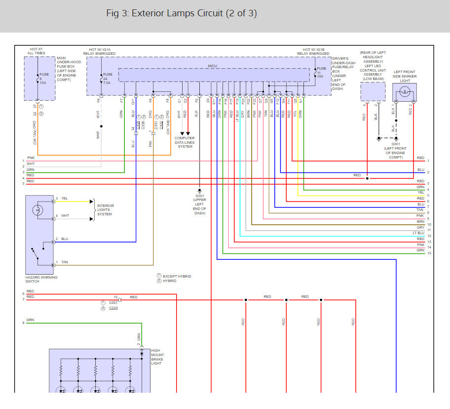

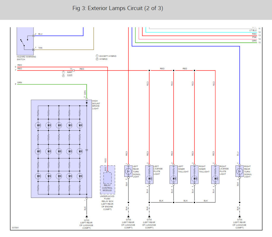

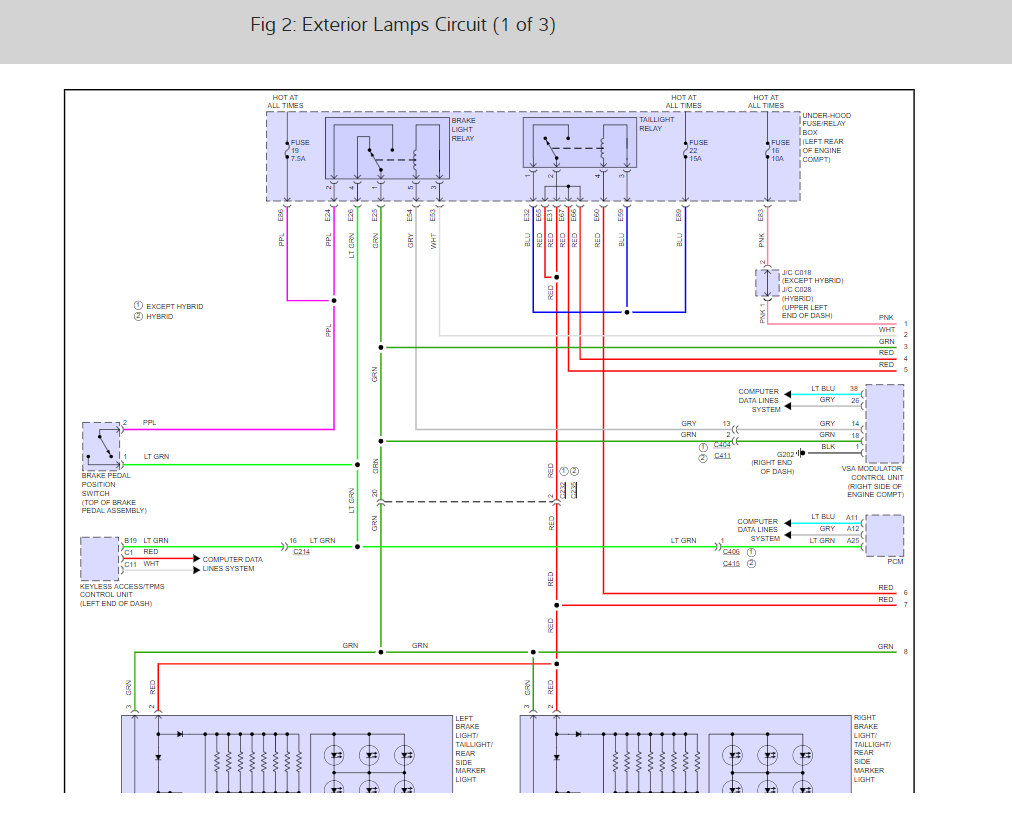

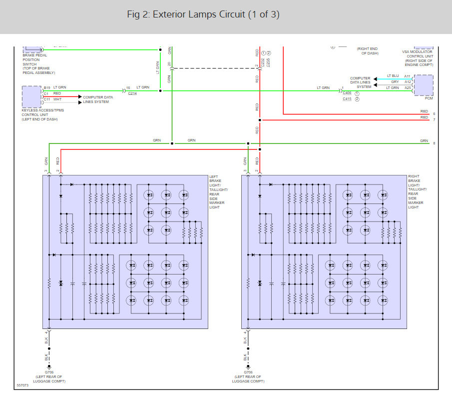

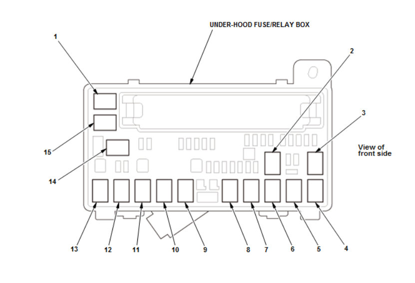

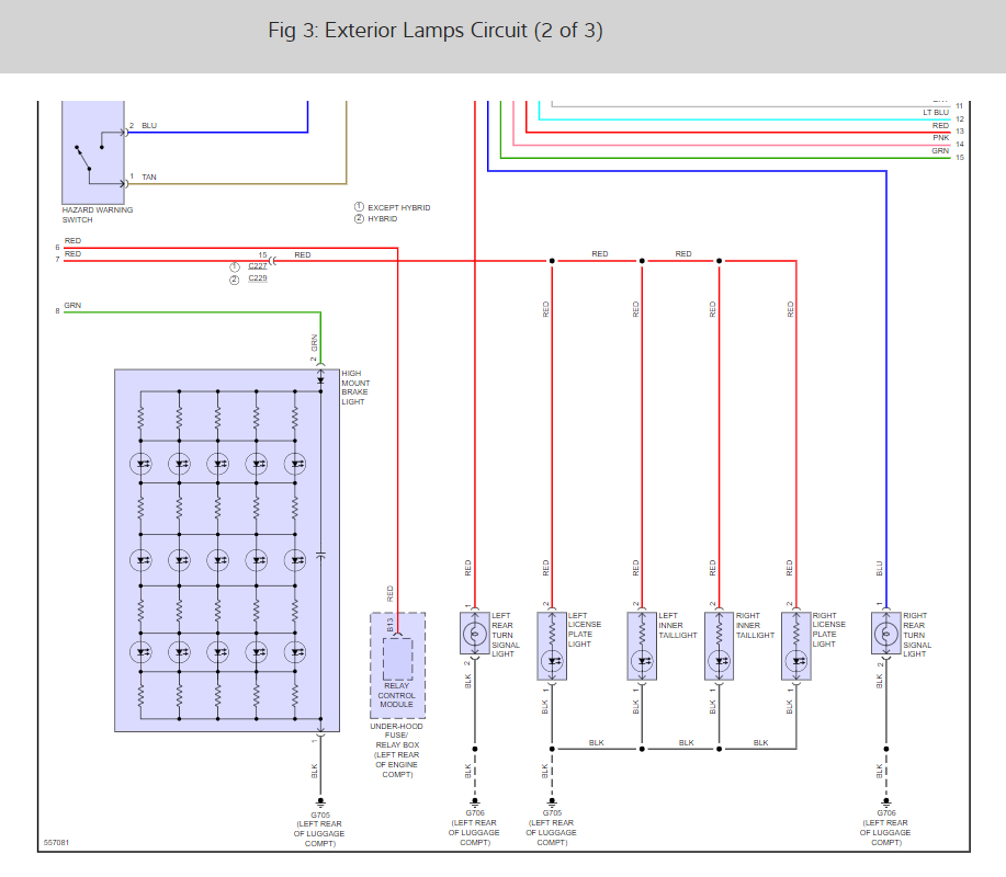

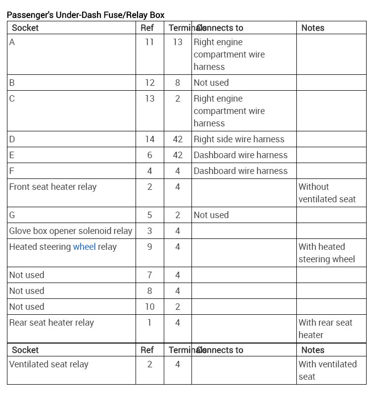

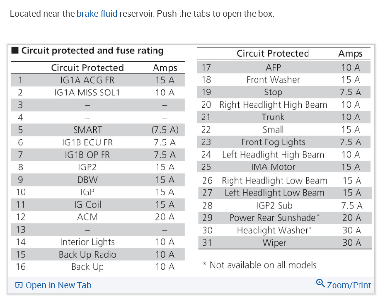

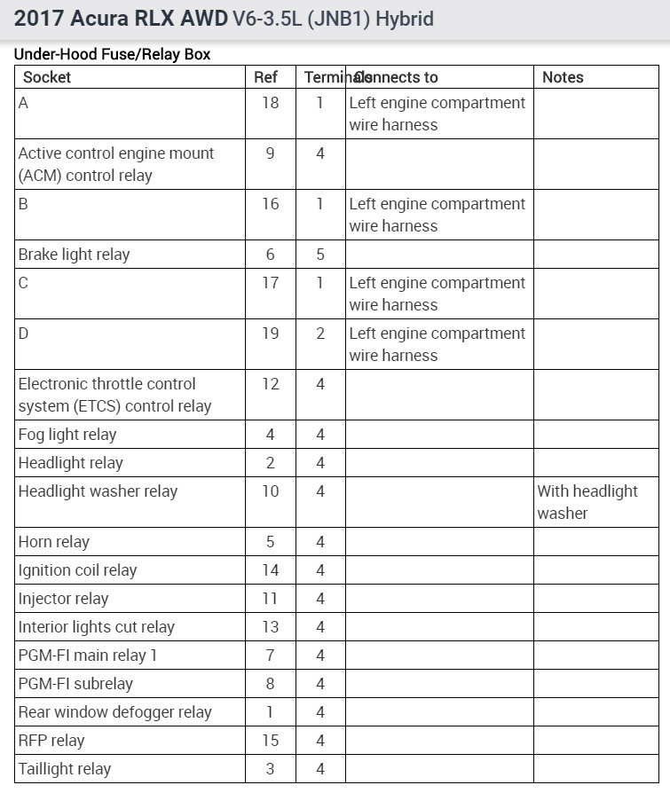

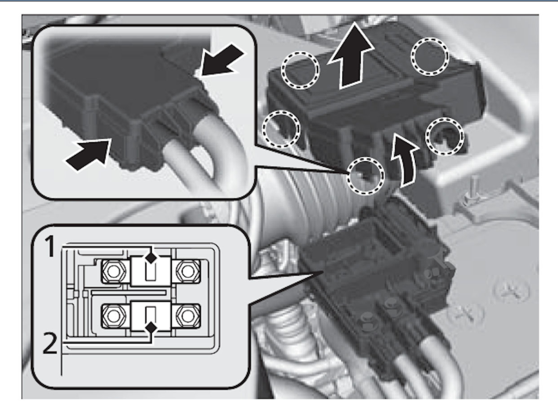

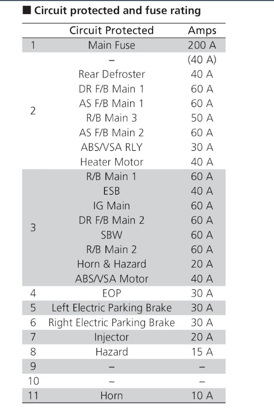

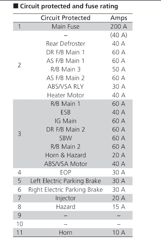

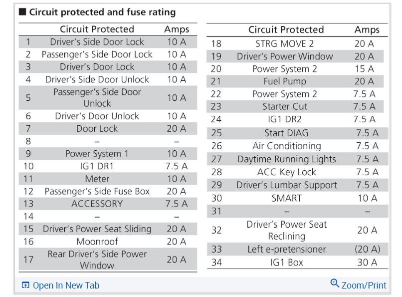

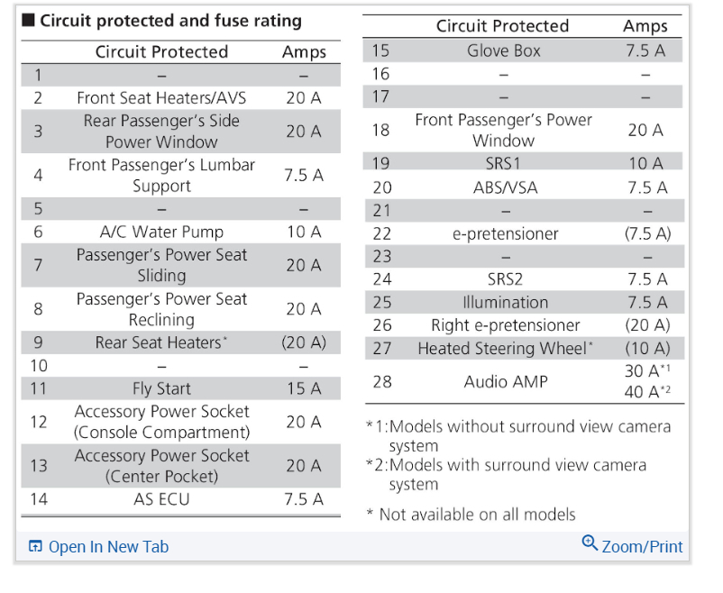

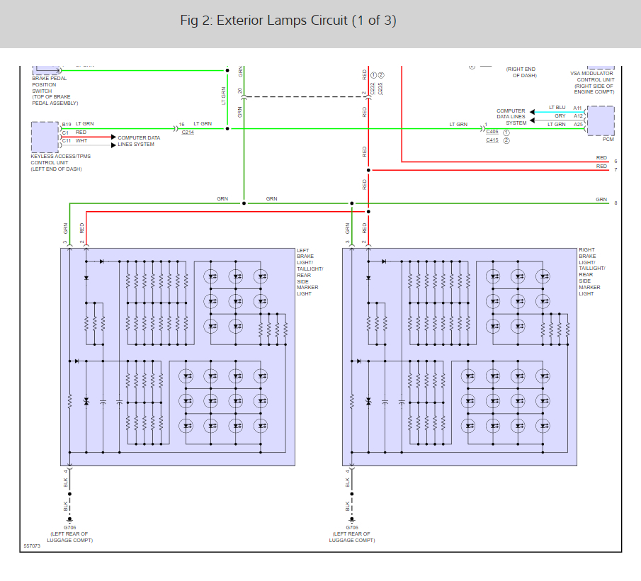

It sounds like the tail light relay or number a22 fuse is out but to be sure lets run these tests on the fuse and relay. Here is the wiring diagrams for the tail lights so you can see how the system works with the relay and fuse location:
and

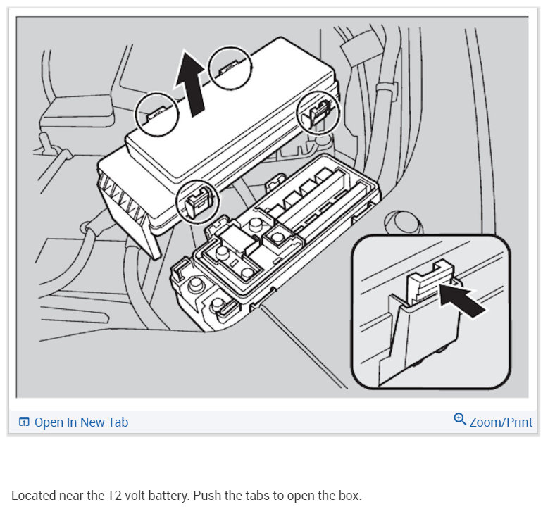

Check out the diagrams (below). Please let us know what you find. We are interested to see what it is. The fuse panel is in the left rear of the engine compartment.
Friday, February 8th, 2019 AT 1:51 PM

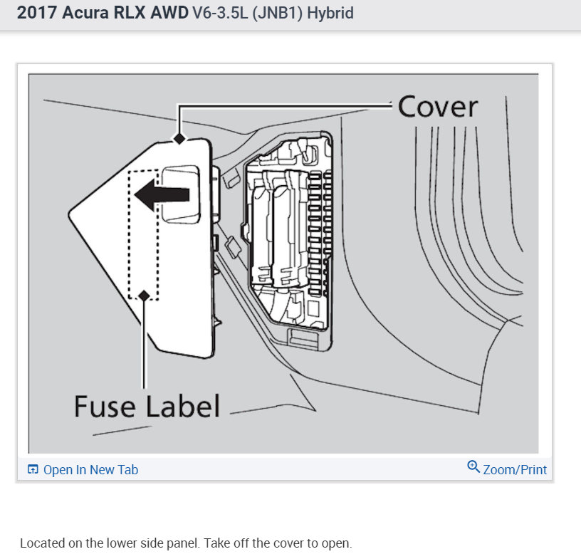

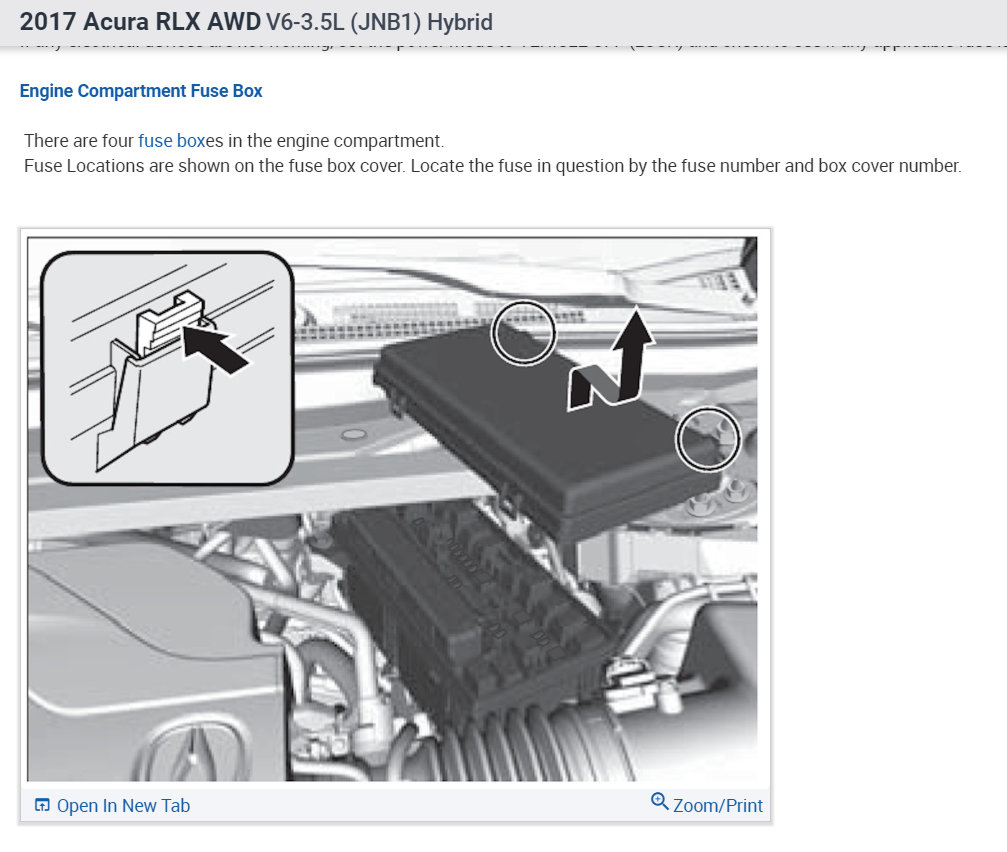

Diagram you sent is for 2017 Acura RDX, are they similar. They are total of four fuse boxes, which one does this corresponds to, and what should I look for?

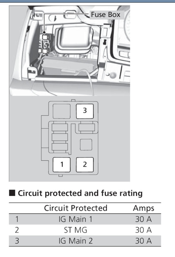

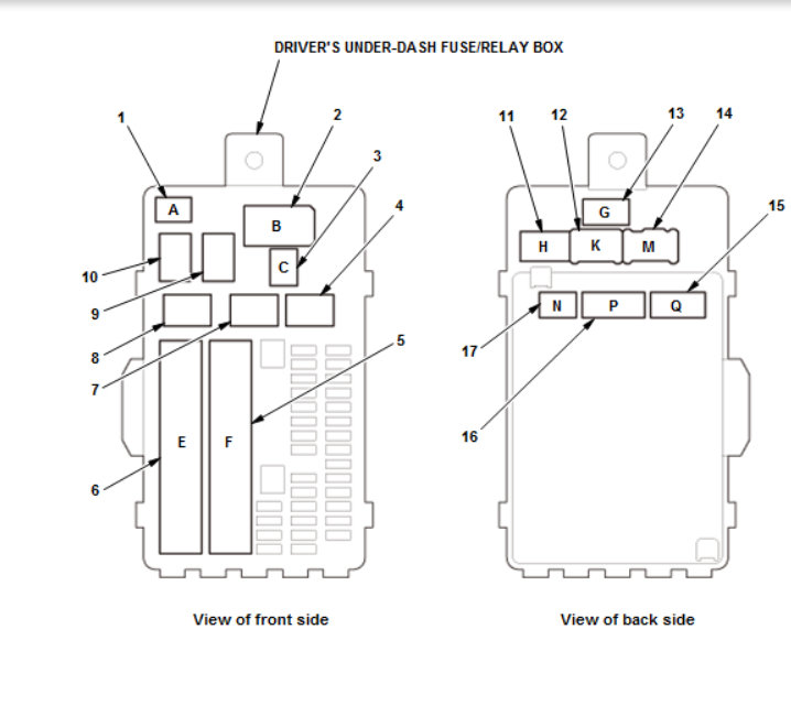

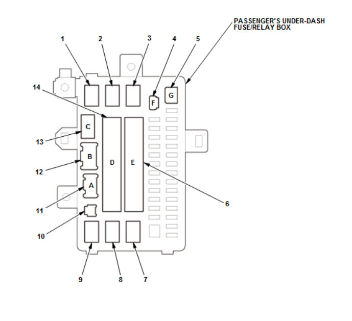

My bad, I updated the post above to include the correct vehicle and all the relay and fuse locations so you can keep this page as a reference to any electrical problem you might be having. Check the post above for the updated information. Please let us know what you find. We are interested to see what it is.

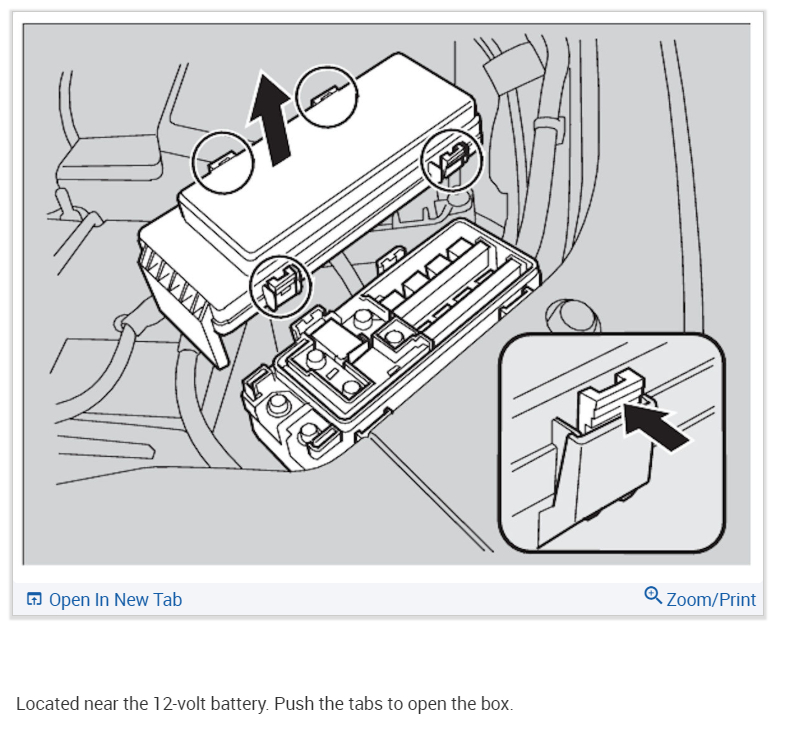

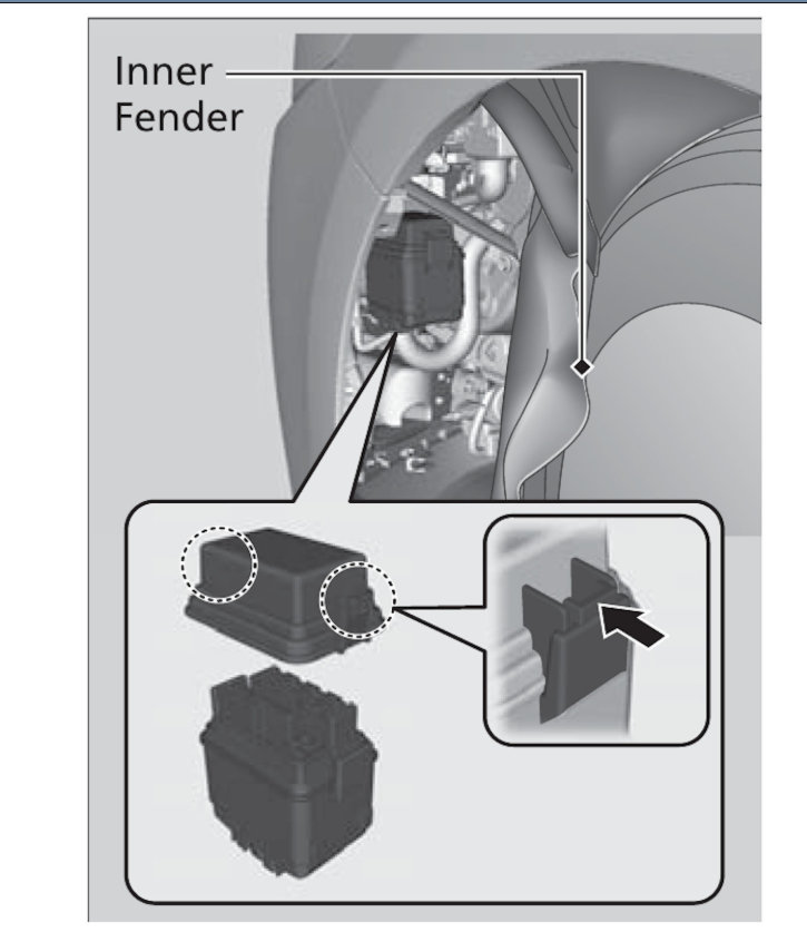

No problem. Lift the hood and you should be able to find the fuse box in the left rear of the engine compartment. If you have trouble please take pictures or video and upload them in your response. Remove the lid to expose the tail light relay. Let me know what happens.
Sunday, February 10th, 2019 AT 11:01 AM
FJKHAN24
  • 9 POSTS

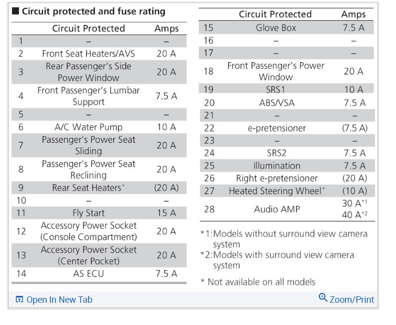

Done that, what number is the relay?
Sunday, February 10th, 2019 AT 11:17 AM
FJKHAN24
  • 9 POSTS

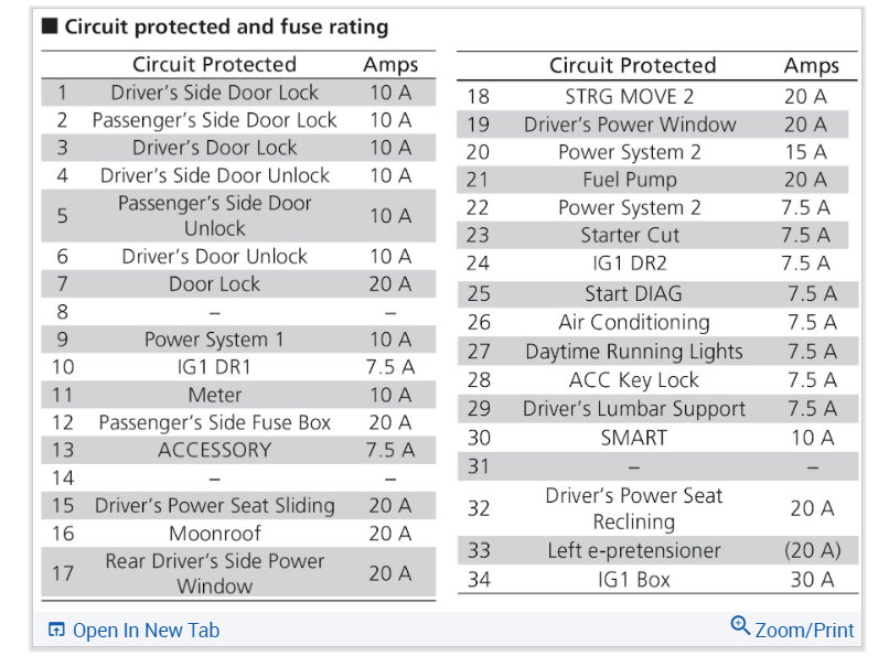

By the way, what fuse should I check also? Please state the number correlated with the fuse.
Sunday, February 10th, 2019 AT 11:19 AM
FJKHAN24
  • 9 POSTS
Got it, it was the #22 fuse 15 amp, which was blown. Thank you so much Ken for helping.
