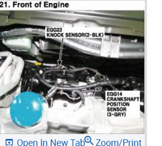

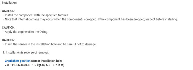

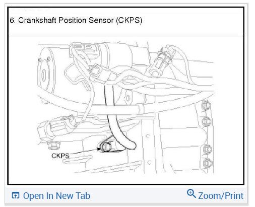

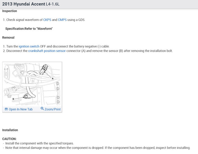

Yes, this sounds like the crankshaft angle sensor is going out. We should run the codes though. this guide can help:
Here is the location near the starter and how to change the sensor out. Check out the images (below). Please let us know what happens.

I just tried it. Idling in the garage for 15 minutes no issues. I backed out and was going to drive around the block. When I put it in drive within about 5 seconds the tach dropped to zero, felt the slight lurch. Parked it and went to restart it and got the check engine light when trying to restart. I would not start until I gave it some heavy pumps of the accelerator pedal then it started. I checked the code reader, and it said Crank Shaft Position Sensor.
Friday, July 14th, 2023 AT 10:36 AM
KEN L
  • MASTER CERTIFIED MECHANIC
  • 55,322 POSTS
Yep, it sounds like you found the problem, I would replace the crankshaft angle sensor. Please let me know how it goes.

So far so good! What a pain getting under the car though.
