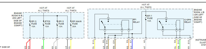

The first thing you should do is check the fuse listed below. Then turn the key on and test for power at the brown wire at any of the coils to see if there is power.
Check out the images (below). Let us know how it goes.

I check all the fuses under the hood with a multimeter I didn't find any blown, I havn't use the test light yet. Do the Ignition switch need to be on for this test? I hope to find the problem soon the car need to be in working order.

I took #1 coil out and test for spark with a spark tester the type that ground to a bolt look like a spark plug. But I didn't see no spark and when I was doing the test smoke came from the top of the coil what cause the smoke? Since then the engine want start and dies anymore how do I fix the problem? I scan the computer for engine codes and I have P0351, P0352, P0353, P0354.

These codes are for a faulty power supply for the 4 coils and since it smoked one of the coils you now need at leas that one I'd probably just get all 4 new as a set that's the starting point. Let us know when you get the coils we can help but keep in mind it might have also fried the wires inside the wiring harness but either way I'd say get some coils first and let us know. Also, I would not try starting the car any more until you get the coils out could damage the wiring if it isn't damaged already.
