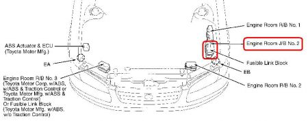

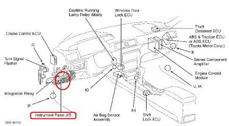

No need to pay a technician to do this. Just open the instrument panel junction box (fuse panel) under the driver side dash to look for gauge, panel, and ignition fuses. The diagram should be on the inside of the cover, and go under the hood junction box 2 (fuse panel), left side of engine compartment and look for dome fuse. One or may two of the fuses explained has/have burned out.
https://www.2carpros.com/forum/automotive_pictures/55316_98camrydash_1.jpg
https://www.2carpros.com/forum/automotive_pictures/55316_98camryunderhood_1.jpg
You don't need the entire panel, just one may be two fuses. Depending on the amperage of the fuses, you may have to replace two different sizes. You local parts store should carry a few different options for you. You will probably need one these combinations: 5A and 7.5A , 5A and 10A, 2 7.5A, or 7.5A and 10A. If you need 2 7.5A fuses, just purchase a pack of 5 7.5A for around $3. All other combination, they should have a multi-pack for about $4.

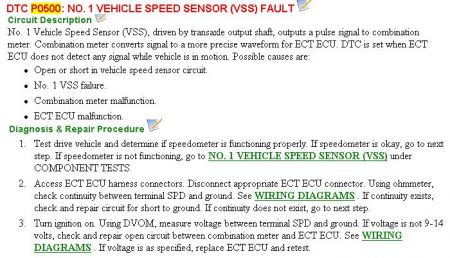

I hope you received my previous response. However as many suggested in the forums, I got the diagnostic code for the 'Check Engine Light" and it turned out to be P0500, which means a faulty speed sensor. When I explained the background to the mechanic, he told me that there should be no problem with the sensor since each time a fuse blows, it sends a signal to the computer. He told me to disconnect the battery and it should go away.
However, when I was returning back, the panel went dead again and I replaced the 10A guage fuse (all others were intact) as it had blown again.
What I am seeing is that when I started the car after replacing the fuse, there was no 'Check Engine' light anymore, but the moment I shifted the gear to 'Drive', the fuse blew off once again.
There seems to be a electrical issue and I once more need your expert advise & guidance to resolve this.
Many thanks in advance and a good weekend.
Dinkar
+1
Friday, February 13th, 2009 AT 5:46 PM
ZACKMAN
  • 4,202 POSTS

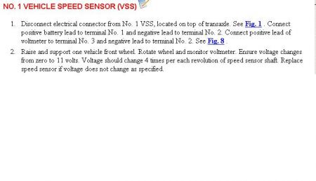

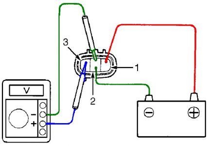

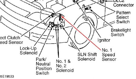

Toyota ECM uses 2-Trip Logic Diagnostic for certain check engine light codes. P0500 is one of them. In a nutshell, it means that if the ECM "sees" a code, it will store it in the DTC, but will not turn the check engine light. If it sees the code again the next cycle the car is running, then it will turn the check engine light on, providing that the ignition is turned off and then turned back on. In your case, that is why the check engine light is on the next time right after the fuse was replaced.
Your mechanic was partly correct when he said that the speed sensor sends signal to the computer. But he is incorrect when he said there was nothing wrong with the sensor each time the fuse blows.
That fuse also sends power to the speed sensor. I believe that your sensor is faulty and grounds itself once the shifter is moved to "D" thus powering the sensor.
