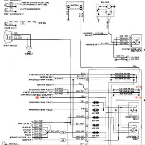

IF you want to post an email addy, I'll send a diagram. There are 3 fuseable links that I would check. I know I am not the best guy for this problem, but no one else is on-line at the moment.
https://www.2carpros.com/forum/automotive_pictures/30961_sub_1.jpg
