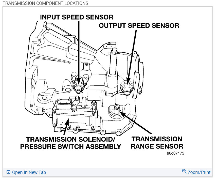

Just let you know the car did not act up for few days now also no codes p0882 p0218. The difference is the outdoor temperature on those days the temperature is about 32 at night and 60 days. What could be related to temperature?
Thursday, October 18th, 2018 AT 7:53 PM
KEN L
  • MASTER CERTIFIED MECHANIC
  • 55,350 POSTS
It sounds like the sonilond pack which has the fluid temperature sensor in it needs to be replaced. Here is a diagram of what I am talking about. Let me know what happens.
Friday, October 19th, 2018 AT 11:14 AM
JR9261018
  • 49 POSTS
I thought the temperature sensor is part of TRS. Also, when the car acting up and put it in reverse the white back up light is not on.

That could be shorted gear range sensor, let's use the wiring diagrams I gave to test through the sensor it could be causing the issue.

I measured the voltages of the TRS wires and compared to what Alldata specification.
When the car acting up or when the car is not acting up the value of the trs are:
T43T41 T3 T1
P CL CL OP CL
R CL OP OP CL
N CL CL CL CL
D OP OP CL CL
3 OP OP OP CL
1 CL OP CL CL
Alldata specification for the TRS are:
T43T41 T3 T1
P CL CL CL OP
R CL OP OP OP
N CL CL OP CL
D OP OP OP CL
3 OP OP CL OP
1 CL OP CL CL
Sunday, October 21st, 2018 AT 6:25 PM
KEN L
  • 55,350 POSTS
The top line of testing is a concern on T3 supposed to be closed and it open, looks like the sensor is bad.
