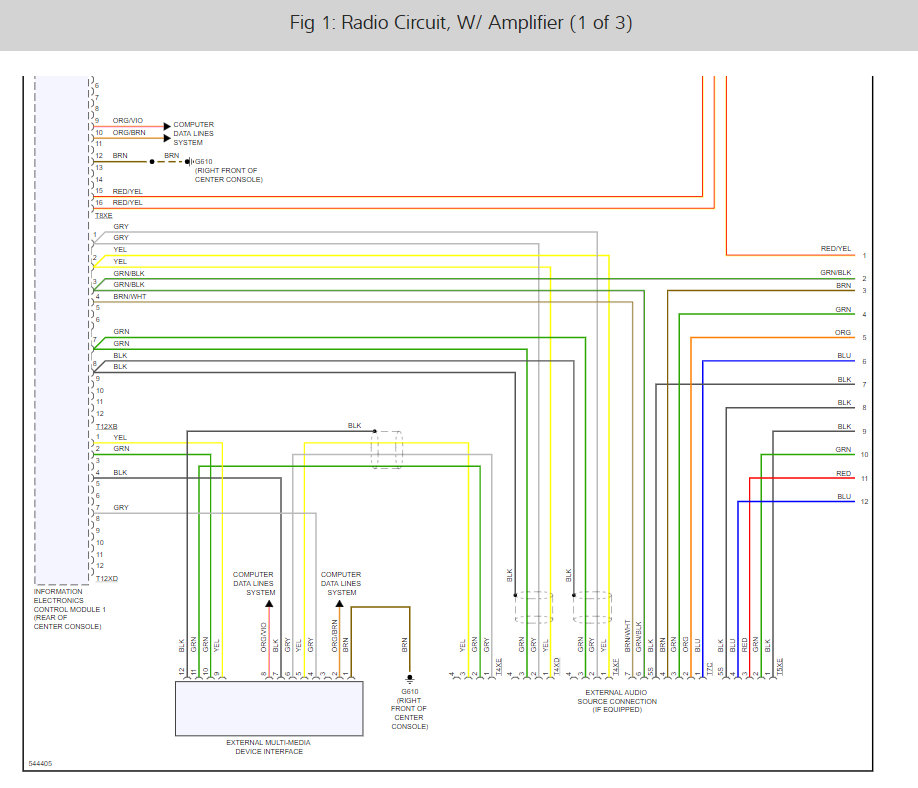

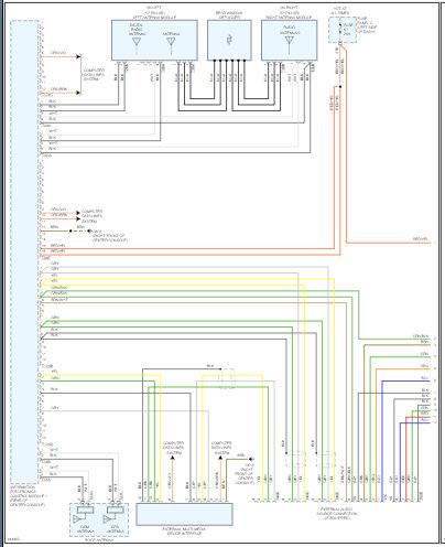

I'm trying to find the remote wire for the car listed above.

If you mean a remote control feed that turns on an amplifier or other module there isn't one. It uses the CANBUS network to interface the system with the vehicle.

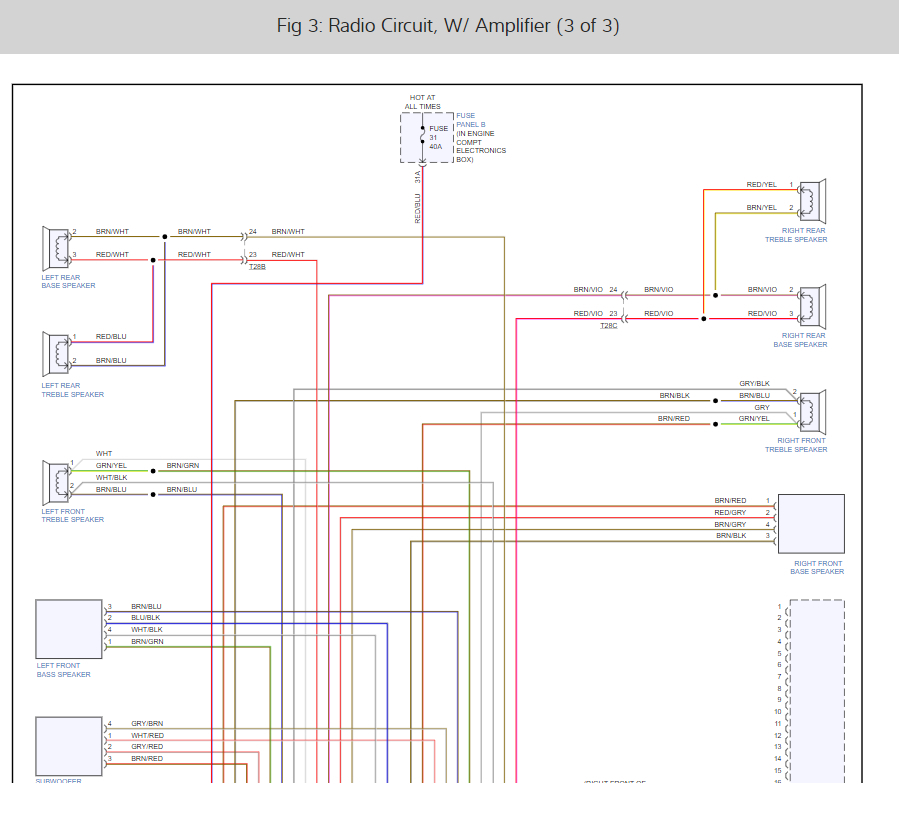

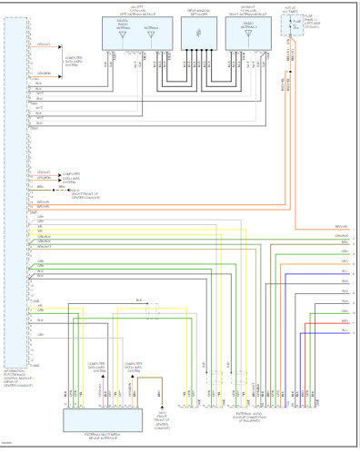

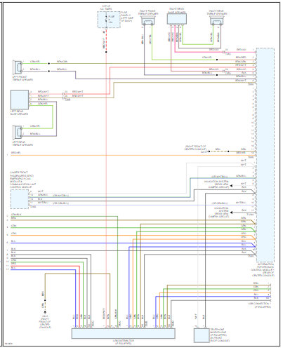

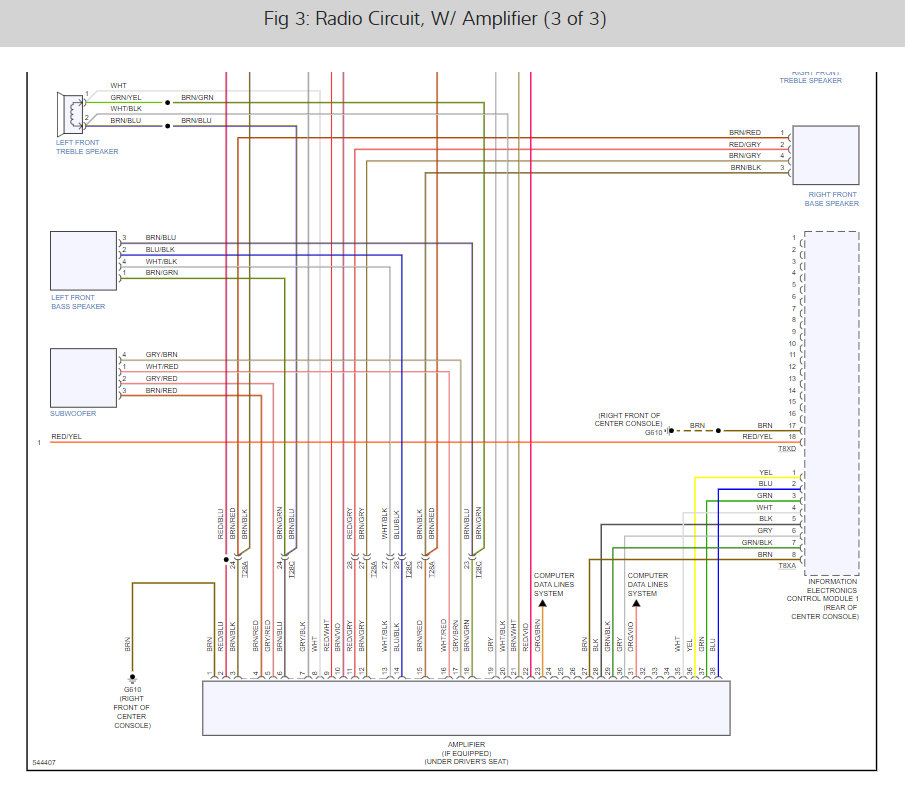

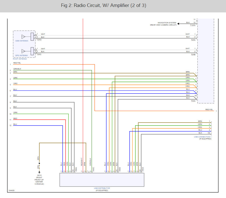

Does your car come with or without an amplifier from factory audio system? I will attach factory diagram. Usually power turn on for an amplifier is the blue wire which is amplifier turn on also power antenna. Let us know and I'll send diagram. Hope this helps and thanks for using 2CarPros.

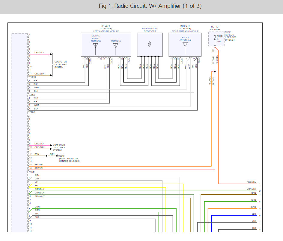

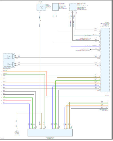

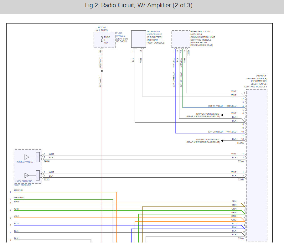

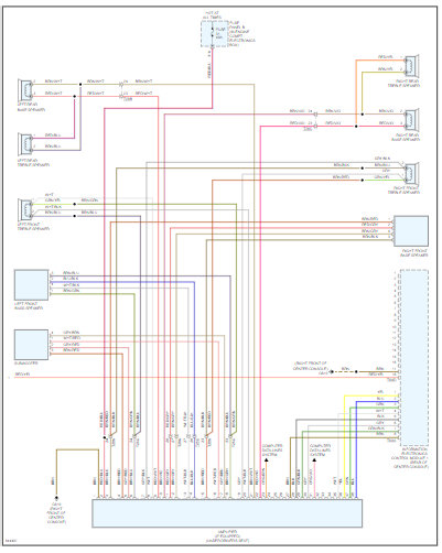

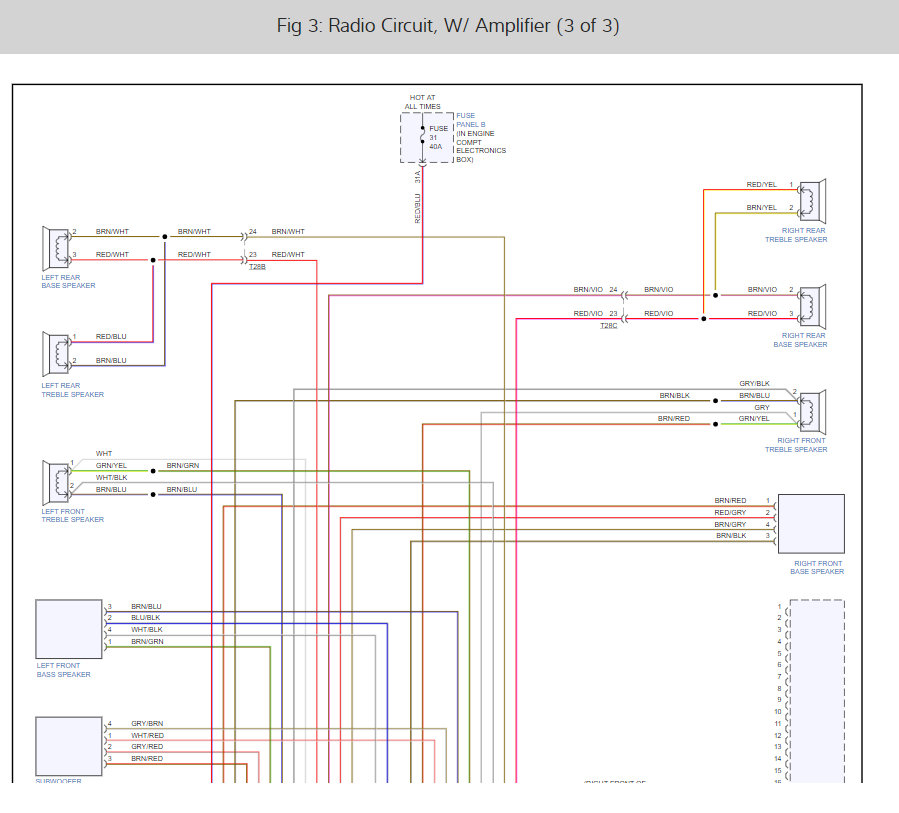

I've attached the wiring diagrams below for the audio system. The first 3 pictures are for the audio system with a factory amplifier. The other 2 pictures are for the audio system without a factory amplifier. Hope this helps and thanks again for using 2CarPros.
