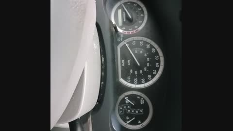

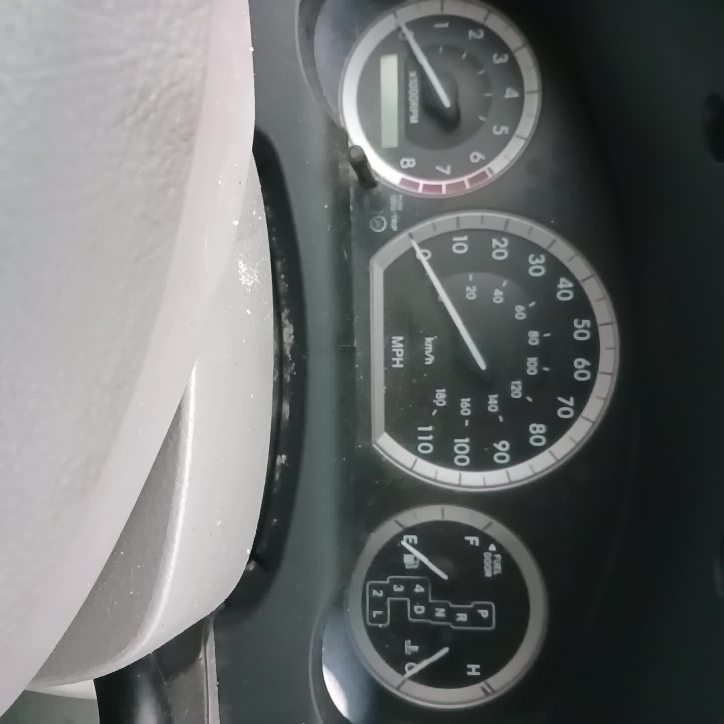

Thank you, William, for taking time to help me. I really appreciate it. I'm attaching a short video so you can see what happens at startup.

Sounds like it starts good. See if you can keep the car running by using the gas pedal. If so, at least we know the fuel pump and injectors are working properly.

I've used the gas pedal each time it turns over. I don't feel any fuel pressure at all when pressing on the pedal at that time.

Hello, judging from how strong the engine starts, I don't think there is an issue with the fuel, but there is an issue with "maintaining" the fuel pressure. Whether this is electrical or mechanical, is the question. It could be as simple as a blown fuse or a loose connection. Were you able to obtain a code reader? It would help us out a lot if the memory could be scanned for any clues.
