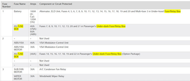

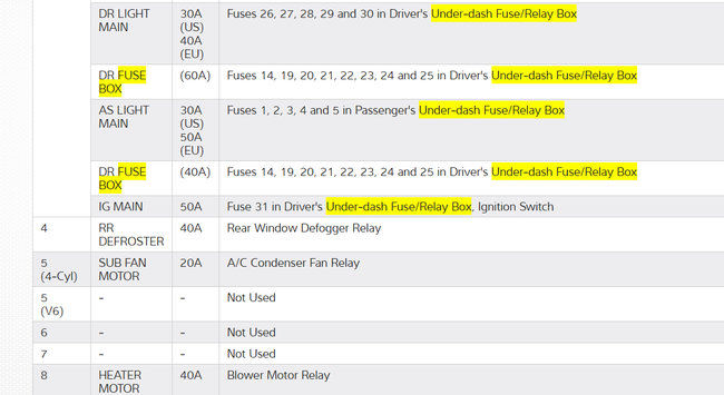

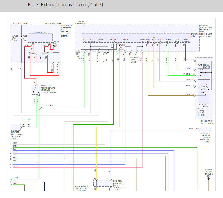

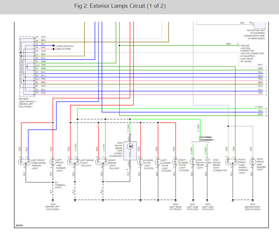

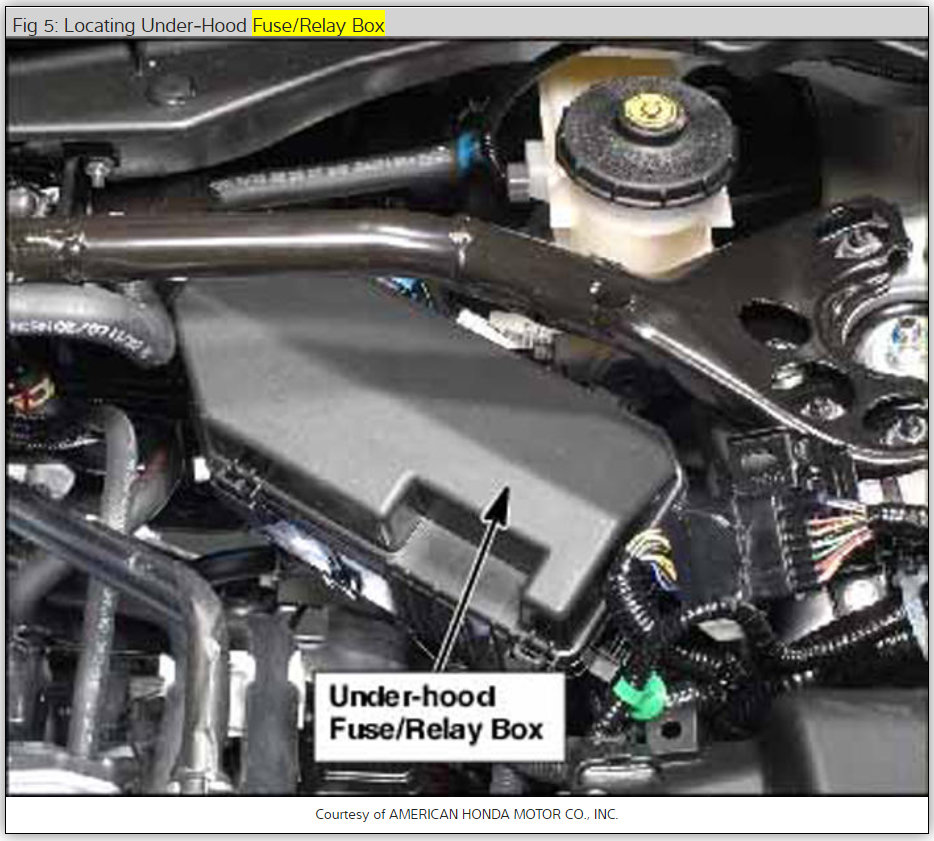

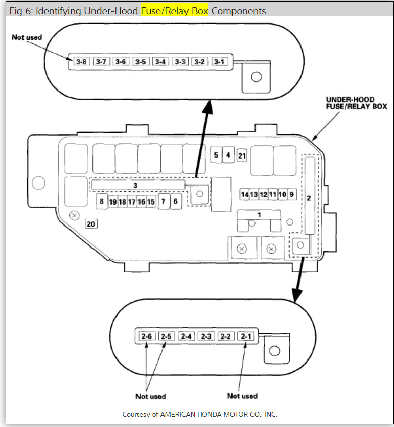

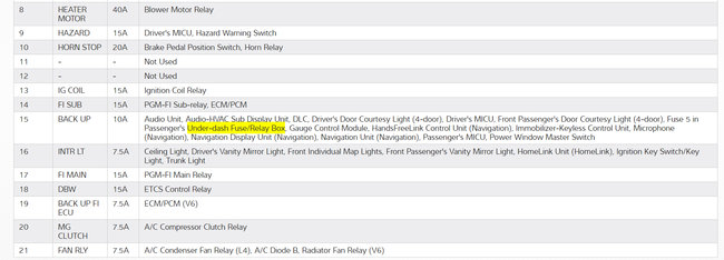

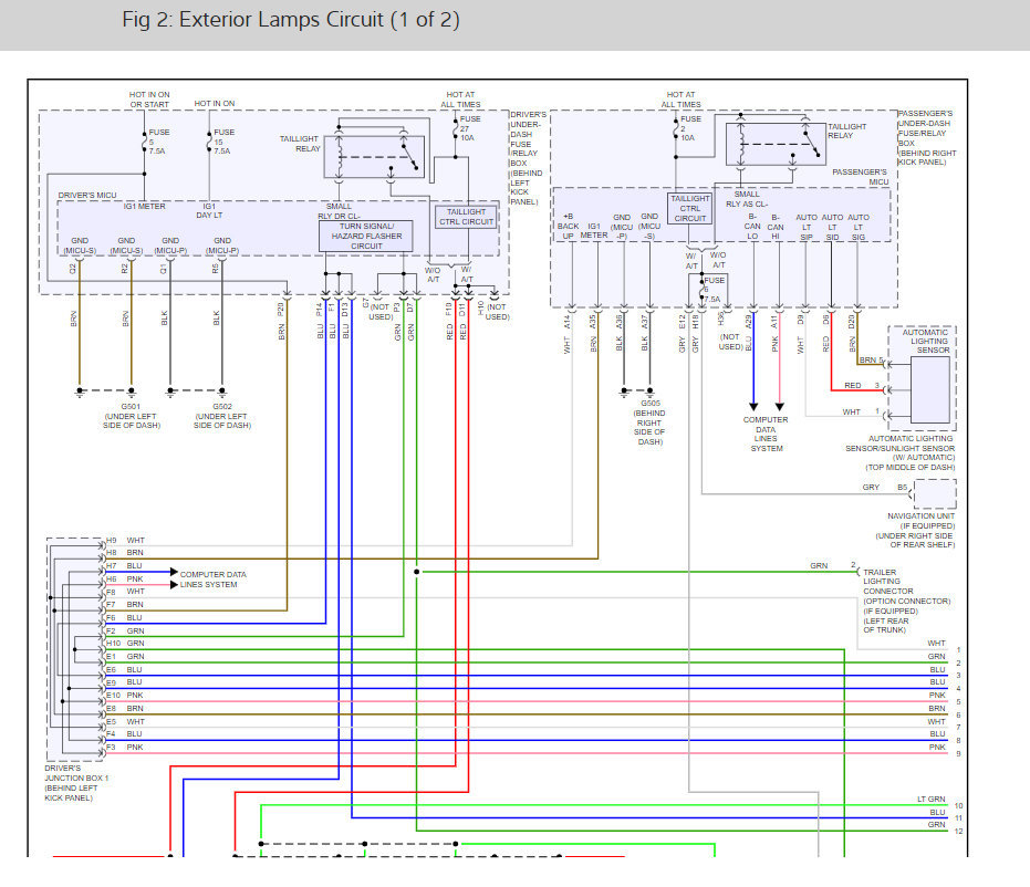

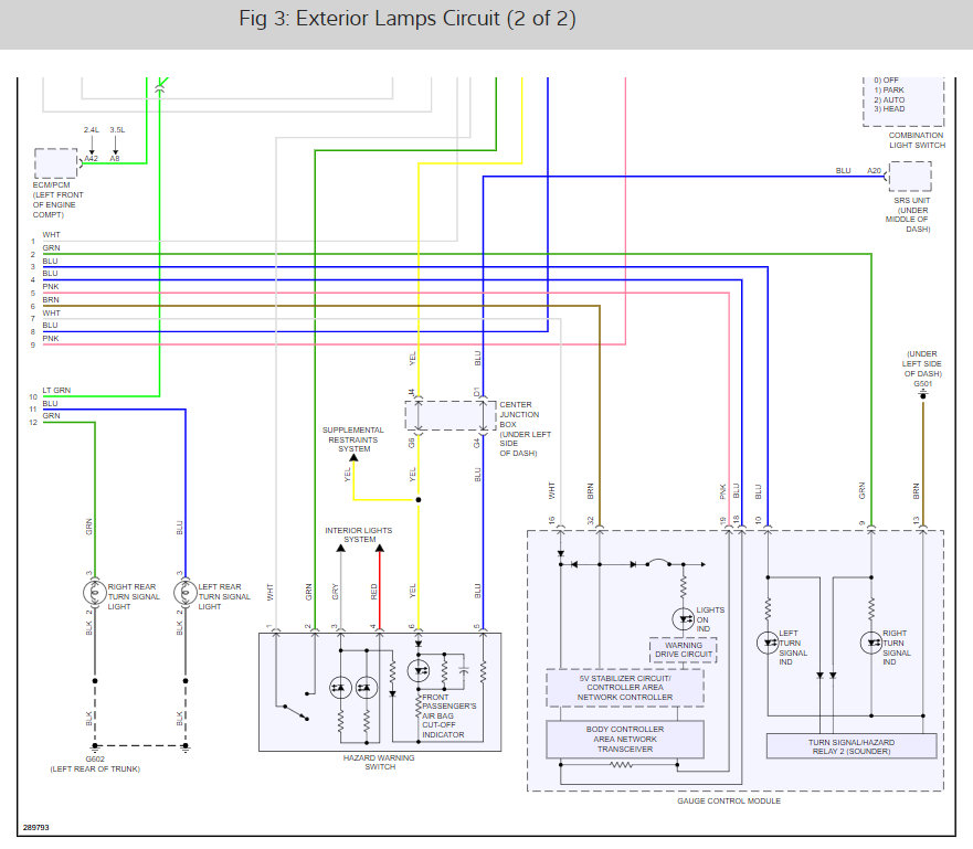

It sounds like the taillight fuse or relay when out or the drivers side ECU. here is the wiring diagrams for the blinker/running light dash lighting so you can see how the system works. Also how to check the fuse # 5 and 9 in the under hood fuse panel by using this guide:

Turns out it was the fuse for "meter" 7.5A fuse that directly communicates with the ECM. I found that out the day I posted this through another forum about Honda Civics. Thank you for your reply.

Hmm, meter is Honda speak for gauges. Sounds like the LED's may have shorted the feedback to the dash that tells it if you have a blown bulb. Glad you found it was just the fuse. I know of someone who converted their entire car over to OEM type LED's and it fried most of the body control module and the wiring got crispy as well. They were not happy.
