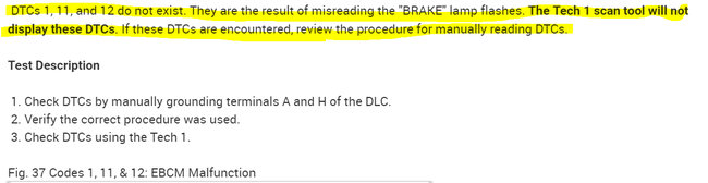

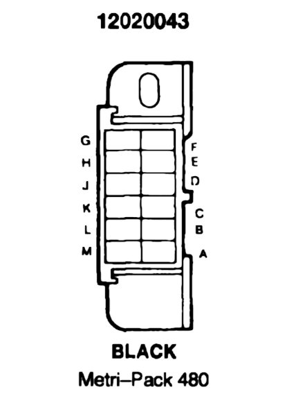

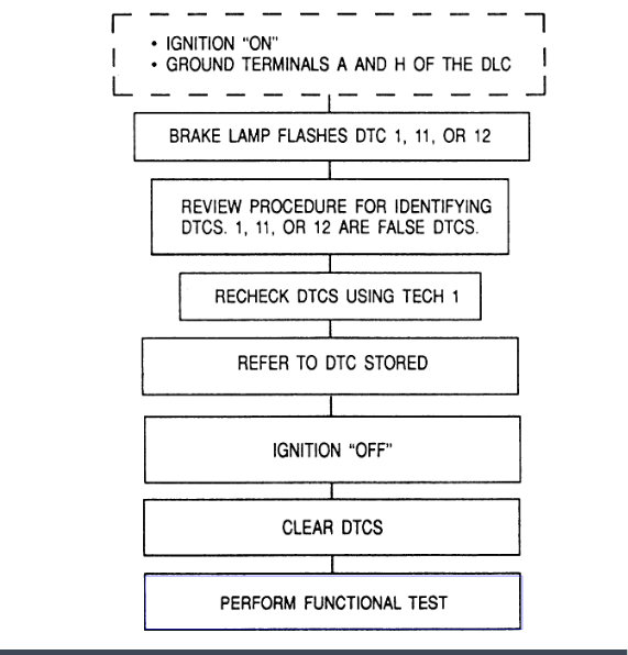

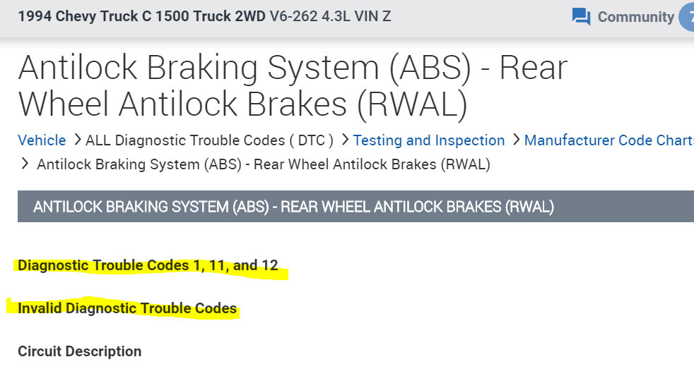

In the diagrams down below I have included the factory diagnostic troubleshooting guide for Direct Trouble Code 12 for your vehicle. Please go through the guide and do exactly as it says and get back to us with what you are able to find out. We can go from there.
Thanks,
Alex
2CarPros
Thursday, September 3rd, 2020 AT 12:47 PM
PAUL FARRAR
Exact same thing. Flashes 12 that's it.
