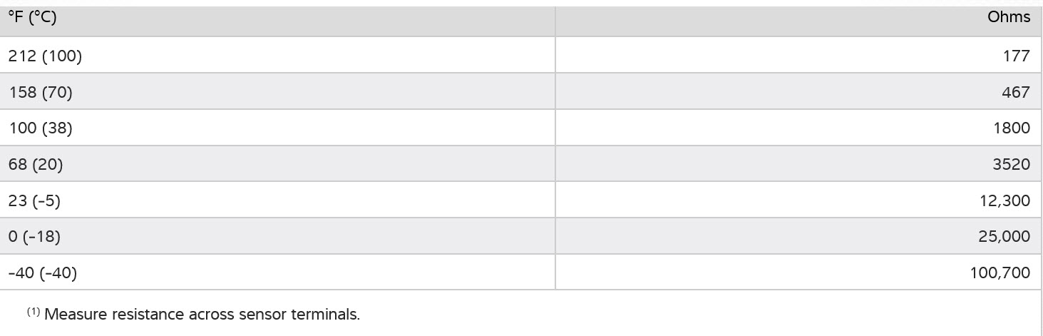

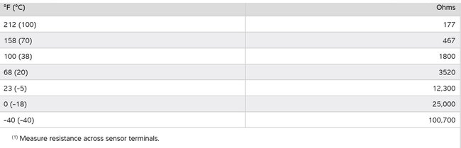

HMAC300
  • 48,601 POSTS
Check coolant temp sensor for connection and corrosion on connector, if it is replace the sensor and connector. Check with sensor in vehicle. Se pic
