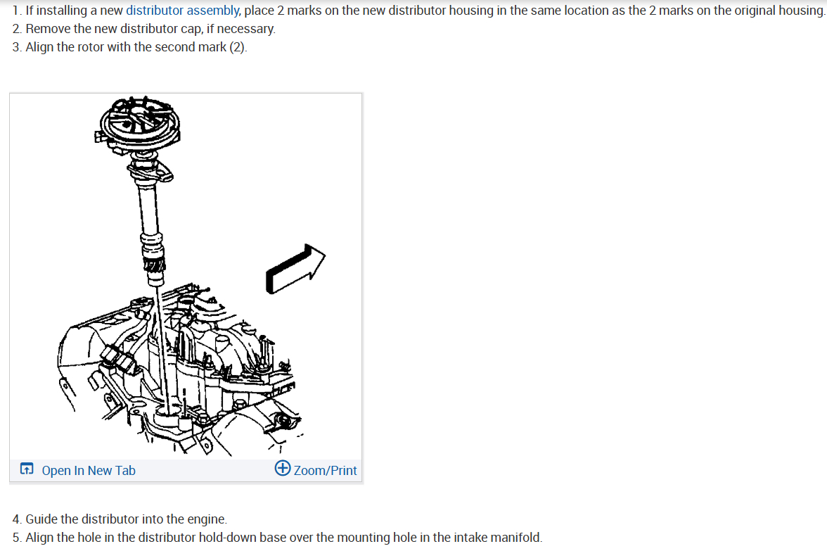

Just changed the intake and rocker cover gaskets on the vehicle listed above with 4.3L Vortex engine. Brought #1 to TDC compression and stabbed distributor to #1 of distributor cap even though the wire goes into the cap from drivers' side #1 contact between cap and rotor is in passenger side. Truck starts cleanly and runs good with slight hesitation during hard acceleration. After warmup, did cold start relearn with all accessories in the off position, turning the truck off the engine shuts down great meaning it doesn't diesel or run-on. Also during road test it did not ping. After sitting, even just for a few minutes the engine won't start and acts as though way out of time. Cranks good but binds up and slight predetonation and will not start. Re stabbing the distributor and same symptoms occur. At total loss as to reason. More info on ignition system is timing is computer controlled and not manually adjustable.

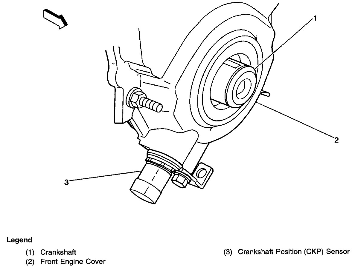

Check the crankshaft sensor on the front of the engine down behind the balancer. That is what actually controls the timing and they like to fail in the manor you describe. Get to it from underneath, if you have the front skid plate, remove it, then unplug the sensor, remove the crud around it and remove the sensor. Install the new one and reconnect. Now do the relearn and try it.

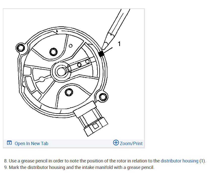

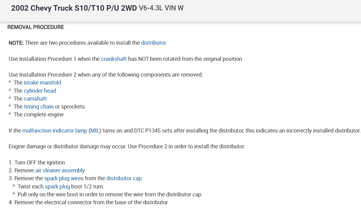

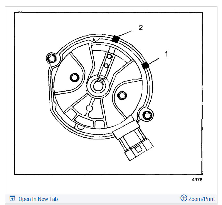

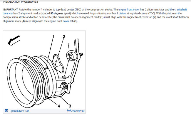

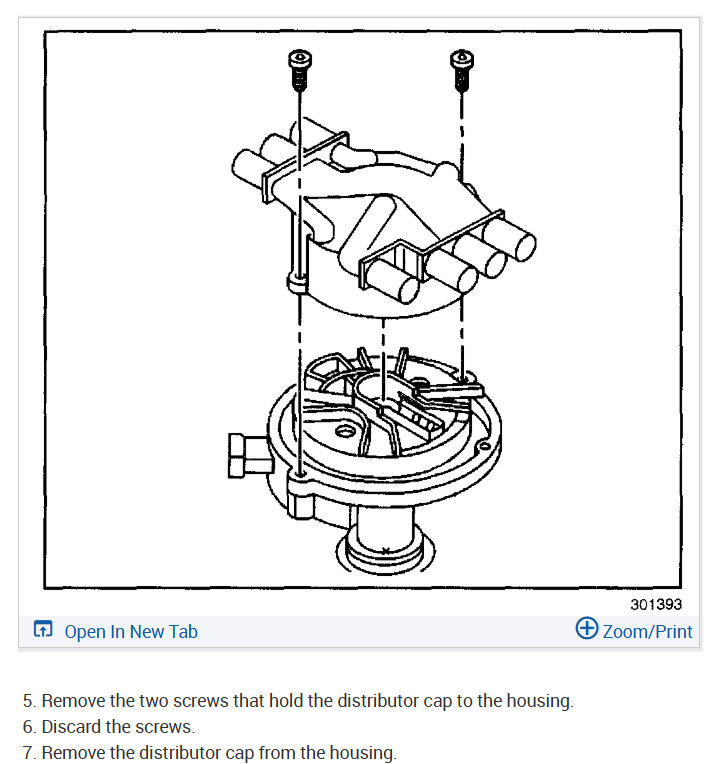

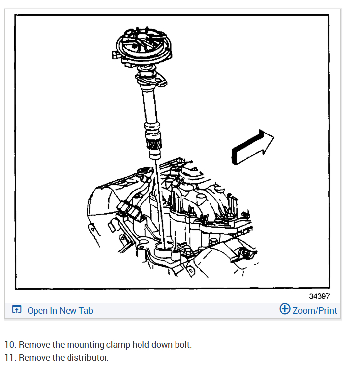

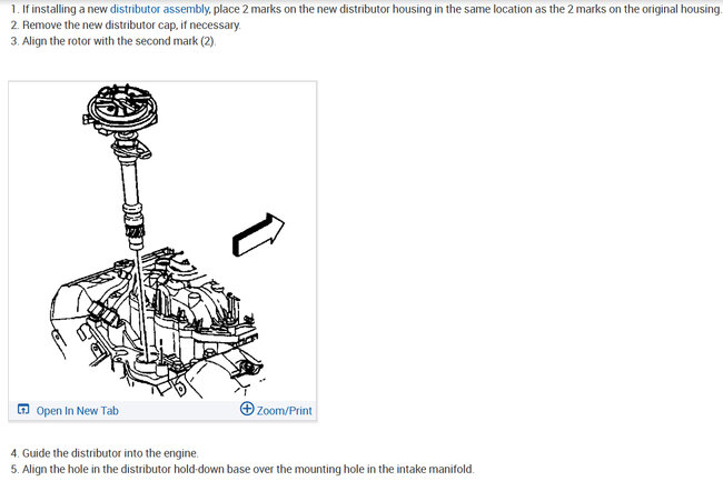

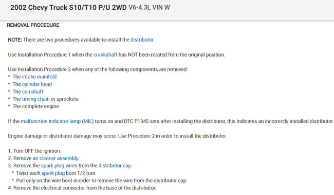

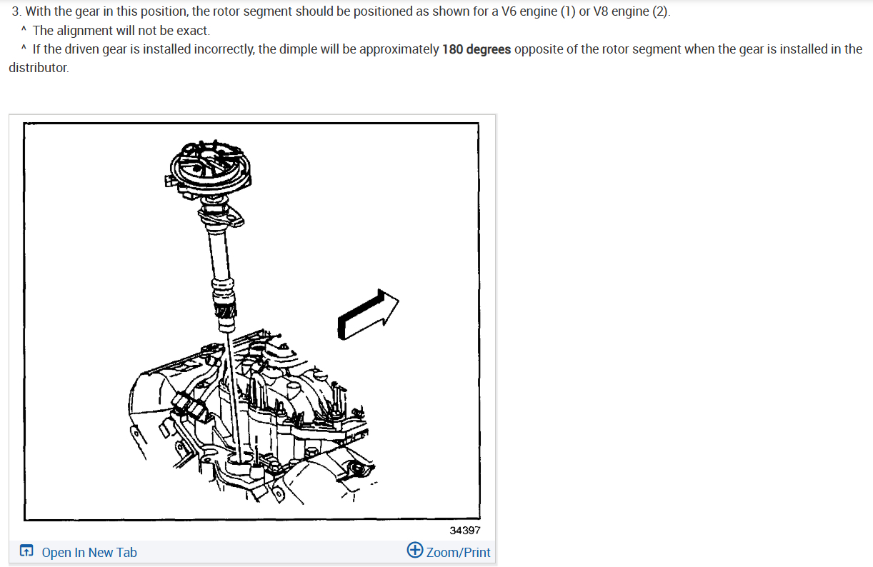

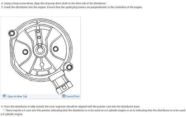

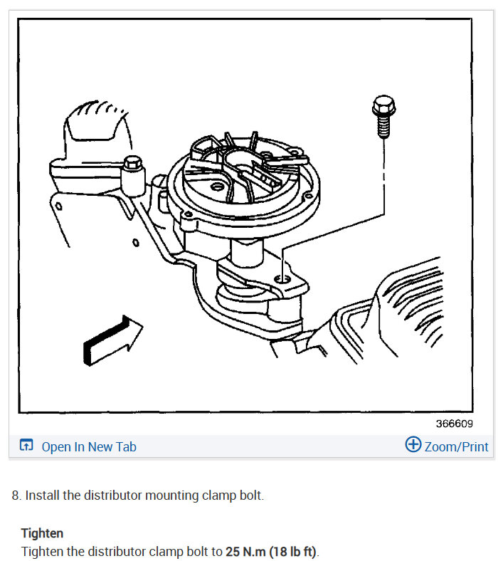

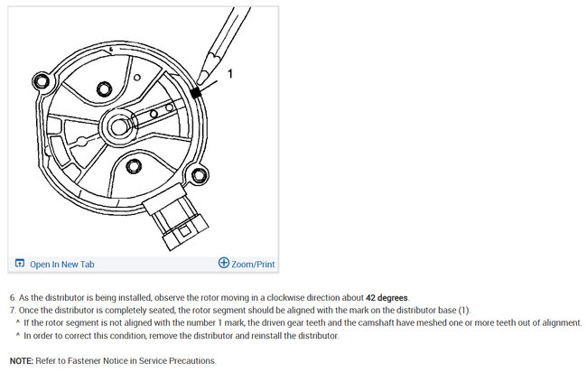

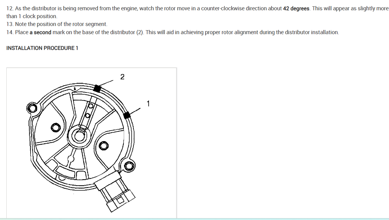

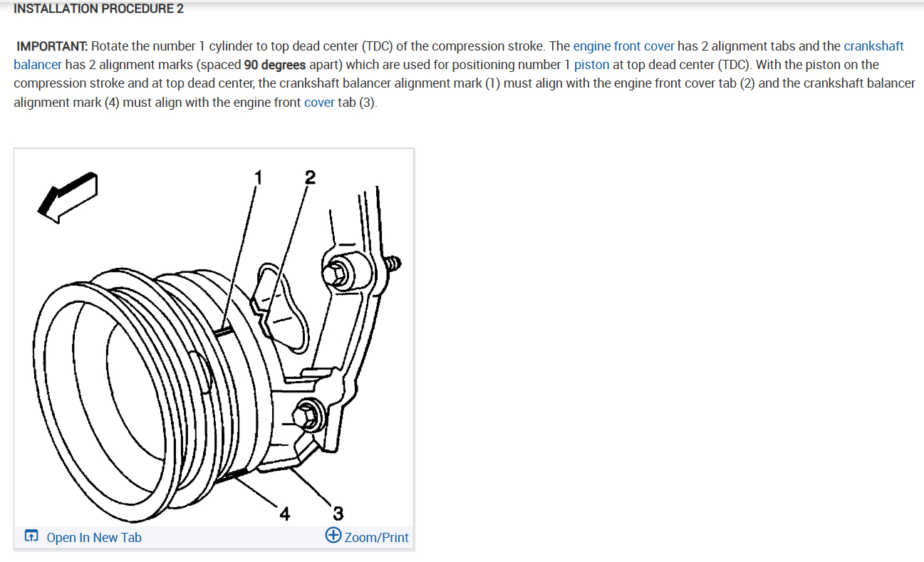

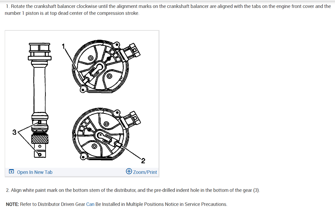

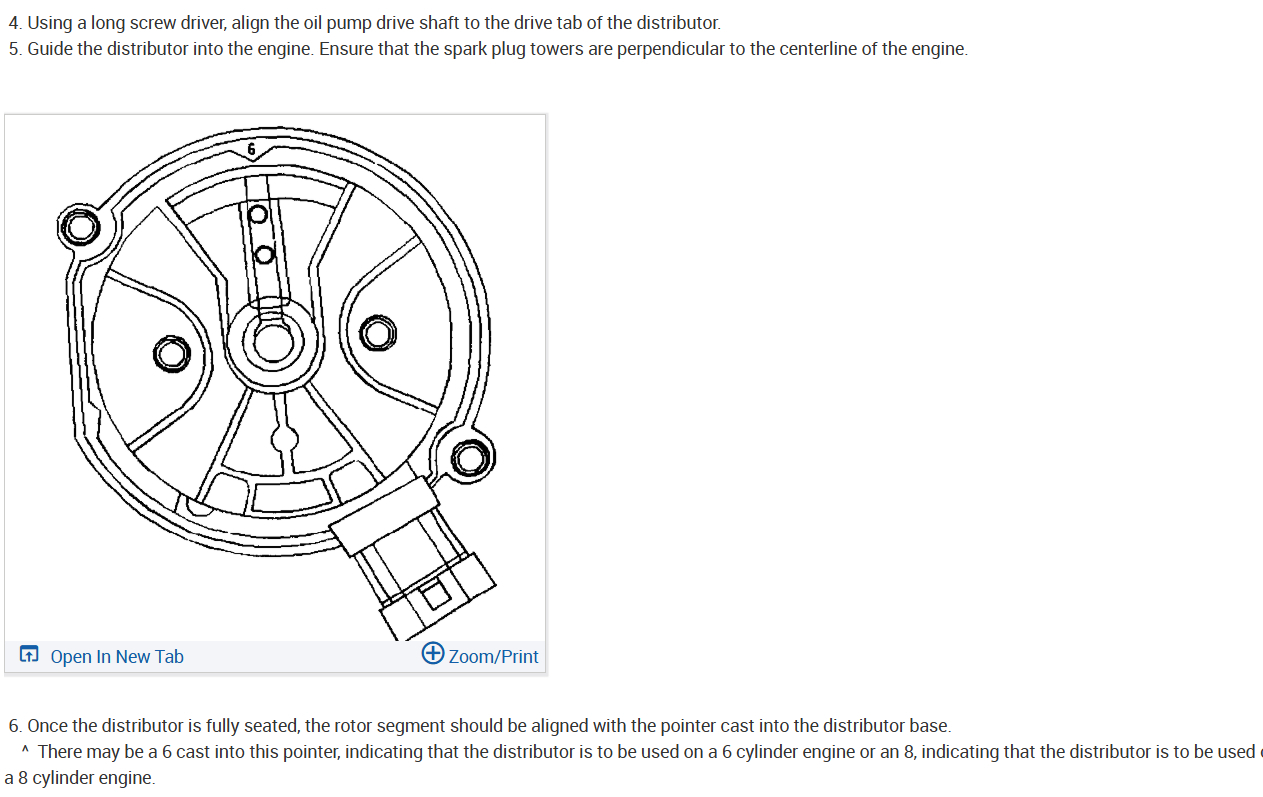

It sounds like the distributor is installed a tooth back. Also, I would check the roll pin in the drive gear for the distributor as well. Here is the correct way to install the ignition distributor. How does the engine sound while cranking over, normal? I just want to make sure the engine is not having internal mechanical issues. You can upload short video of the engine cranking so I can make sure the engine is okay, or you can do a compression test.
Please check out the installation instructions below, there are two ways for the install. Please let us know what happens.

I should have mentioned that the truck did not have any starting problems prior to gasket replacement. It did have a run ability problem but that was due to the leaking intake and not a starting problem. It is possible the crank sensor failed at the same time as I was replacing the gaskets but seems a bit coincidental. Each time I recheck rotor position after start and fail to start it is at #1 TDC still. I've re stabbed the distributor several times by rotating the engine till it's at TDC then re stab it and it will start. Then shut it down and when I try to restart it the sound is not normal sounds like it's way out of time. The sound it makes is like it grinds and binds up like if the starter is loose almost. But after a few stab it cranks normally and starts. I will check the crank sensor for debris and possibly replace it if there is no other reason for this symptom to be occurring.

But more info on the original repair procedure. I did mark the distributor prior to removal but the engine was so covered in oil and dirt (hence the reason for changing the rocker cover gaskets) during the cleanup my markes were erased so had to go to manual timing procedure of finding TDC compression of #1 cylinder and align rotor to corresponding position of dist cap. Truck fired ran well and test drive of of approx 5 miles went well with no pinging and only slight hesitation but no lack of performance. Turned truck off, no diesel or run-on and would not start acting as if more that 30 degrees out of time. Engine sound while cranking was bad with predetonation and grinding/binding of starter. Best way I can describe the sound. I'll attempt to get video and sound but this phone and Internet isn't that great. Thanks again for your knowledge and time.
