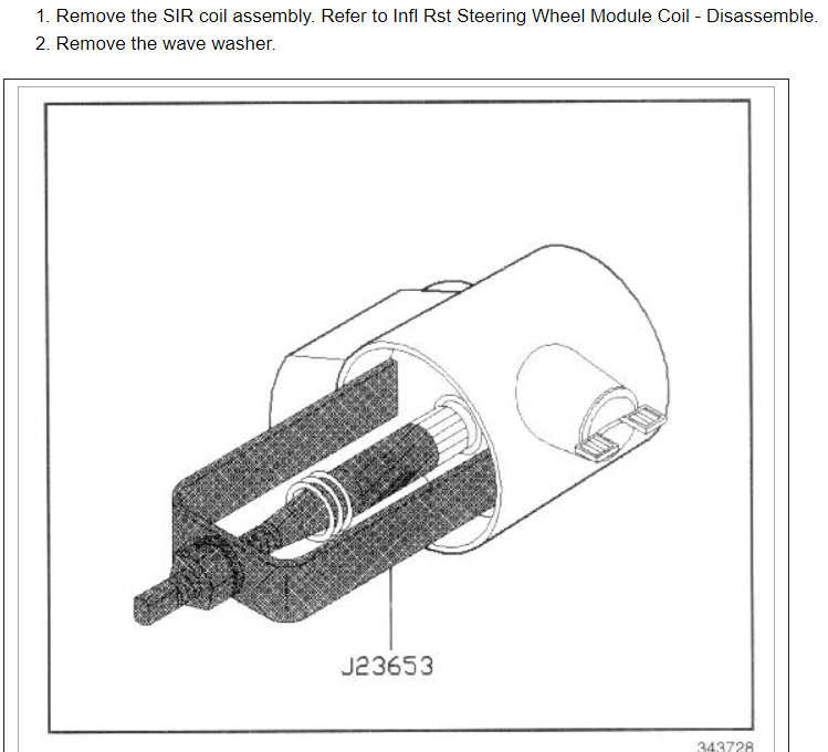

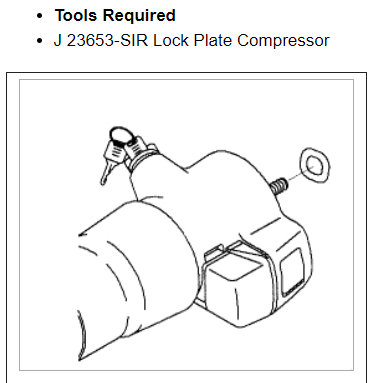

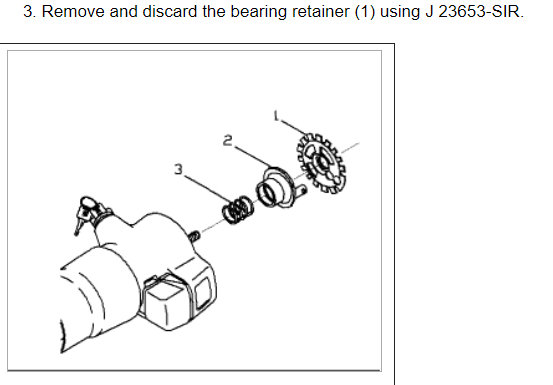

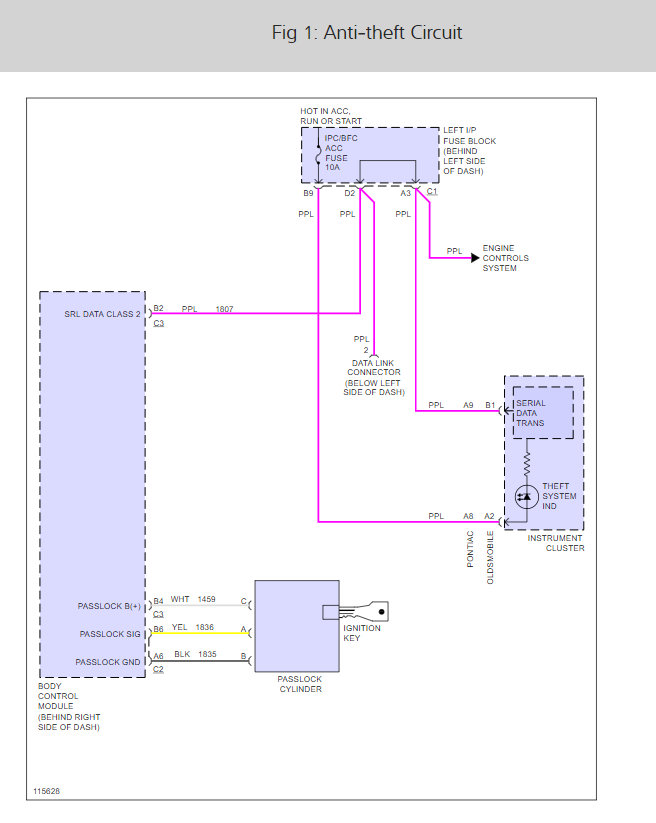

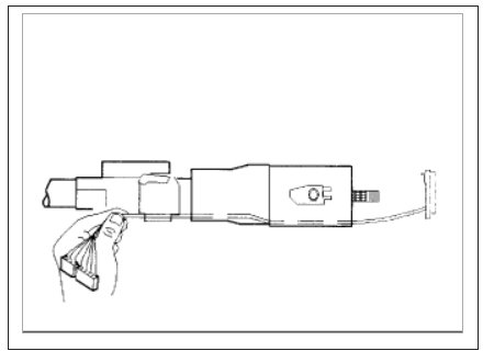

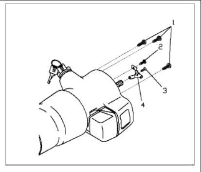

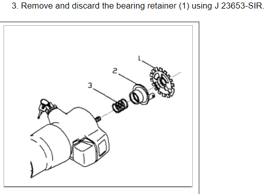

If I can jump is here can I ask if the security light is flashing when you try and start the car? Sometimes we can get going in the wrong direction, I apologize, now lets fix this car. I have seen the ignition lock security wires break that go to the ignition lock which causes the security to stay on. Here is the pass-lock wiring diagrams so you can see how it works with instructions on how to get to the wires below.

The security pass-lock wires are black white and yellow. The return signal to the BCM is 5 ohms less to show the BCM that the security lock has been successfully turned off. I soldered a 5 ohm resistor into the yellow line. After doing the security lock reset a couple times the car started and I haven't had an issue since. And I looked up the factory fuel pressure in the fuel rail on a 3.4 l and 50 is normal.
