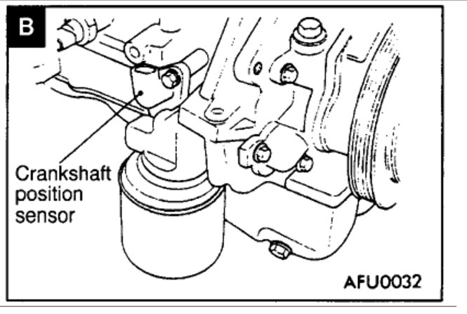

The car starts right up and drives fine. Then it will not start again until it sits for quite a while, hours, or even overnight. Changed the fuel filter but the problem persists. Also, there were no codes generated with a diagnostic tester and the check engine light is not on

This sounds like a crankshaft angle sensor is going out which will not produce any codes. Here is a guide to show you what you are in for when doing the job a diagram (Below) on what it will take to fix on your car.
You may need to lift the car up.

Changed out the crank position sensor but unfortunately it did not correct the problem.
