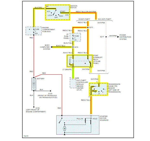

I have replaced the ignition switch, tumbler, fuses, relay's, along with a new starter. Help
Sunday, August 2nd, 2020 AT 5:03 AM
MECHANIC
52,796 POSTS
Good morning,
I attached the wiring diagram for you to view.
Do you have a test light or voltmeter to do some testing? We need to verify powers for the system and controls.
