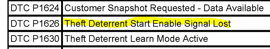

Car suddenly wont start. I have a new battery. It starts but cuts off immediatly. I had it scanned and it said there was an anti-theft issue. Can you please help me?

Lets first confirm the security diagnosis. What I want you to do is turn the key to the run position (engine off) and allow approximately 10 minutes to pass. The anti theft light should turn off. If it does, see if the vehicle starts and stays running.
Let me know what happens. Please note that if this is the case, I will need to know the exact diagnostic trouble codes that were found when it was checked.

I have tried the relearn method with no success. I also changed the ignition switch which didn't change a thing. I'm really stumped. I feel like I have tried everything. Car has been down for 2 weeks now. My wife has to take uber to and from work everyday. What a pain!

The code was a p1626.

Okay, the problem is directly related to the anti theft. See pic 1
There are two ways to relearn the new switch. One is with a GM tech 1 scanner and other hardware or you can try it manually. The manual way is similar to what I told you to try, but adds more steps. I don't know if you tried this technique. However, it is right from my manual. If this doesn't work, it will need reprogrammed by a shop or dealer with the proper tooling. Try this if you haven't already. It requires a minimum of 30 minutes without a scanner.
