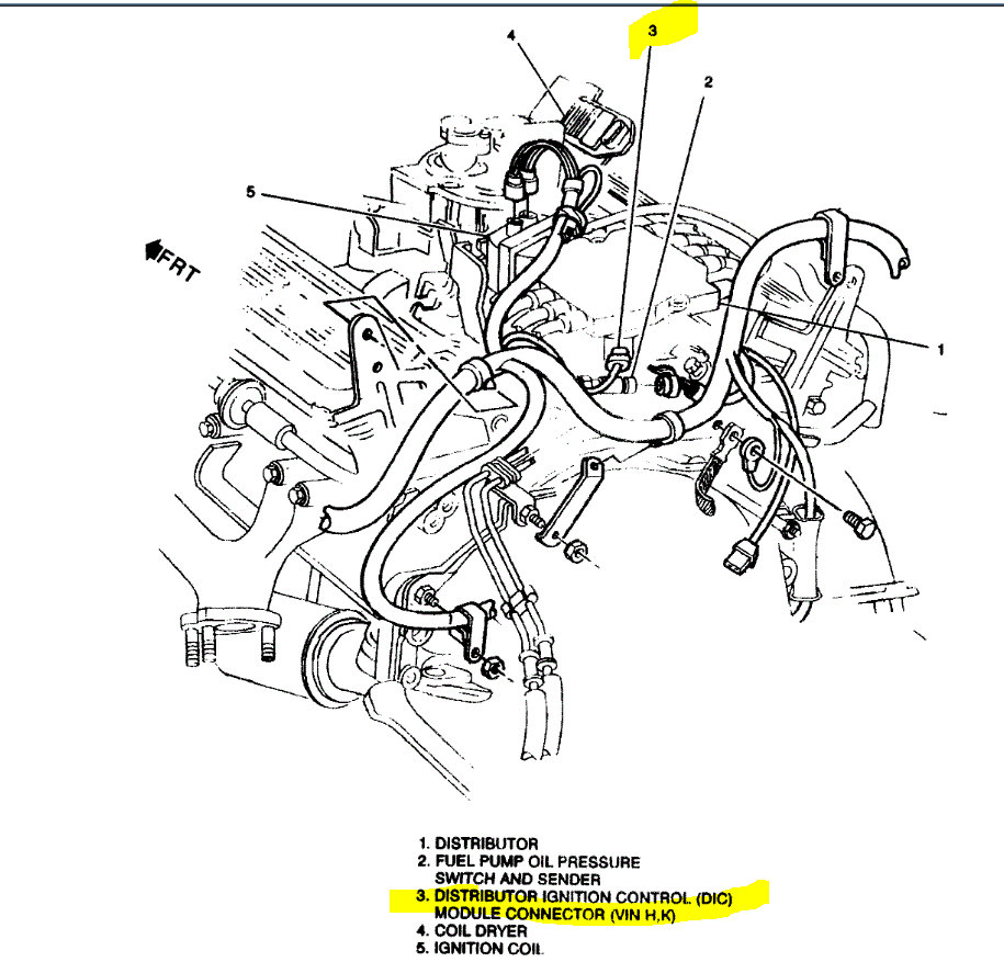

You are correct, that is my mistake. I am so used to vehicles having them anymore, I forget there was a different design. Ugh. Sorry about that.
So, here is what I need you to do. In place of the sensor, a distributor ignition control module is used (DIC). I believe this one is on the side of or under the coils (see pic 1) What I need you to do is check if the spark plugs are getting spark when it won't start. If you find they are, see if it starts for a couple of seconds and then stalls using starting fluid. If it does, we have a fuel issue (I realize all that has been replaced) but I need to explain why I'm having you do this. If there is no change with using starting fluid, suspect there is no spark.
Here is a link that explains how to check for spark:
https://www.2carpros.com/articles/how-to-check-for-ignition-spark
Let me know. I have all the diagnostics for the ignition but suspect it is likely the DIC if there is no spark.
However, to help confirm, I need you to retrieve codes. This has an OBD1 system that doesn't require a scanner. All you need is a short jumper wire or even a paper clip. Follow the directions in this link. If you find code 42, I feel the DIC is the issue. If it isn't, the PCM may have failed.
Let me know what you find.
See pic below.

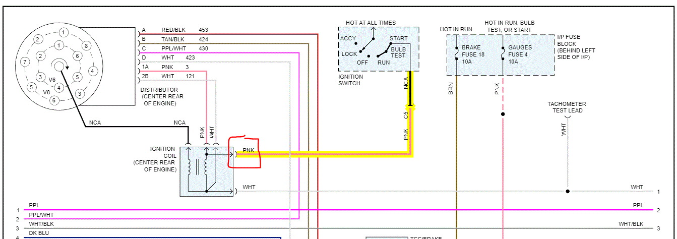

I replaced the ignition control switch thing in the back it's still it's turning over but no spark.
Saturday, June 4th, 2022 AT 10:35 AM
  • 110,194 POSTS
Do me a favor. Locate the pink wire at the coil harness. With the key in the run position and run position, that should have battery voltage. It is supplied via the ignition switch.
You will need a helper to do this. First, with the engine off/key in the run position, see if there is power to it. If there isn't, have the helper crank the engine. Is there power to it in the start position? If there is and the light goes off when the key is released, it sounds like the switch may be bad.
See pic below.
Saturday, June 4th, 2022 AT 9:55 PM
