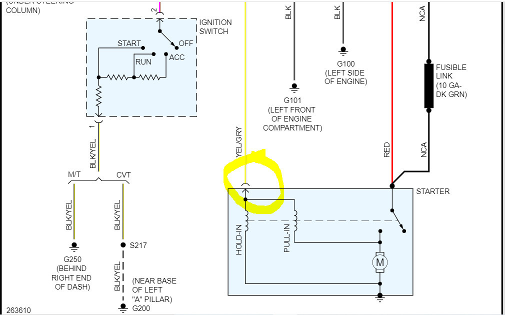

My car won't start. Battery is charged so lights come on. When you turn the key over it won't do anything.

First, see if it will start in neutral. The neutral safety switch may be failing.

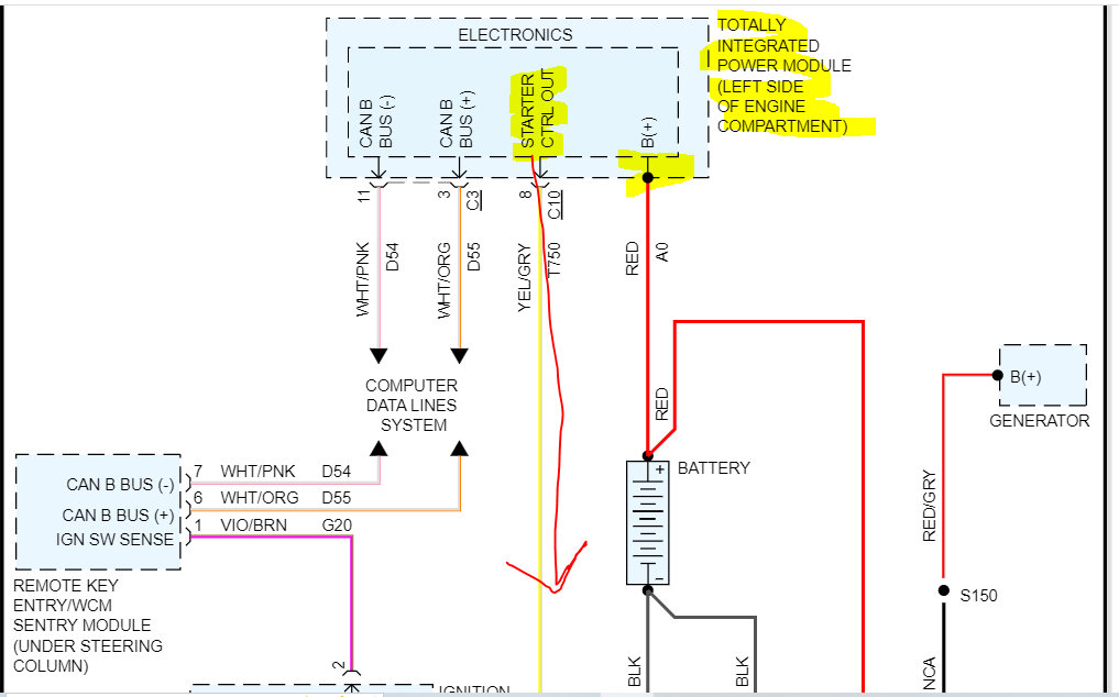

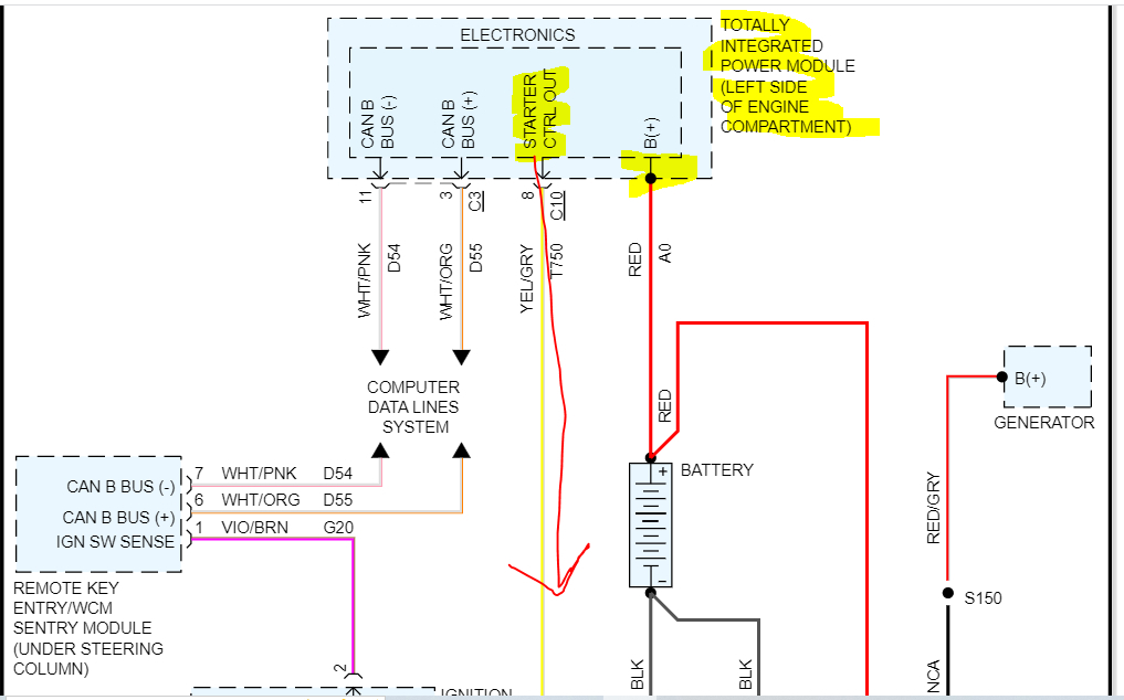

If there are no sounds made by the starter, we need to check for power to the yellow wire with a gray tracer on the starter motor. You will need a helper to do this. This wire only receives power when the key is in the start position. Have a helper turn the key to the start position while you check that wire for power. If there is power, chances are the starter motor itself has failed. If there isn't power, we may have a problem with the totally integrated power module (TIPM).
The TIPM design has been known to fail. They have too many tiny pins in the connectors that can corrode or break. We'll cross this road if we have to.
I attached the wiring schematic for the starter circuit, so you have a reference.
See pics below. Note: The schematic was only one page long. I had to cut it in half to make it readable for you. I did overlap the two so you can follow from one to the next.

Oh yeah, the second pic wouldn't load. Thanks for all your help. I hope it's something easy I can fix. Because I can't afford to keep buying parts and then I'm sure I'll have to send it to a garage.

No problem. When you have a chance, let me know what you find. Confirm there is no power at the trigger wire on the starter, If there isn't, then we will need to check for power at the TIPM.

It could be caused by a few different things. When it fails to start, that is when you need to check if the starter is getting power. If it is, the starter is bad. It may have worked when tested (as it did last night) and then fail again. The only way I can be sure is to check if there is power getting to the yellow wire with the gray tracer on the starter motor. If there is power, the starter is bad. If there is no power, we need to trace the wiring backward to find where power is lost.

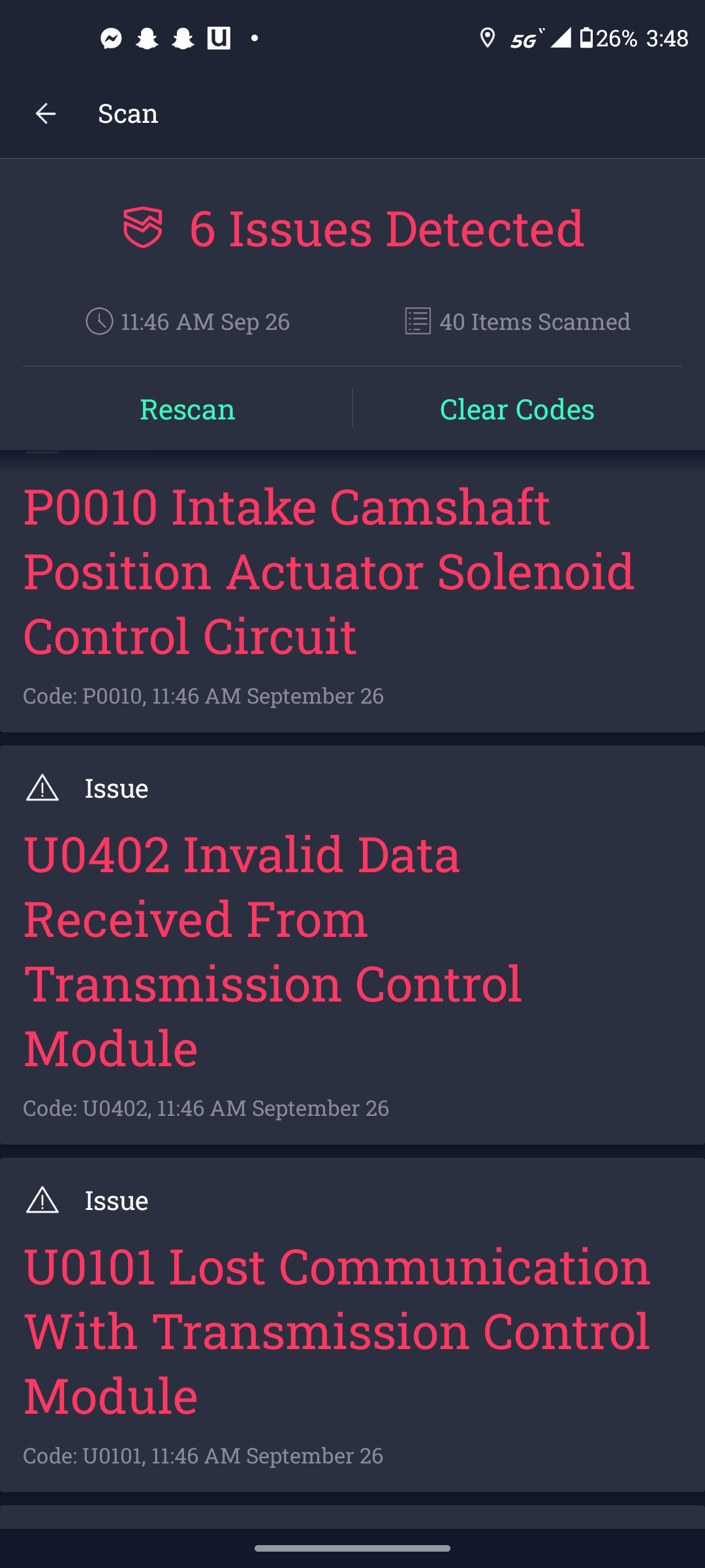

I give up on this car ever since I've been trying to start it the transmission overheating light has been on. Now it starts but it's a hard shift when put into gear and won't move

There is a transmission temperature sensor that may have failed, or a wiring issue related to the sensor. However, I have a question. You indicated when you place it in gear it's a hard shift and it won't move. When it is in drive, does the engine rev as though it is in neutral or park? Also, have you checked the transmission fluid level and condition?
https://www.2carpros.com/articles/how-to-check-and-add-transmission-fluid
As far as the temperature light being on, there are a few different reasons why that could be happening. We need to scan the computer to see what specific code is stored. Is that something you have already done? If so, what code was retrieved?

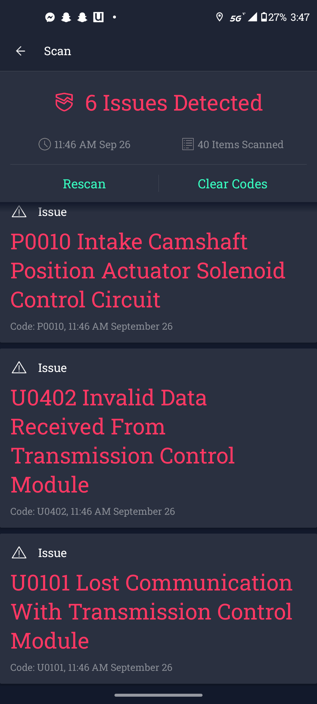

This is what is going on now it's started.

I looked through the new codes. The second two are tied into the can-bus. It could be as simple as a wiring issue or move involved. It would take more diagnostics. The camshaft actuator solenoid could be a wiring issue, or the actuator could be bad.
Both are repairable, it just makes it take a little time to go through the diagnostics. If you want to pursue these issues, I would be happy to help. However, because the topics are different than the original one you indicated, I have to ask you to start a new post. I feel bad asking, but we request it so it is more helpful to others. I hope you understand.
