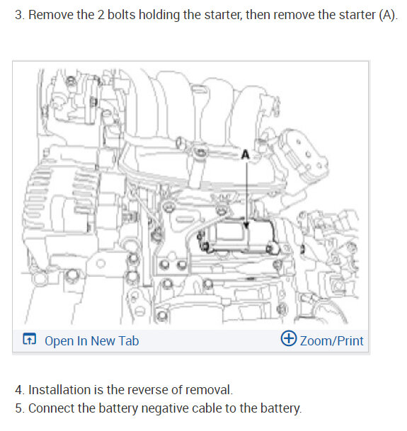

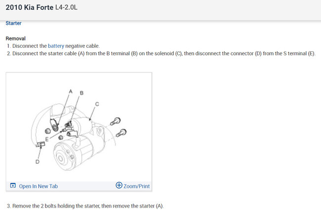

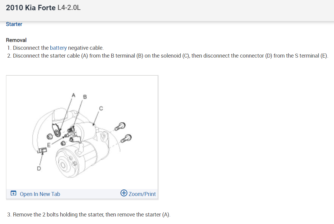

It sounds like the starter is bad (the Bendix is not pushing outwards) but if you upload a short video of the problem I can tell for sure. "solenoid is was cracked so it was loosely hanging off of the starter" so this can cause the problem, here is how to change out the starter correctly. Check out the images (below). Please upload videos in your response to the problem so we can see what's going on.

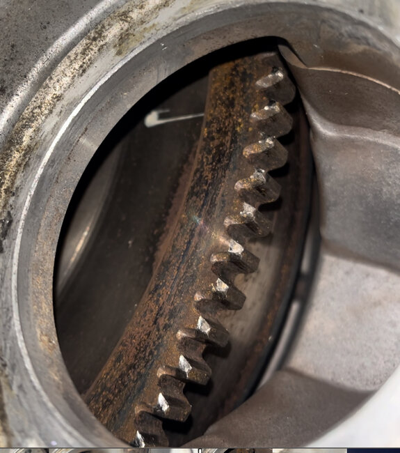

Okay, let's remove the starter and with a flashlight look at the teeth on the flex plate. You can upload an image of the teeth so I can see if needed.

Here’s a picture.

The flex plate looks good, it must be a defective starter motor, I would try another.

It ended up being the flex plate. It got chipped when the starter broke in the accident. I didn’t have anywhere to keep the car while I changed the flex plate, so I had to junk it. Bummer.
