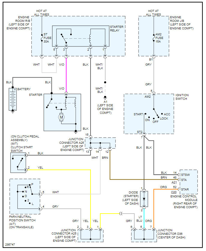

Does not started despite of present electricity?

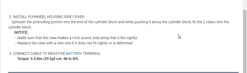

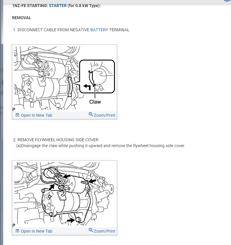

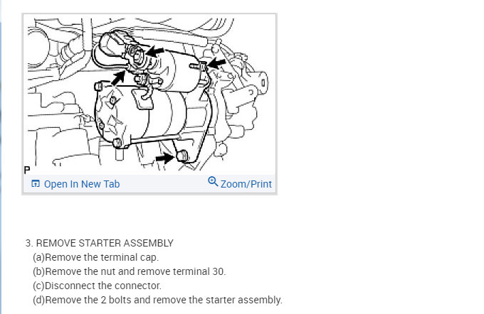

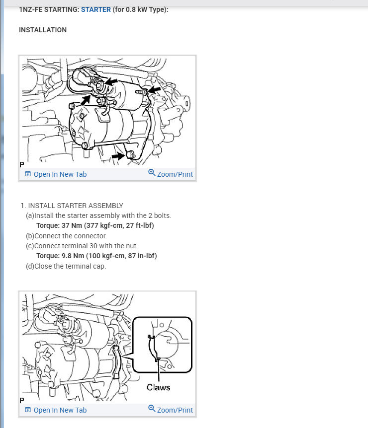

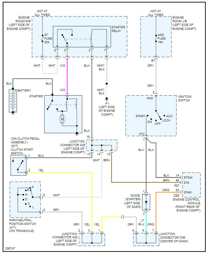

If you have voltage at the starter on both wires when cranking the engine then the starter is the issue.
Take a look at all this information and confirm that you have voltage on the black and purple wire when the engine is cranking and if so, I would replace it.
Let me know what questions you have.
