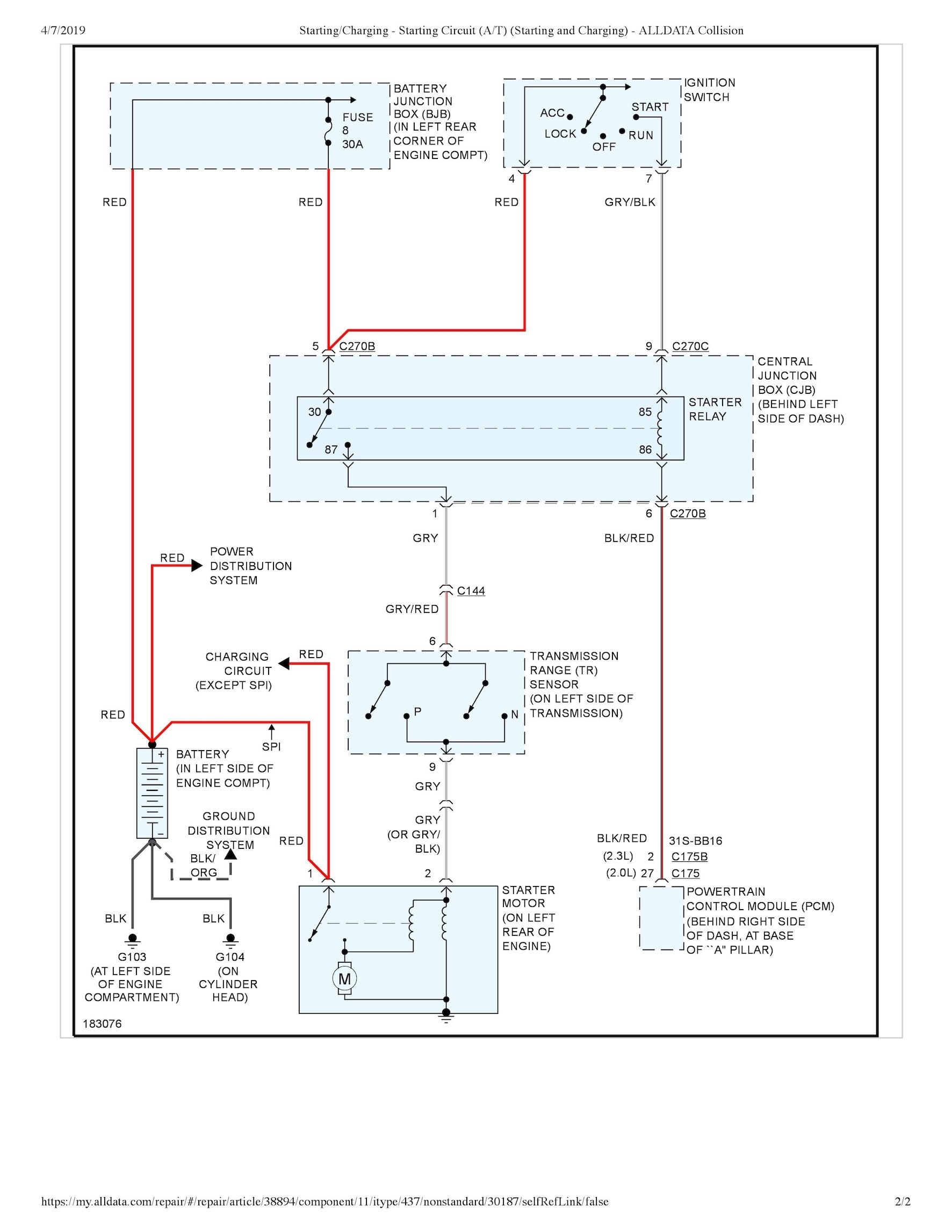

First replaced the starter and it worked a few times. Then replaced the DPFE sensor and it worked a week. Before replacing the sensor, unhooking the battery for sixty seconds solved the problem for a few starts. Now that doesn't work. No manual, so I have no idea what fuse or relay to check or if it is that. Any ideas? I'm almost $300.00 into this and it's getting worse. By the way, nothing on the odbc ever.

Hey Gregma,
I have attached the diagram for the starter circuit.
The fuse in the under hood fuse box is fuse 8, 30 Amp.

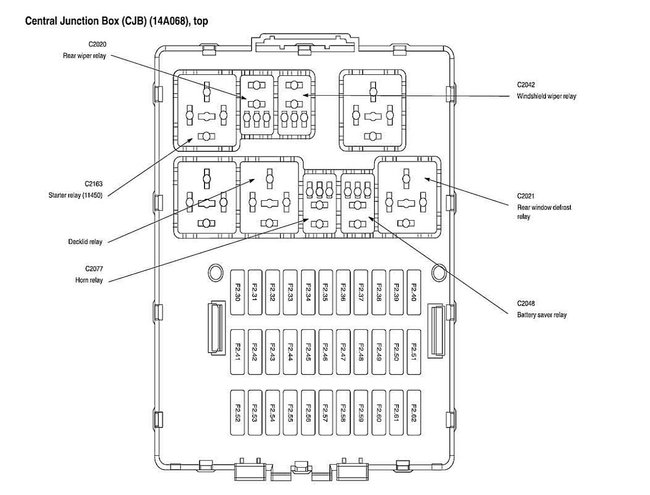

The starter relay is in the under dash fuse box, location shown on the second diagram.
Do you have access to a multi-meter or 12 volt test light?

I do have access to a multi-meter. I've checked the relay in the engine fuse block and it's good. The 30 amp fuse for the ignition and starter in that block was blown. Replaced it and it blew again. I'm unable to get at the relay under the dash as it's covered by some metal frame.

Hey Gregma,
So if the fuse is blowing straight away then you have a short somewhere in the wiring from that fuse to the starter solenoid.
Check back at the starter and make sure that the smaller black or gray/black wire running to the solenoid is not shorting to earth. If it is touching the casing of the starter, the chassis or the engine anywhere this may be your issue. Trace it back and see if you can find anywhere this wire is shorting out. It may be misleading because it is black in color but this is a feed wire so it touching anything that is grounded will blow that fuse.

Well. Found the issue. There was a nut that somehow got wedged between the starter terminal and the case. That caused the short. No idea how it happened as it seemed completely impossible.
Of course now I'm back to the original problem that caused this series of events. Every so often (10-50 starts attempts), all I get is a click. Wait a few seconds and it turns over perfectly.
