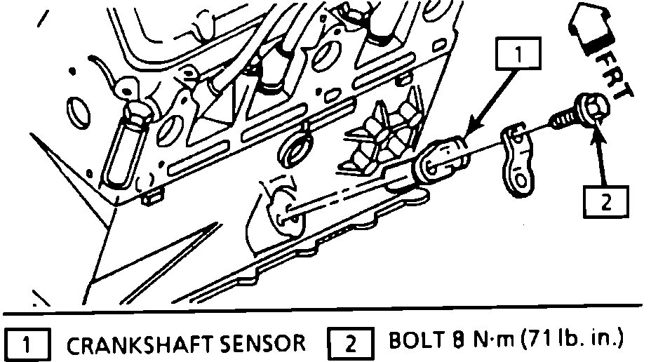

Now, since the engine will start and then stall, take a look through this link. Based on what you are describing, it sounds like a bad crankshaft position sensor.
______________________________
If you determine the sensor is the issue, the crankshaft position sensor is located on the right side of the engine block. See the attached picture.

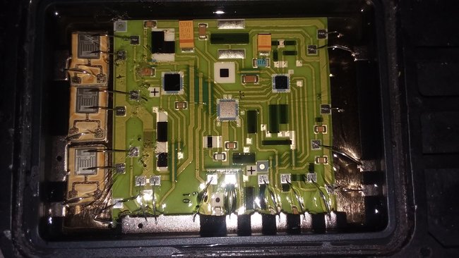

I actually just put a crankshaft sensor on but after trying to start it for five days the battery is dead. I have a cheap battery charger but I am guessing it does not work very well because I left it on for about six hours and it did not charge. So I do not even know if that sensor was the problem because now there is not enough battery. Also for the past two days it has not started at all and the plugs are no longer firing. I took off ignition coils and the mount they are on which is either the ignition grounding or the ignition control module(not sure which it is). I have some basic knowledge on cars and if I know what is wrong, have the part

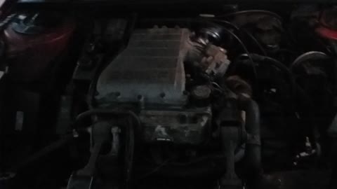

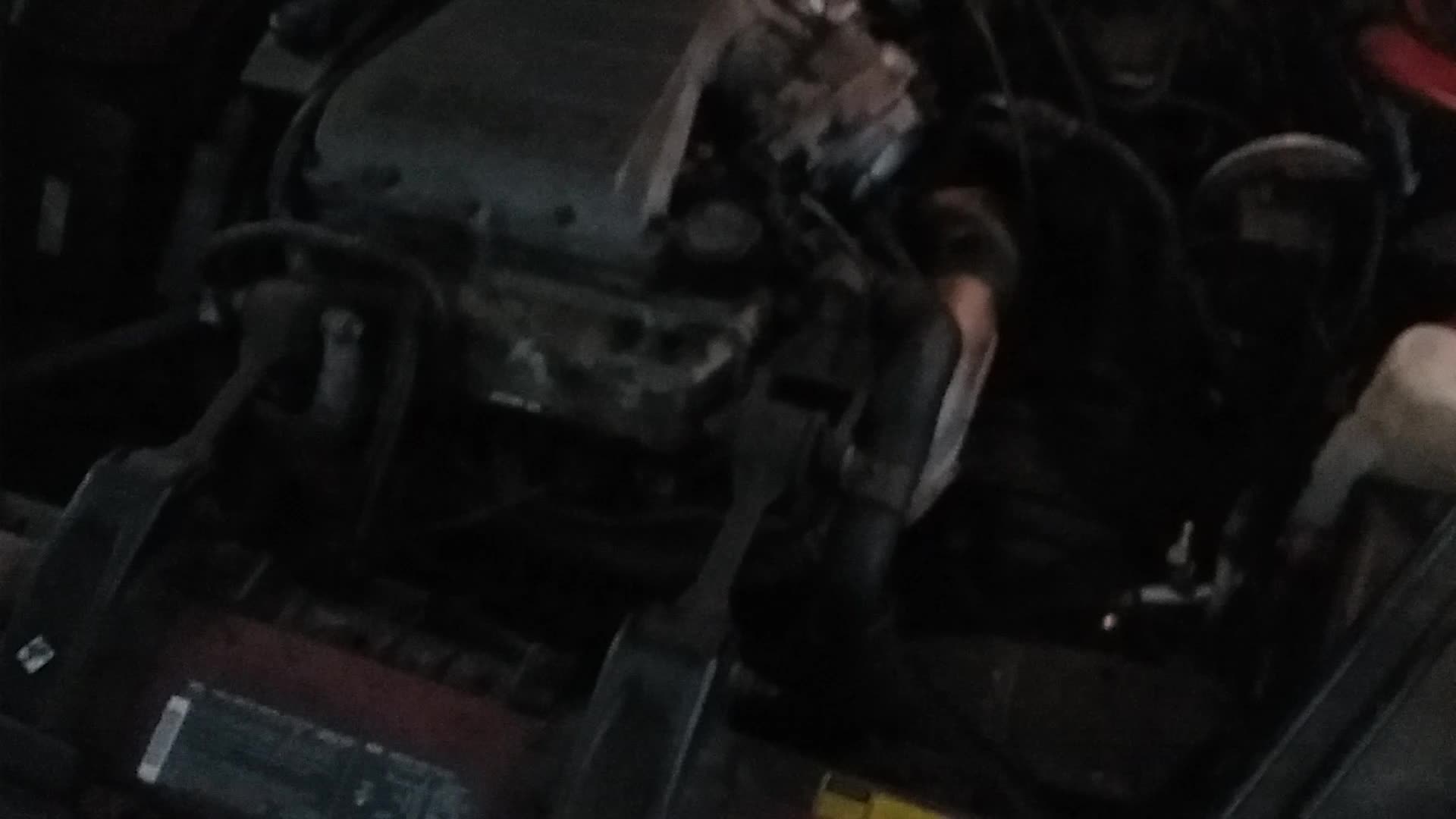

Hey Joe, so I got the battery charged but still doesn't start. I took apart the ignition control module to see if it was bad but it looks damn near new, I've got some pics n a vid of it turning over hopefully it will upload

As far as the ignition control module, most parts stores should be able to check that for you. Also, recheck the crank sensor to make sure everything is plugged in and not damaged. However, since you had a weak spark and now no spark, I suspect the ICM may be at fault.
