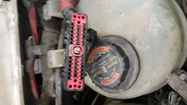

I do not know why your PCM has no pins higher than 40.

It is a diesel. Plus it has not got a psom. For some reason I think being a conversion is the problem.

What is that you are showing me a photo of?
I am heading out, will be back later.
Are you sure you are looking at the PCM? Perhaps get the numbers off the PCM to see it is in fact the PCM.
Saturday, March 17th, 2018 AT 11:29 AM
KEVIN1954
  • 15 POSTS
Picture of the so called PCM connector. Check back later thanks for your input. Have a nice weekend.

I am back, can you back the camera up and take a photo of the PCM and another photo showing where that PCM is located under the hood, because I do not see it on the fender and I do not know why they would move it when doing a conversion.
How about the part number off that PCM too?
These are the PCM part numbers I see, for federal F8UZ12A650AFH and for California F8UZ12A650AGH.
