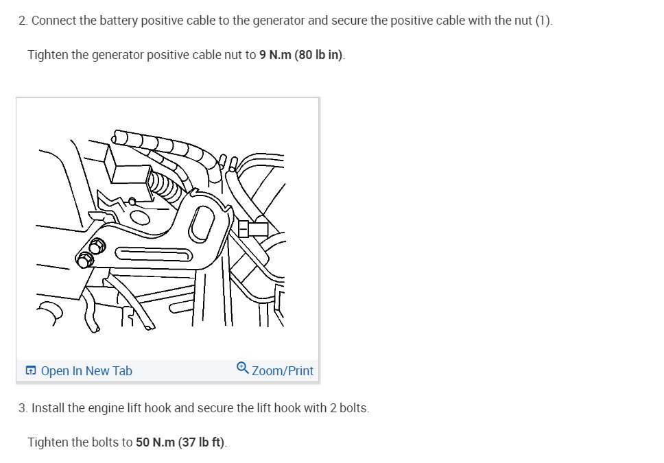

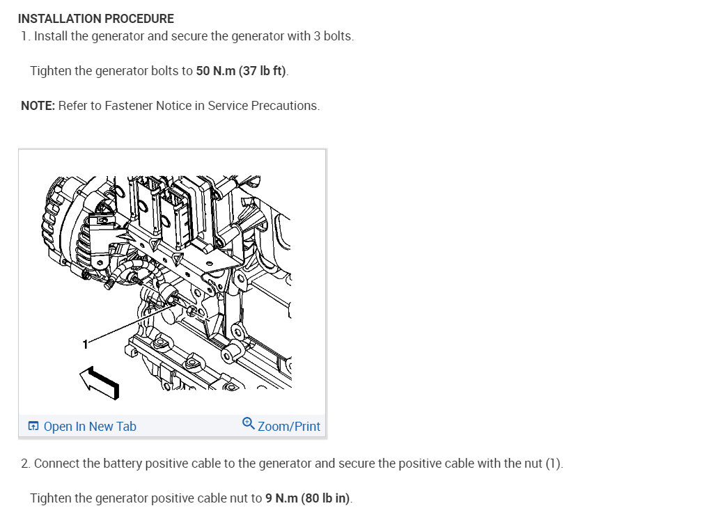

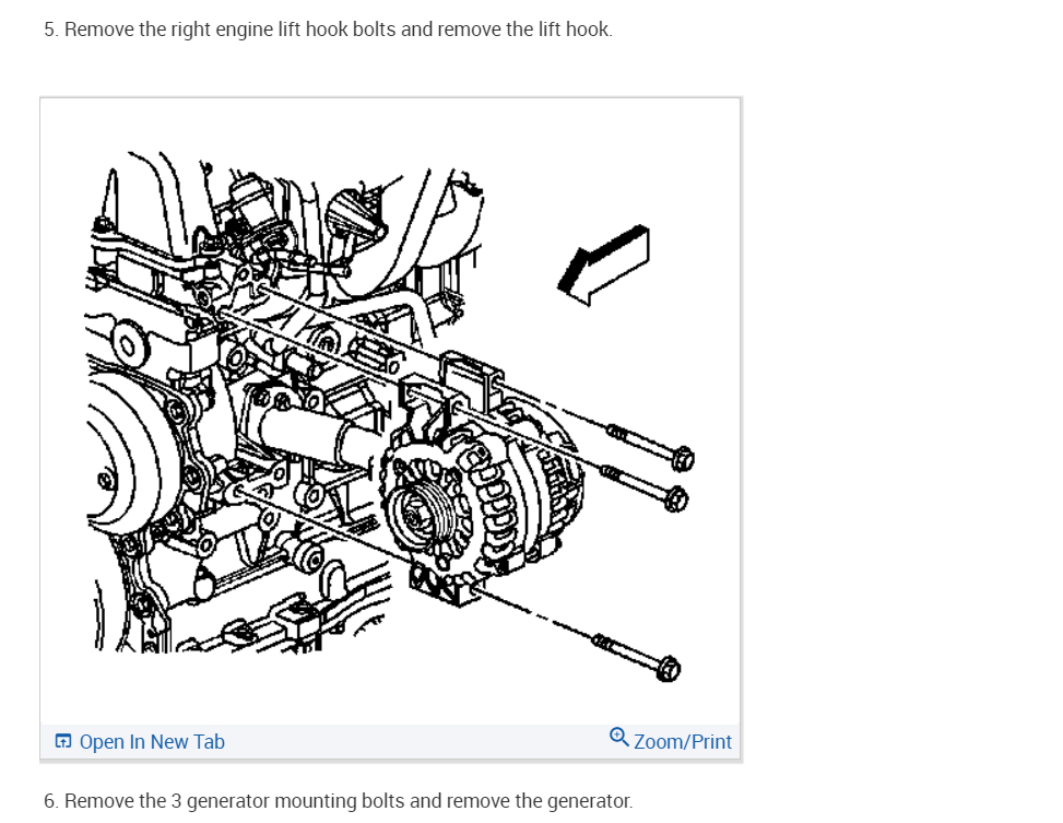

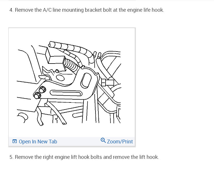

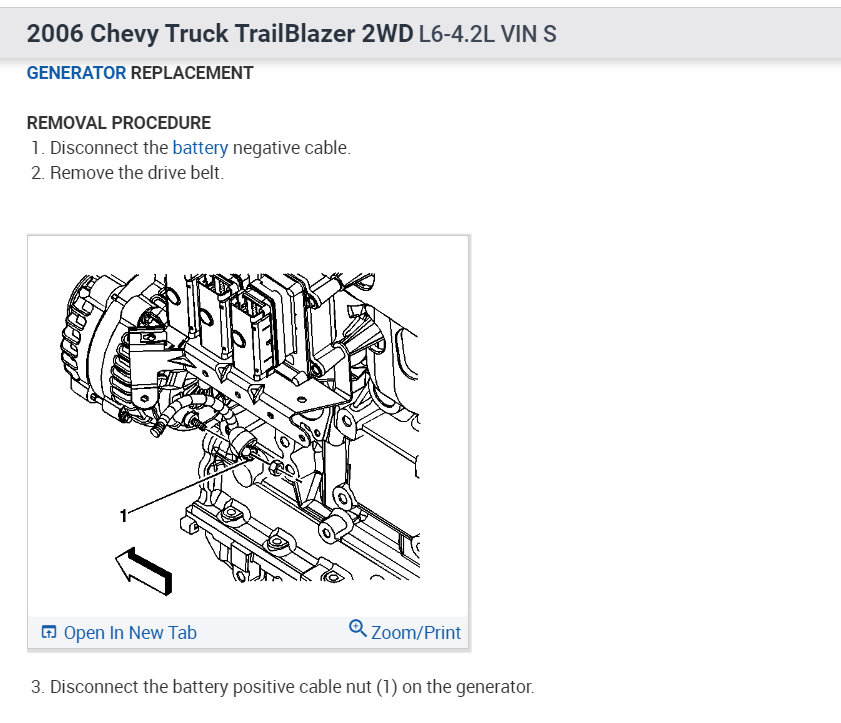

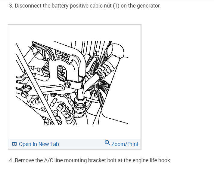

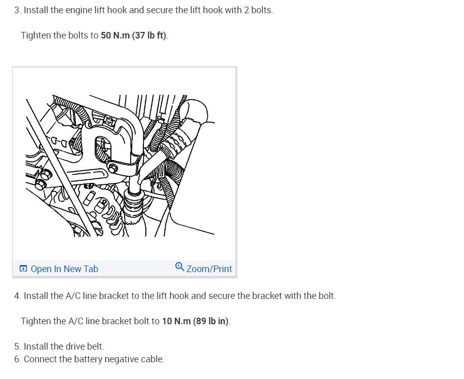

Here is how to replace the alternator in case you need it. I have also seen the instrument cluster short out and cause this issue as well. Check out the images (below). Please let us know what you find. We are interested to see what it is.
