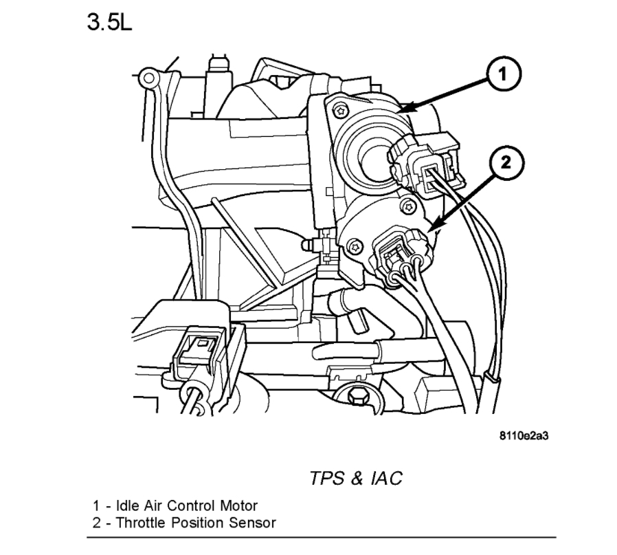

Also, the throttle position sensor controls the shifting time. It could be malfunctioning.
REMOVAL
1. Disconnect the negative battery cable.
TPS & IAC
2. Disconnect the TPS (2) electrical connector.
3. Remove the TPS (2) mounting screws. (4) Remove the TPS (2).

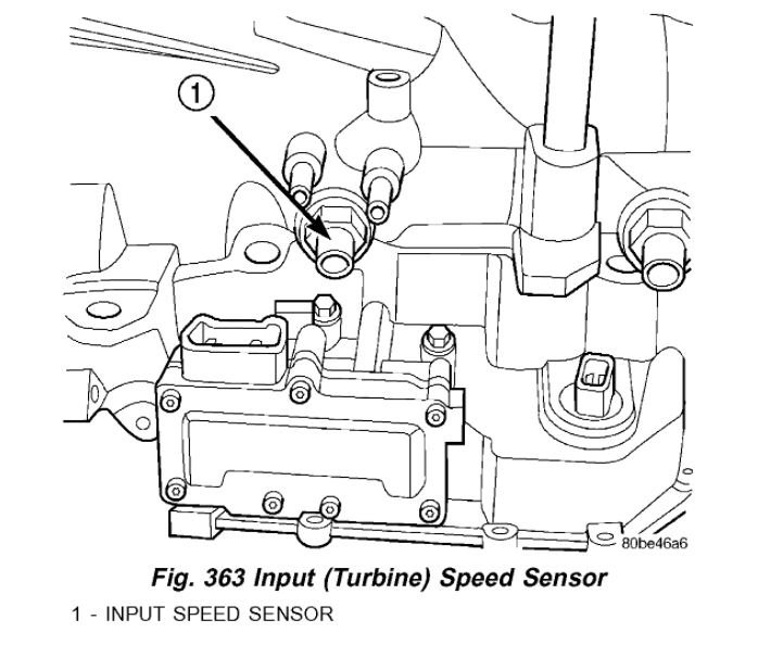

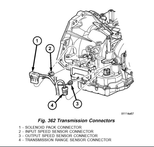

The code when we hooked up the computer said P0700 that was the only engine code. The transmission fluid look good. Could it be the input/output sensors? What needs to be done after removing the TPS? How can you tell if the throttle position sensor is malfunctioning?
-2
Tuesday, March 9th, 2021 AT 8:12 AM
The 700 means there are other codes set in the transmission. You would need an advanced scan tool to read the other code.
Yes, it could be those sensors but there should be codes for them in the system. I posted pictures of the location for you below.

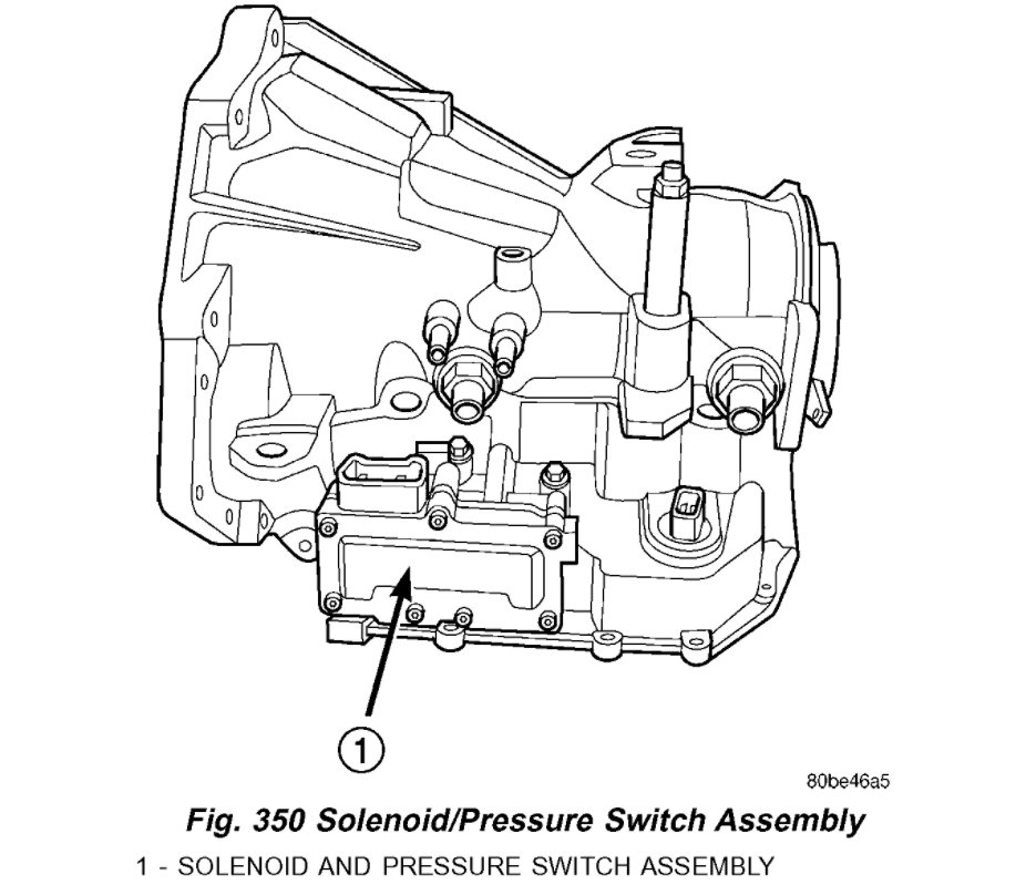

SOLENOID / PRESSURE SWITCH ASSY
DESCRIPTION
Fig. 350 Solenoid/Pressure Switch Assembly
The Solenoid/Pressure Switch Assembly (1) (Fig. 350) is external to the transaxle and mounted to the transaxle case. The assembly consists of four solenoids that control hydraulic pressure to the LR/CC, 2/4, OD, and UD friction elements. The reverse clutch is controlled by line pressure from the manual valve in the valve body The solenoids are contained within the Solenoid/Pressure Switch Assembly, and can only be serviced by replacing the assembly.
The solenoid assembly also contains pressure switches that monitor and send hydraulic circuit information to the PCM/TCM. Likewise, the pressure switches can only be service by replacing the assembly.

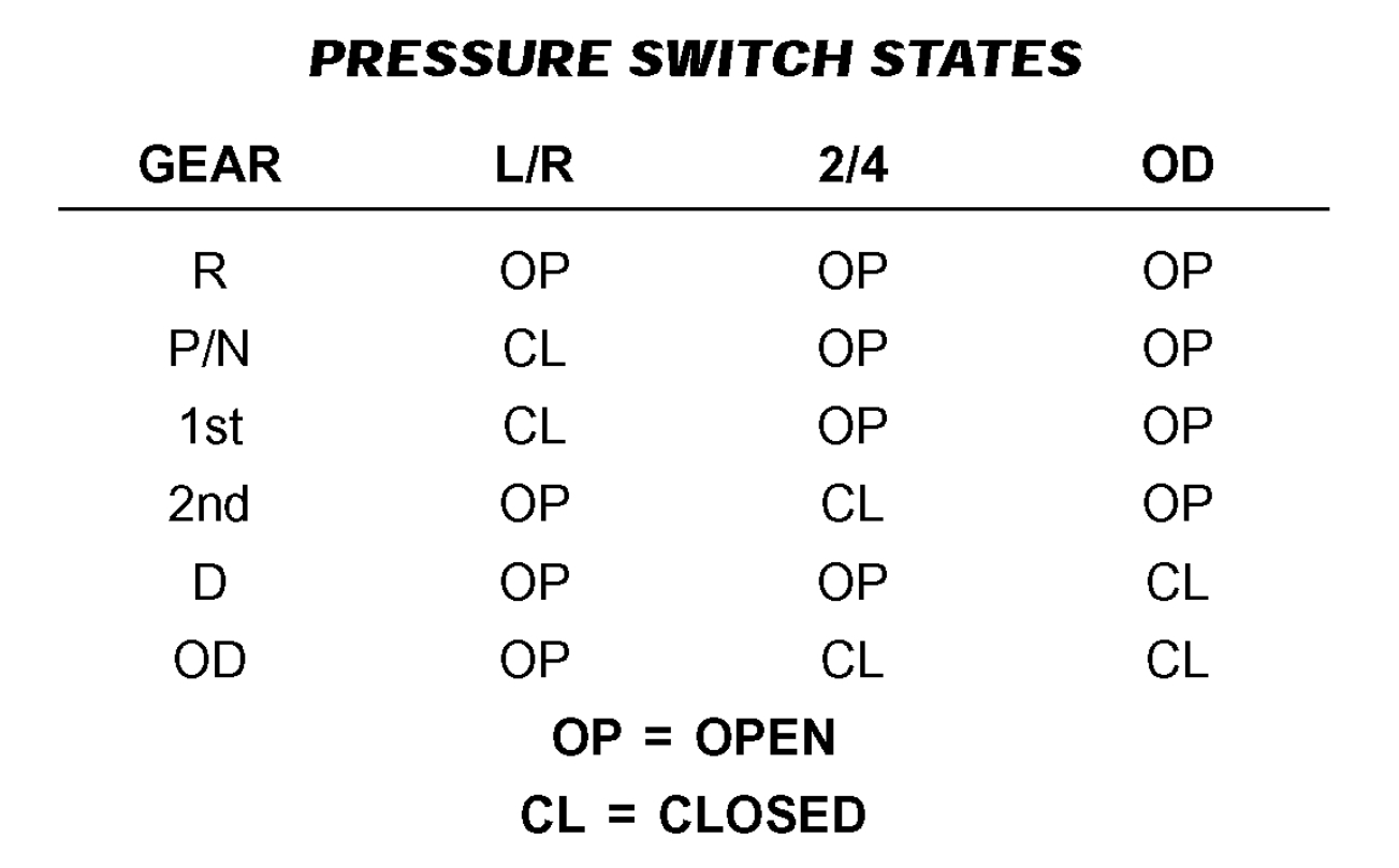

PRESSURE SWITCHES
The PCM/TCM relies on three pressure switches to monitor fluid pressure in the L/R, 2/4, and OD hydraulic circuits. The primary purpose of these switches is to help the PCM/TCM detect when clutch circuit hydraulic failures occur. The range for the pressure switch closing and opening points is 11-23 psi. Typically the switch opening point will be approximately one psi lower than the closing point. For example, a switch may close at 18 psi and open at 17 psi. The switches are continuously monitored by the PCM/TCM for the correct states (open or closed) in each gear as shown in the following chart:
PRESSURE SWITCH STATES
A Diagnostic Trouble Code (DTC) will set if the PCM/TCM senses any switch open or closed at the wrong time in a given gear.
The PCM/TCM also tests the 2/4 and OD pressure switches when they are normally off (OD and 2/4 are tested in 1st, gear, OD in 2nd gear, and 2/4 in 3rd gear). The test simply verifies that they are operational, by looking for a closed state when the corresponding element is applied. Immediately after a shift into 1st, 2nd, or 3rd gear with the engine speed above 1000 rpm, the PCM/TCM momentarily turns on element pressure to the 2/4 and/or OD clutch circuits to identify that the appropriate switch has closed. If it doesn't close, it is tested again. If the switch fails to close the second time, the appropriate Diagnostic Trouble Code (DTC) will set.

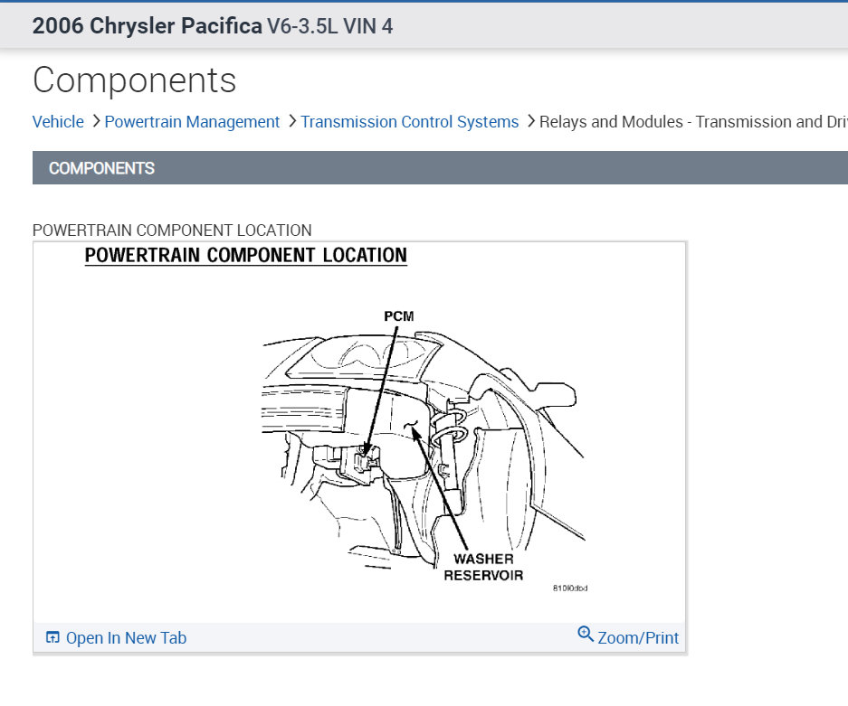

It sounds like the PCM is not working correctly P0700, here is the location for the PCM and how to replace it, I have seen water damage to the electrical connector so start there and look for corrosion. Also, we should do a CAN scan because this car has a TIPM which can go out as well. A CAN scan is easy to do. You can get a CAN scanner from Amazon for about $30.00.
