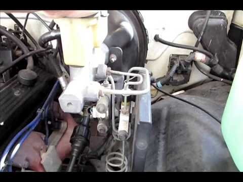

Brakes started to get soft, I figured it was time to replace the drum brakes. Found the wheel cylinder and axle seals were bad. Replaced both on each side, drum brakes were fine. Bled the brakes, then the brake master cylinder popped a leak and replaced that. Front brakes are good as well. Bled them again, After all that I still have spongy brakes. My truck is listed above it is the Scottsdale model. It does have the anti-lock system (old ABS). Semi metallic brakes all around, disc in front drum in rear.
Thoughts?

MCTANK93
  • 15 POSTS
During test drive is still spongy, not sure if I have common ABS or not. When I replaced the rear wheel cylinders and axle seals it was on jack stands, I did the bleed process on the ground. I know when I noticed the leak from the master brake cylinder (the next morning) it was very low maybe two or three caps full with fluid in the little area of reservoir but almost full in the larger area in reservoir. Added a picture of the basic area of my brake cylinder and reservoir area. Before all this, my brakes if you pushed the pedal only four inches you would almost be thrown into the window now It is almost to the floor in order to stop.

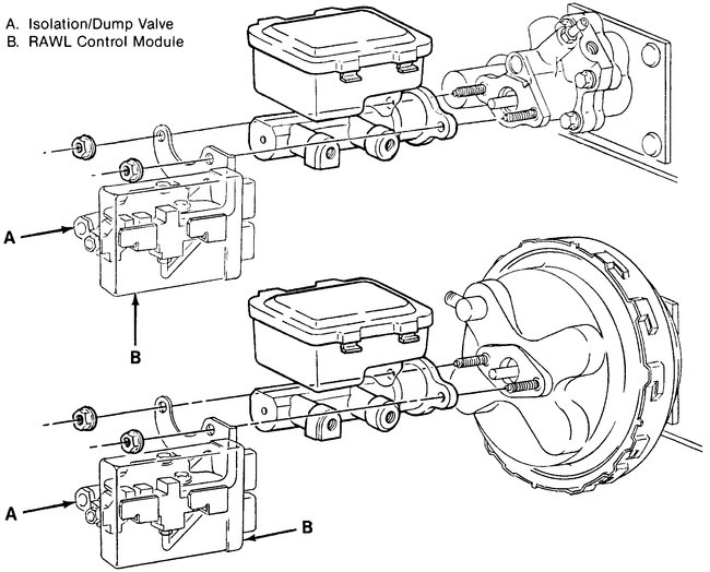

CARADIODOC
  • 34,449 POSTS
You have the RWAL system which was more common for the time. The dump valve and block valve are below and just to the right of the master cylinder in your photo. Next is the combination valve which is a standard part of all brake systems That is the brass block the two brake lines from the master cylinder go into. To the right of that is the ABS computer. That is the black rectangular box, about one inch wide. With this system, you bleed the brakes like normal, with no special procedures or scanner needed.
The next thing to look at is if the rear shoes are fully-adjusted. GM did not have much trouble with their self-adjusters, but look at the six "lands" on the backing plates. Those are the raised spots the shoes ride on. Most manufacturers bend tabs over on the shoe frames, then those tabs slide on the lands. Those should be lubricated with special high-temperature brake grease to prevent squeaks and wear. On GM's shoes, there are no tabs. The edges of the frames grind into those lands and cause grooves to form. Those can prevent a shoe from applying under light pedal pressure, and they can cause a shoe to stick and fail to release. Either condition can be overlooked and make it appear the shoes are adjusted properly, but when driving, they have to move too far to contact the drum. That will cause a low pedal.
While there are all kinds of things like this to look for, my suspicion is there is still air in the system. Did you bench-bleed the new master cylinder before it was installed? Have a helper push the brake pedal up and down a couple of inches repeatedly while you watch in the reservoir with the cover removed. If you see a few tiny air bubbles pop into the reservoir when the pedal is released, there is air in those lines. If that air did not get pushed down too far while bleeding previously, it will work its way out over time.
Also, look at the position of the shoes. Both of them must be contacting the large anchor pin at the top of the backing plate. If one is being held away from that pin, suspect the parking brake cable is rusted in the partially-applied position. That will prevent the shoes from self-adjusting. Next, look at the parking brake strut bar between the middles of the two shoes. You should be able to push that against the anti-rattle spring, toward the front of the truck about an eighth inch with thumb pressure. If it has no free play, again suspect a sticking parking brake cable.
