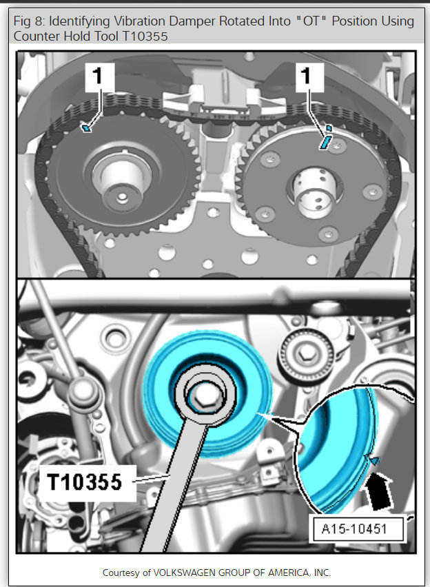

Well it has been like this for like twenty days so I do not know how long does it take to relearn.

It sounds like the timing belt might be still off a tooth. Here is the camshaft timing so you can double check check it.
Image (Click to make bigger)

It is sorted. Now mpg is better. Cannot wait to see the mpg on motorway now. :) Thank you.
