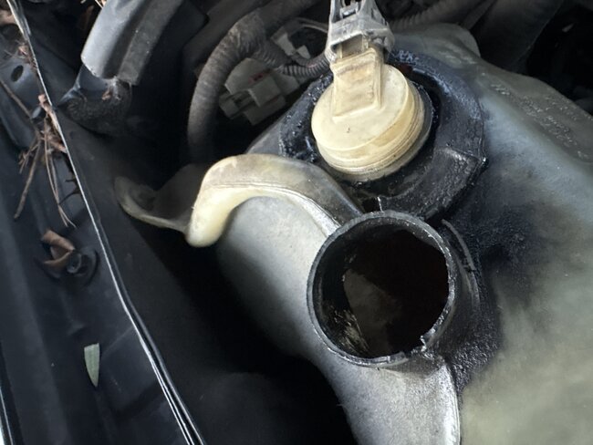

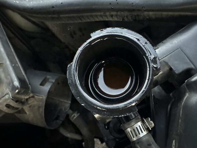

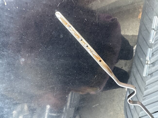

There’s thick black sludge in coolant reservoir that doesn’t smell like oil. Opened radiator cap and coolant is fine so oil on top of water or anything. Car never overheats but oil pressure is closer to high on the instrument cluster gauge.

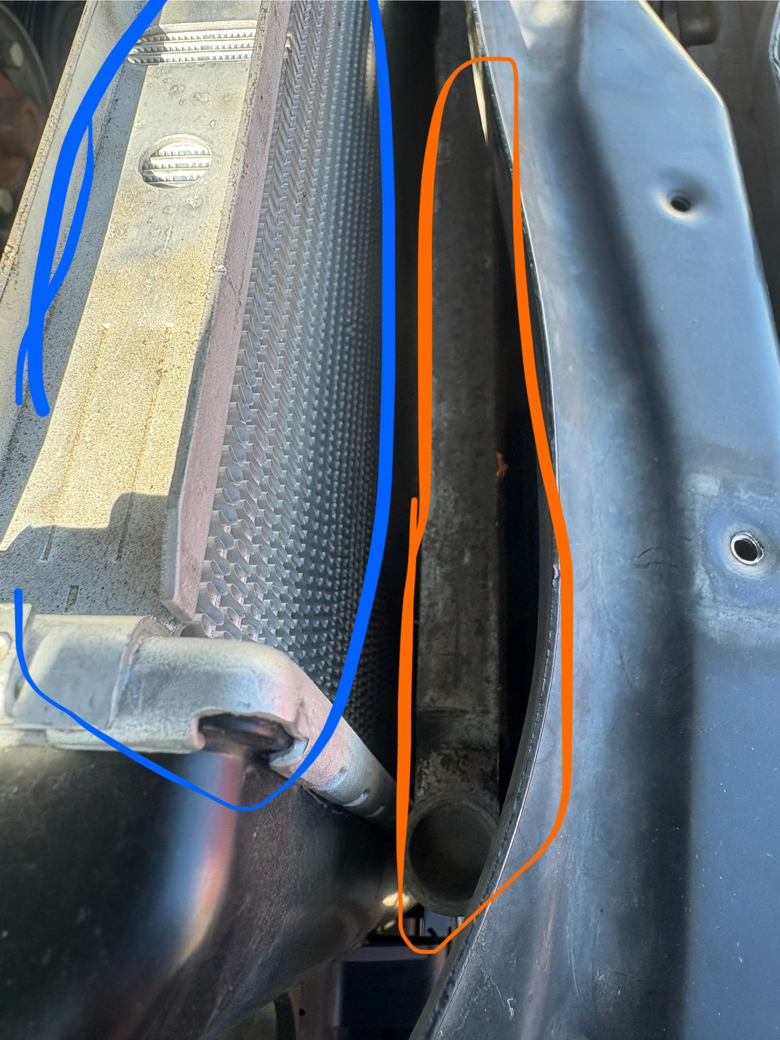

It isn’t inside on this one though. It has a radiator and a separate transmission cooler.
Wednesday, September 17th, 2025 AT 9:35 AM
ARIANADANIELLE5345
  • 398 POSTS
Here’s a pic. At least I’m assuming that’s what that is.
Wednesday, September 17th, 2025 AT 9:42 AM
KEN L
  • MASTER CERTIFIED MECHANIC
  • 55,499 POSTS
Hmm, does it have transmission cooling lines going into the radiator?
Wednesday, September 17th, 2025 AT 9:45 AM
ARIANADANIELLE5345
  • 398 POSTS
Lol never mind it’s A/C condenser.

She said she just had the radiator replaced not too long ago so I’m thinking that maybe they didn’t change the reservoir and that’s why the radiator wasn’t that dirty but the reservoir is full of gunk.
