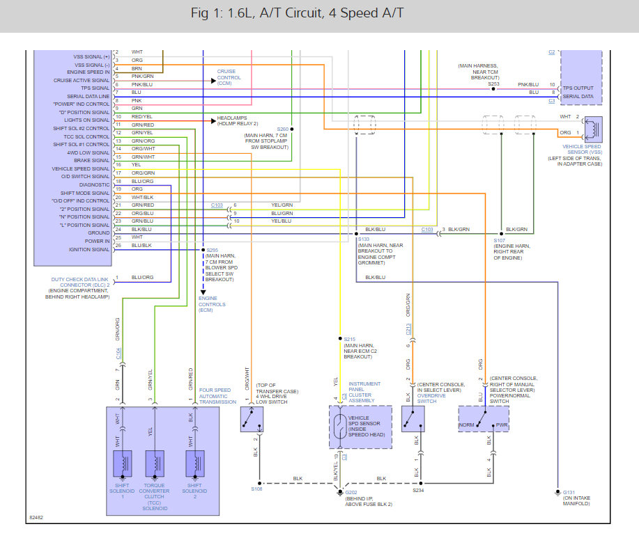

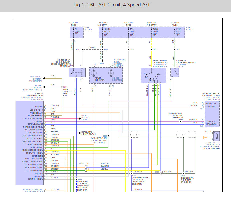

Okay, it sounds like we need to check all fuses with the key on. Here are the wiring diagrams for the transmission which show you have a VSS sensor inside the instrument cluster. Does the speedometer work?
Monday, October 24th, 2022 AT 12:48 PM
ROBERT UHLER
  • 11 POSTS
Yes.

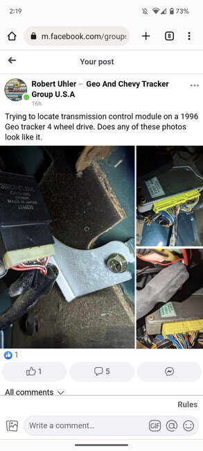

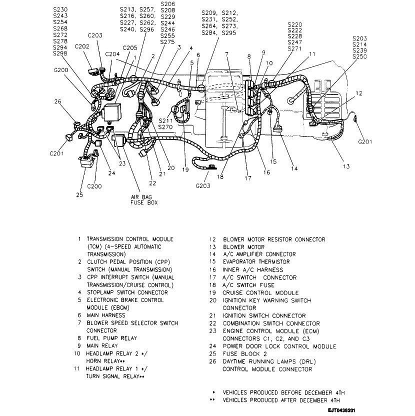

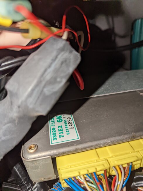

Let's try removing the transmission control module to check the electrical connector for corrosion, this will through off the values of the sensors and make it shift strangely. Check the image from below to see the location of the module.
Tuesday, October 25th, 2022 AT 1:50 PM
ROBERT UHLER
  • 11 POSTS
Could this be the module? The one wrapped in gray material.
Wednesday, October 26th, 2022 AT 7:02 PM
ROBERT UHLER
  • 11 POSTS

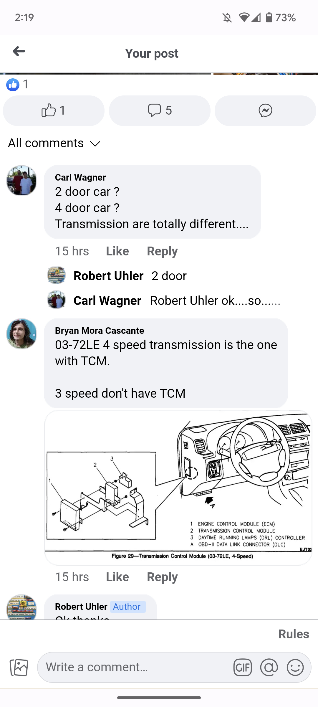

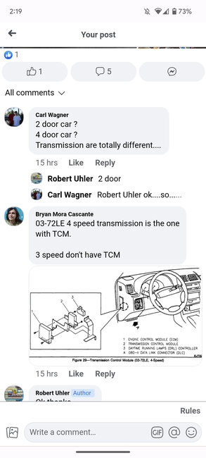

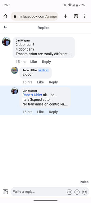

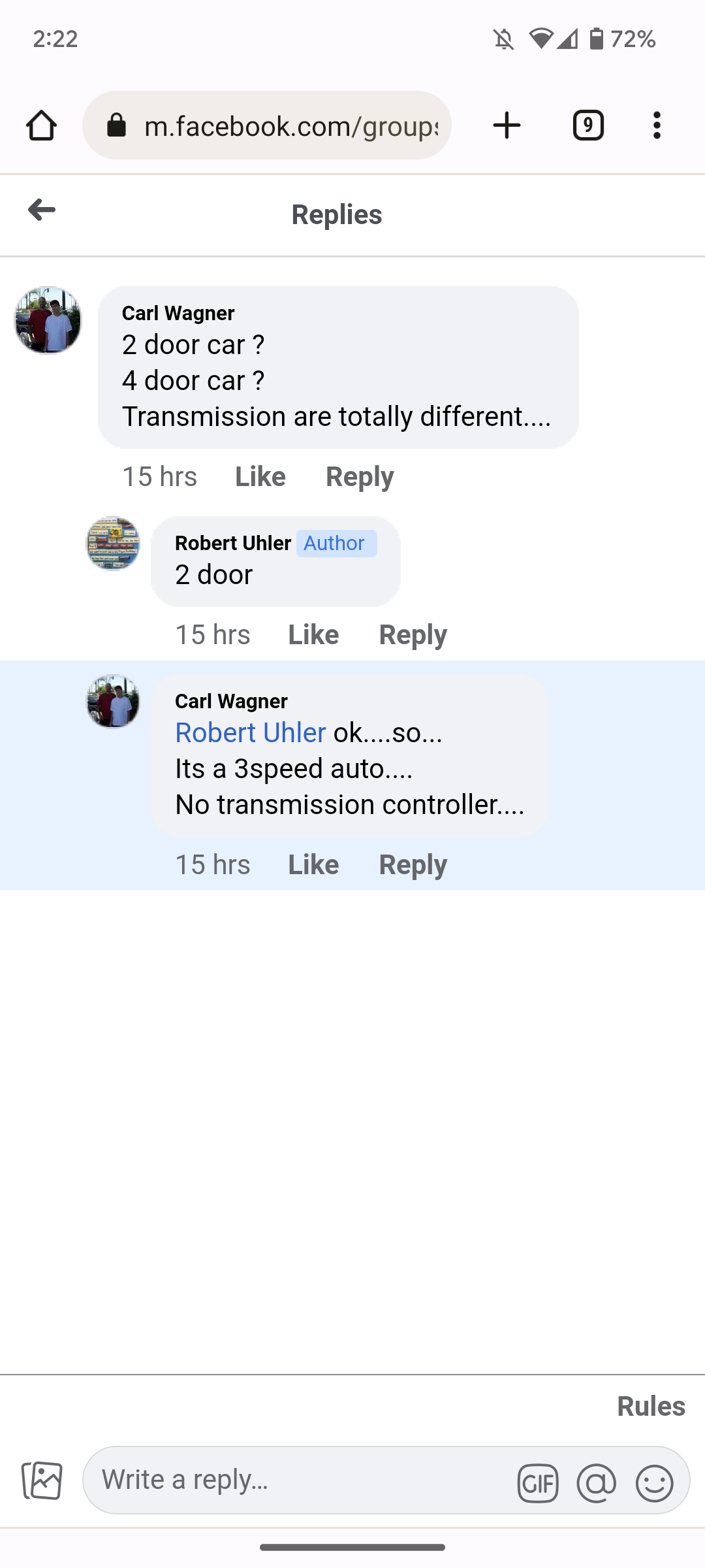

I have a 3-speed transmission. People on the Facebook page says 3 speed does not have a controller.
Wednesday, October 26th, 2022 AT 8:15 PM
KEN L
  • MASTER CERTIFIED MECHANIC
  • 55,266 POSTS
Can you forward the facebook page please?
Thursday, October 27th, 2022 AT 10:59 AM
ROBERT UHLER
  • 11 POSTS
Here are some screenshots of the post.
Thursday, October 27th, 2022 AT 11:21 AM
ROBERT UHLER
  • 11 POSTS
https://www.facebook.com/groups/1034172440036442/permalink/5601865699933737/?app=fbl
Thursday, October 27th, 2022 AT 11:23 AM
KEN L
  • 55,266 POSTS
Thank you, the guy said there is a three speed, but I do not show one for 1996 but in 1995 they do not show one so it could be a late 1995. How does the power of the engine seem, could you have a clogged cat causing the vacuum to be low therefore holding the gears longer because the computer thinks it is under load?
