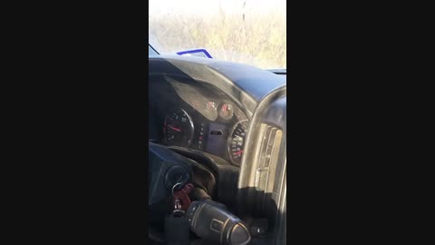

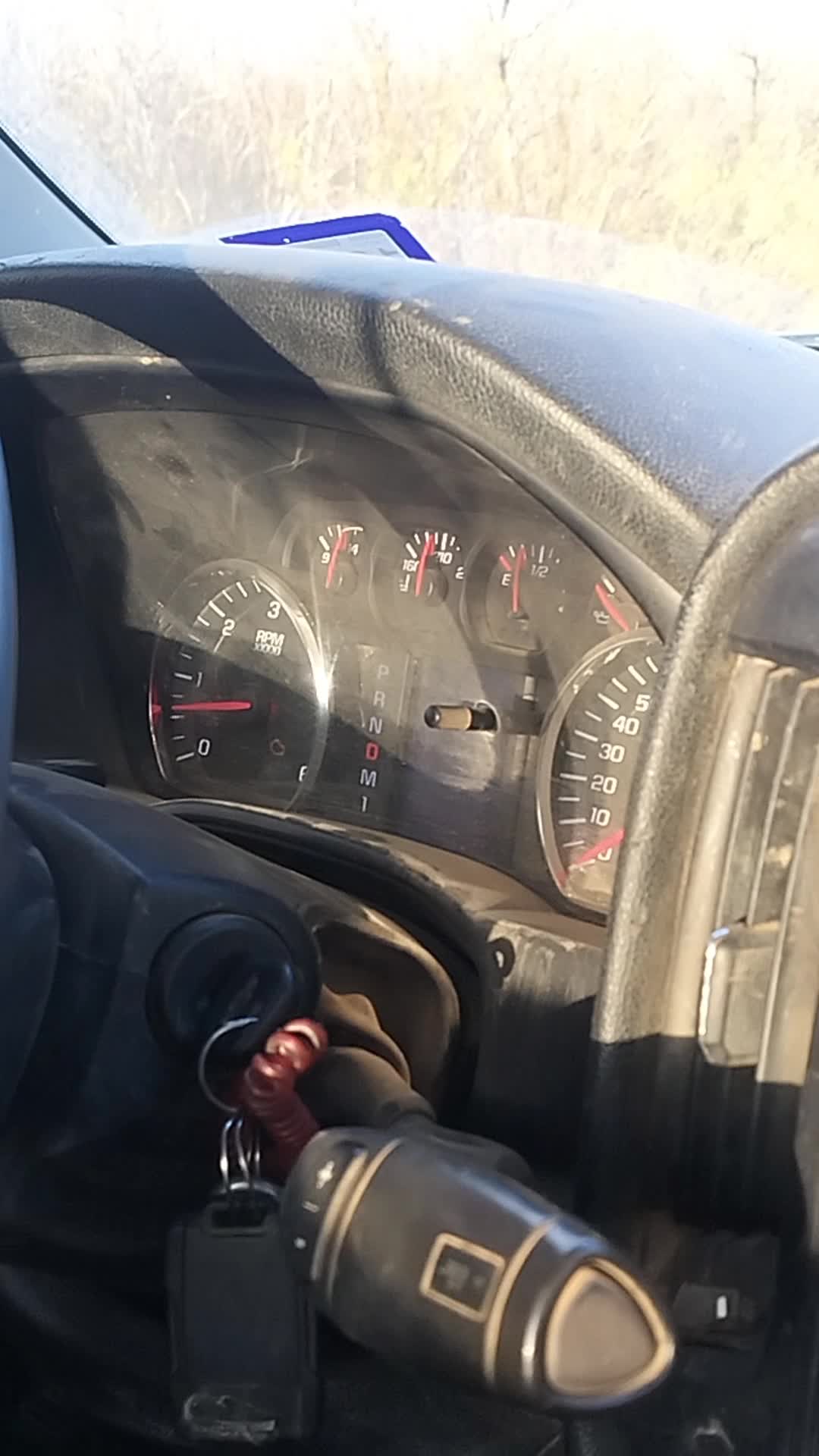

Sorry for video being hard to see we live on a ranch so we're driving on river rock which makes it so bumpy.
Thursday, January 2nd, 2025 AT 8:53 AM
LEYNA
  • 17 POSTS
But notice how when shifting RPMs goes up where I'm having issues as to why and what to check.
Thursday, January 2nd, 2025 AT 8:54 AM

Thanks for the video it helps. I can see the RPMs going up. Can I ask if when you did the fluid change did you change the fluid filter? I have seen the filter come loose form the valve body and suck air which can cause this issue.
