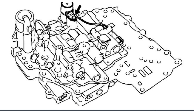

Transmission will not shift into drive. 1 and 2 shift fine, but will not go into drive but the RPM's shows that it did shift but engine is revved high.

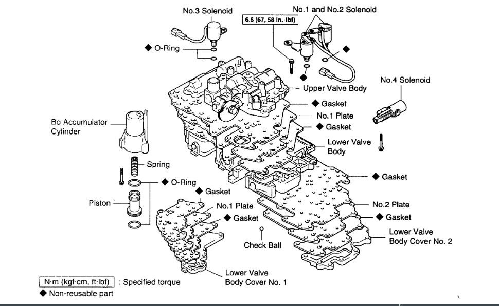

Good evening,
If you have drive in manual 1 and 2 then you have a valve body issue in the transmission.
Are there any codes set?
I do not see any TSB or symptom related issue with this.
