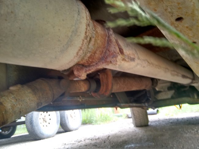

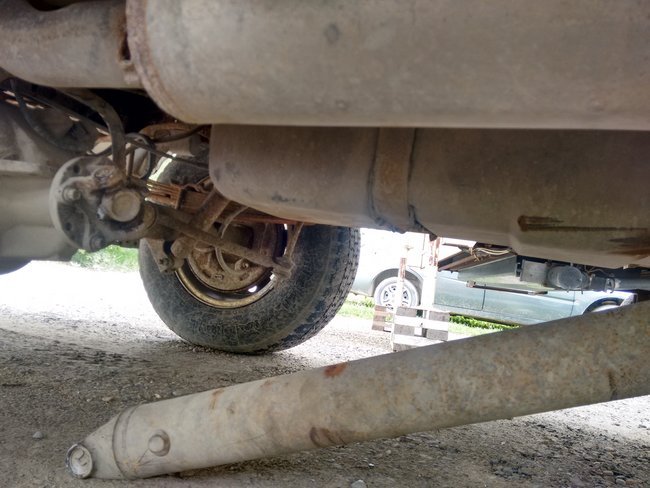

Hi there, last night I broke my rear u-joint and when I went to tow the vehicle home I could not get it out of park, but the truck still rolled in park because the drive shaft was hanging touching the ground. Is my shifter stuck in park until I fix the u-joint or is there another problem that it could be?

The shifter should not be stuck in park because of the drive shaft unless something is hitting or has damaged the linkage not allowing it to move. Check for damage there first. If that is good, make sure there is power to the brake lights. The park lock system will not release unless the brake light switch is getting power. If there is power to it and the lights are coming on, then I would suggest checking to make sure the park lock solenoid is getting power. Since the drive shaft dropped, chances are something has hit the linkage. Check that first to make sure nothing was damaged.

Okay, I checked the brake lights and they work. I have not checked the solenoid yet or the linkage, but it is a two piece drive shaft and only the back piece hit the ground, the front part never came loose, I will check the solenoid later after work.

This is what happened. I was at a red light and went to gun it to pass someone and the u-joint exploded, I put my foot on the break and shifted to neutral and me and my buddy pushed the truck to the side of the road, I put it in park, but the truck kept rolling so I put on the e-brake. I came back later after work to tow the truck home with my friend and could not get it out of park, but the truck was still able to roll while in park because the drive shaft was hanging and now the shifter is stuck in park.

With no connection from the rear to the transmission, "park" can no longer "park" the rear differential/ wheels, hence it will roll in any position.
Can you move/ turn the drive-shaft on the transmission end of it?
Maybe doing this tweak will let the shifter turn loose.
Maybe you lucked out and did no damage to the transmission.

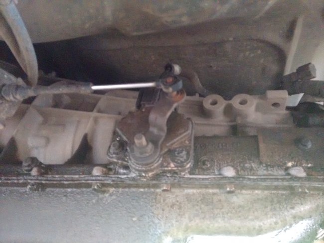

Can you move the arm on the transmission? If not you must remove the transmission pan to see if what happened, it might have broken the parking pin or jammed it somehow.

yes I just tried this earlier, I removed the cable at the transmission and was able to shift into every gear with the arm on the tranny

Sounds as if the park pawl has failed in the transmission, was park selected with the car in motion? This is the most common cause for a broken park pawl.

Thanks for all the help everyone. I found out the problem when I dropped the steering column, the switch on the solenoid was stuck I just hit it with my hand and now it works fine everytime
