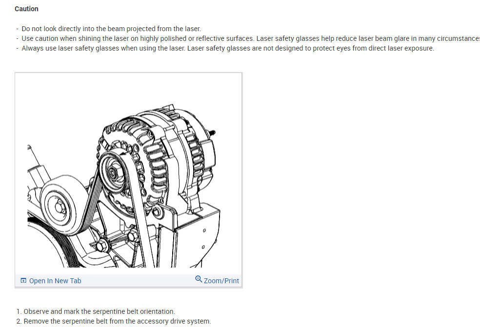

How do I change the serpentine belt?
Monday, December 19th, 2016 AT 4:58 AM
MECHANIC
52,796 POSTS
Good evening,
I attached the drive belt diagram for you to view. You need a long wrench to contact the tensioner and then turn it clockwise to release the belt.
