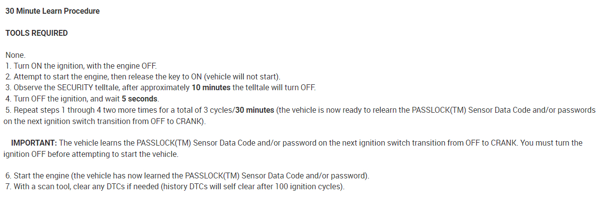

I need you to try something. Turn the key to the run position and wait for approximately 10 minutes to see if the light turns off. If it does, see if it then will start.
If that works, perform the attached reset procedure. It will take 30 minutes but should take care of the issue.
See pic below.

This security light doesn't go off after 10 minutes, not 15.

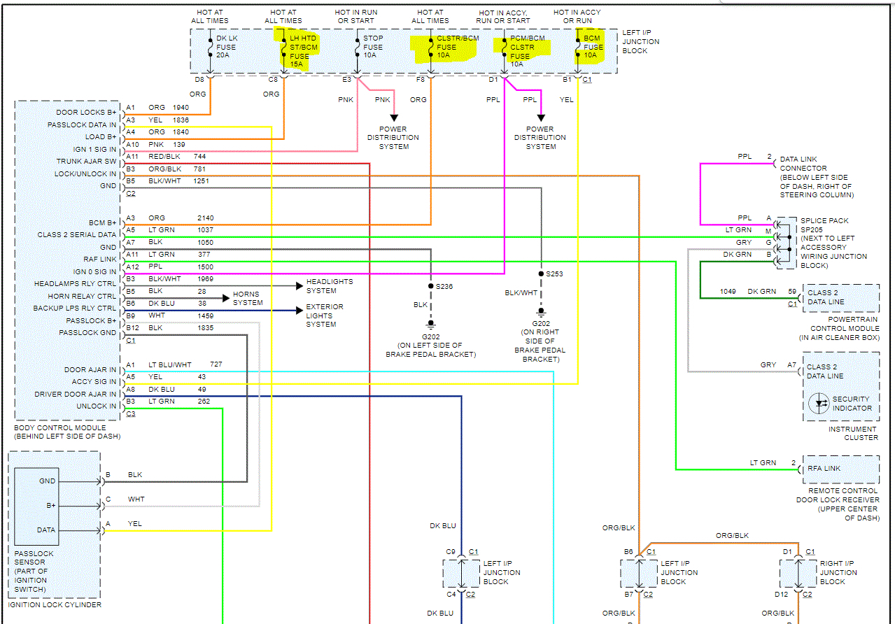

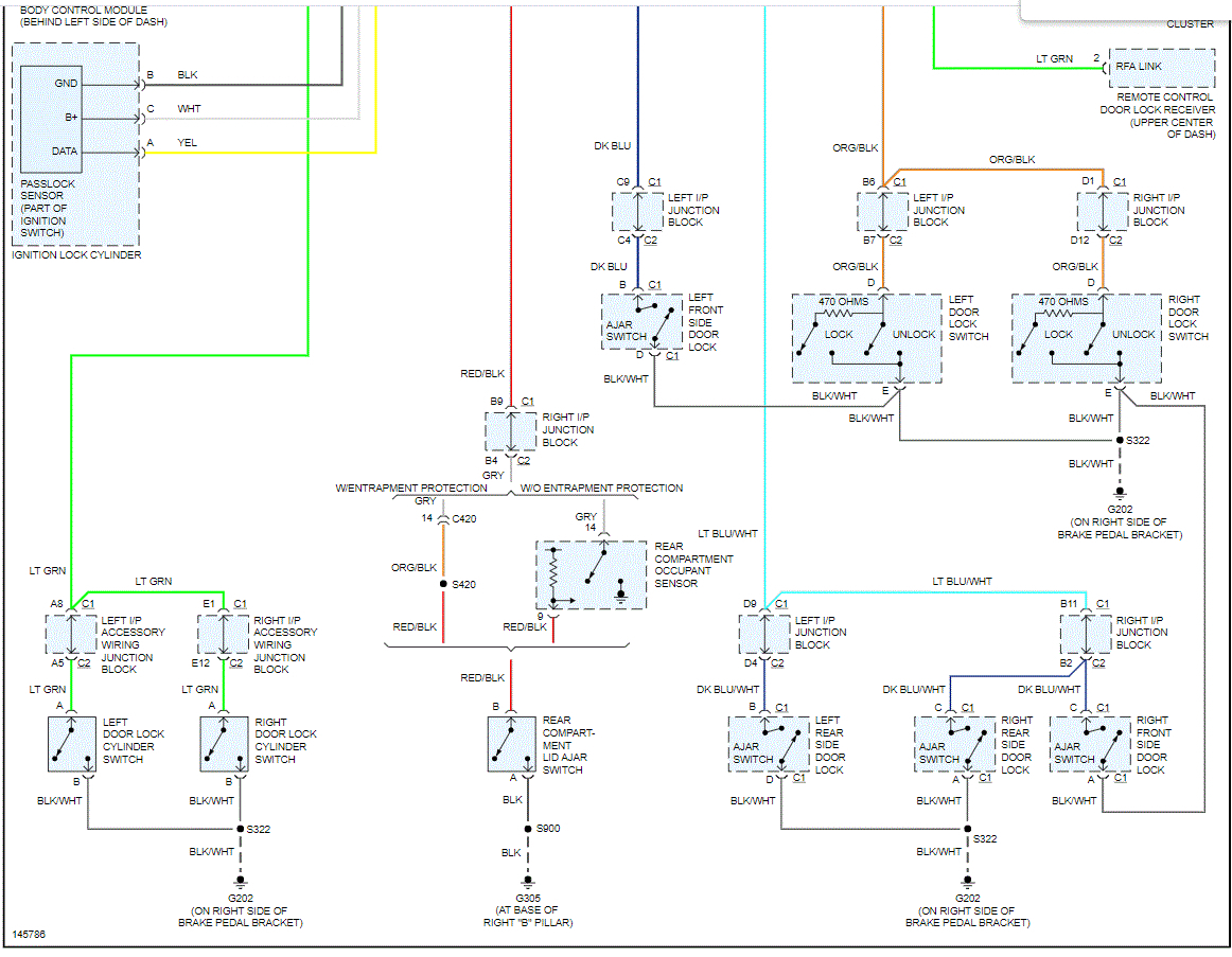

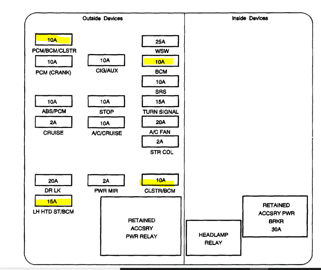

Okay, at the end of the left instrument panel is a fuse box. Pic 3 shows four fuses I need you to check. Additionally, make sure there is power to and from the fuses.
Also, pics 1 and 2 are the wiring schematic for the anti-theft system. I'm providing them for a reference.
Let me know what you find.

They are not burned out, the fuses.

Are you getting power to and from them? The fuse could be good, and failure happened before the fuse.
If there is power and the fuses are good, go to the body control module and see if it is receiving power from the fuses you checked. Wire color is provided in the schematic.

If I've done this correctly here's the readings I got:
PCM/BCM/cluster: with key on, without key on both 0
BCM; with key on without key on 0
lh/htd/st/BCM: with key on, without key on 0
clstr/BCM: with key on.04, without key on 0
Thursday, September 30th, 2021 AT 8:36 PM

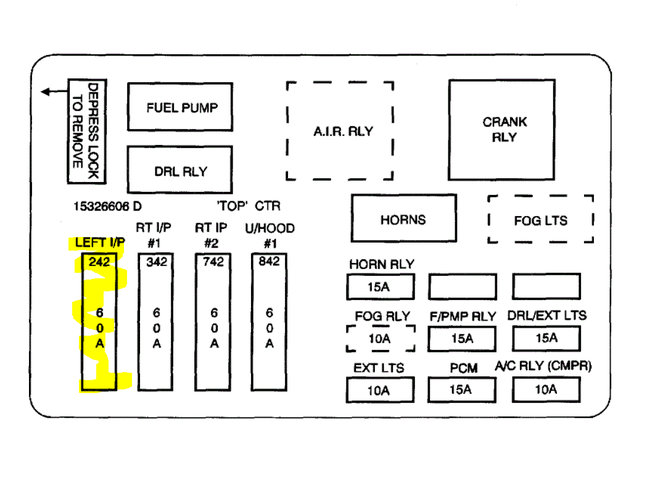

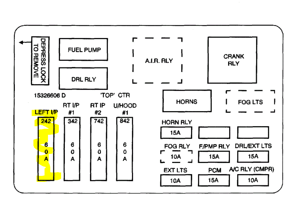

Are they all not working (no power)? If that is the case, go to the under-hood fuse box and locate the left instrument panel fuse box fuse (60 amp). That fuse is what powers the interior fuse box and components you are checking.
I attached a pic below of the fuse location.
See pic below.
