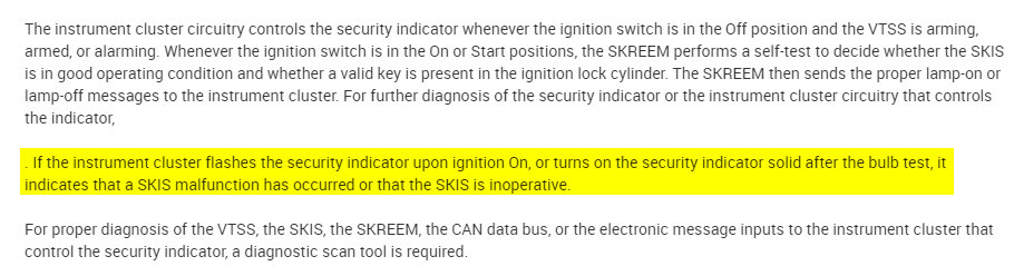

This all indicates that the key is most likely the issue. Please see the attachment. The SKIS or Sentry Key Immobilizer System requires the key and security system to acknowledge they are ok to start the car. Then they send a signal to the PCM to allow the car to start.
When the light flashes or stays on it means this system has failed.
If you can scan the computer with a scan tool that will help identify what the issue is. Let me know what you find and we can go from there. Thanks

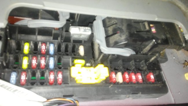

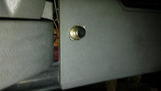

Yes that's what I'm saying ' I put the Aluminum foul in the fob for better contact and it worked. No I do not have another key and I've been looking for this Mysterious Valet/override button and can not find one ' I had a mechanic take a look at it today ' and he got under the truck and did something to the starter and the engine did make an attempt to turn over. He said the battery was may have a dead cell 'but I don't think that's the issue. I checked and My battery was at 12.7 when the truck is not running but when I did a scan it said low voltage system besides the jerk stole a screw driver and my Micro Mechanic scanner I had plugged in the truck so I don't truck him a thing he said, He did say that he think the key needed reprogramming though. The other thing is ' I checked all the fuses and the fuses in the little yellow clip did not light up but they are not blown that's weird seeing that these are the two fuses they say to take out to do a soft reboot of the security system. I've sent a picture of that ' and some Mysterious button down by the kick panel someone had installed inside the truck before I bought it.

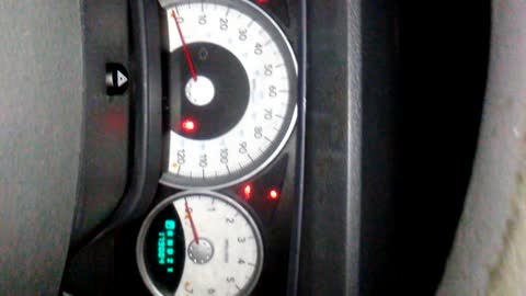

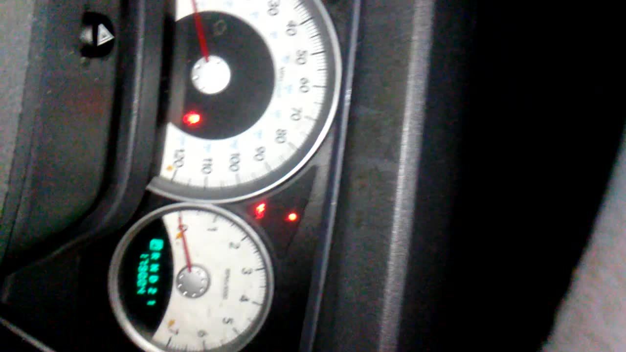

Other picture and video of security light light.

I prayed a lot and my prayers was answered. Wicked demonic security system. The security light was flashing and absolutely will not go away while trying to start the vehicle. The engine Seems dead, No sound at all 'except for a click from a relay down by the kick panel will not start.
The key will open and lock the doors just wont start the truck. I tried all those tricks locking and unlocking the doors 'pulling out the two fuses that's paired together ' none of that worked.
But I want to thank you for all your help ' the conversations in these threads lead me to the right decision 'if I had -had my truck towed to a shop I'm sure I was going to be taking for a ride. I called a locksmith ' He was out at my house no more than 5 min and it was running light is out ' no more silence when I turn key. My my truck was down for three days and facing a hefty repair bill. All it took was a lock smith.
It was my chip in the key. So here are the symptoms my truck had:
Wife went to the store, turned off the truck, got back in tried to start the truck.
It turned over but would not start, this happened about 3 times. No sure how many
I thought it was the fuel pump. In a way it was
all the bells and dash lights worked, and went out like normal ' then came that dreaded flashing little round circled light which in this vehicle is the security light. It was blinking constantly. The radio worked the lights worked every thing worked, except the engine. I hope this help someone who think they're truck is dead. It is not dead just in an automotive coma, or at best catatonic state. Call a lock smith before you go to a dealer.(Pray that it is only a bad chip.) They will cut you another key' this one has no unlock or panic buttons on it but it work. I still use the other key to unlock and lock my vehicle I just do not put it in the ignition. . The cause was: My key chip was dead ' even though it still operated my doors windows panic button still worked ' it just wasn't sending a signal to the computer to let it know to start the vehicle. The fix: A new key was cut and programmed.
