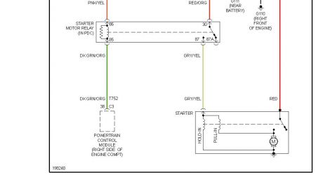

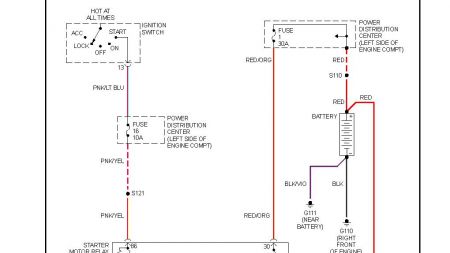

when turning the key, I get a clicking sound and all my lights work along the dash as well as the power windows. But the only way to start is by jumping.
I have a mulit meter and know how to check the battery, but I don't know what to connect to check alternator. I have a feeling it's between the alternator and the starter.
What should I do?
Thanks for the help,
rita
+1
Monday, April 1st, 2019 AT 9:51 AM (Merged)
  • 75,992 POSTS
Check fuses no.16 10amp and fuse no.130amp. If okay do below
Get a helper to hold key at start position find starter and bang on it-if it kicks over-replace the starter. If not backtrack it to the starter relay and ignition switch. See below
https://www.2carpros.com/forum/automotive_pictures/12900_st1_6.jpg
https://www.2carpros.com/forum/automotive_pictures/12900_st2_6.jpg
