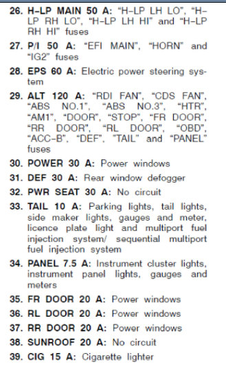

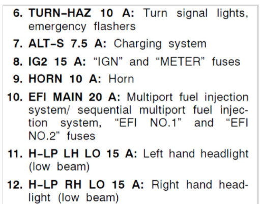

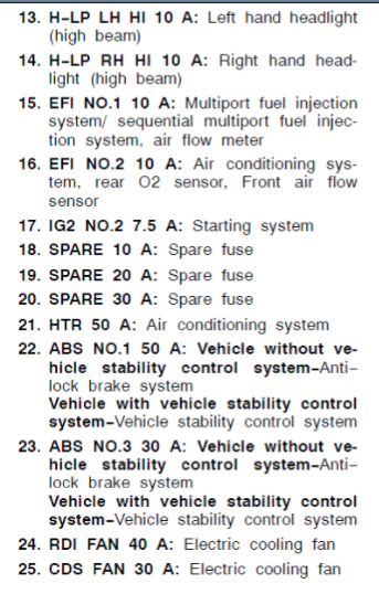

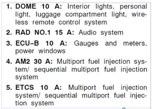

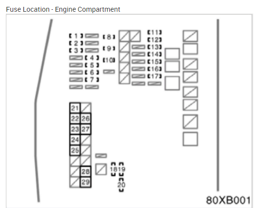

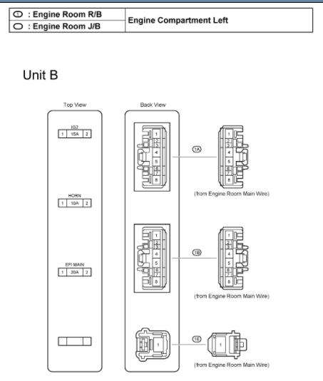

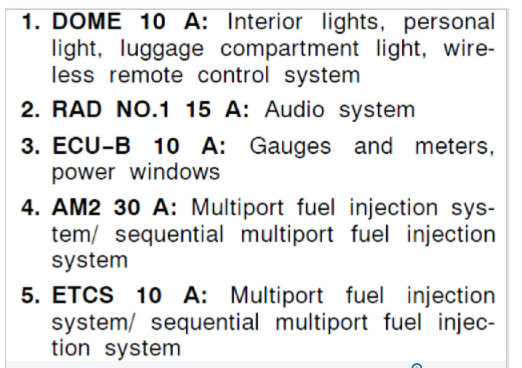

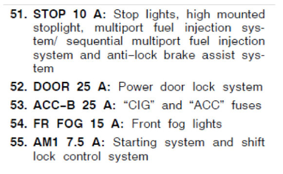

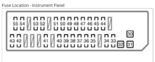

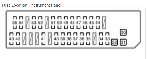

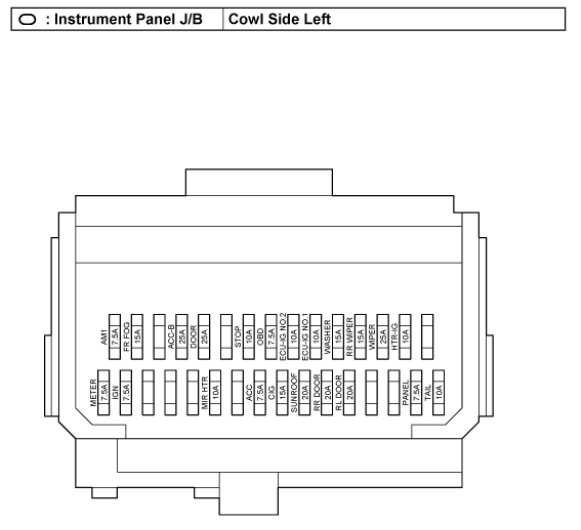

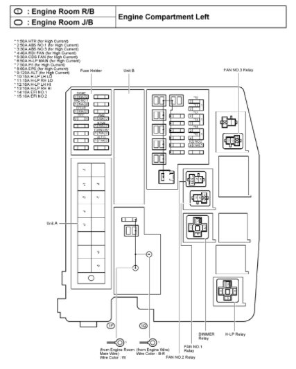

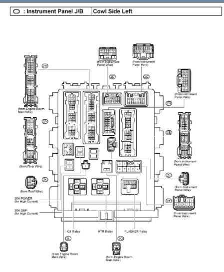

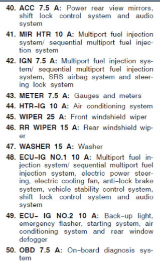

The blinkers stopped working I need to check the fuses. Thank you. Len
Sunday, June 13th, 2010 AT 9:32 PM
DANNY L
MECHANIC
5,648 POSTS
Hello, I'm Danny.
Here is the information you requested. Here are a few tutorials for you to view on how to check and replace fuses:
I've attached pictures below showing the fuse and relay locations on your vehicle. Hope this helps and thanks for using 2CarPros.
