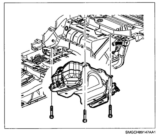

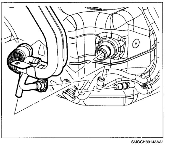

Both primary and secondary fuel tank modules require fuel tank removal. Here is a guide to help you step by step.
https://www.2carpros.com/articles/how-to-replace-an-electric-fuel-pump

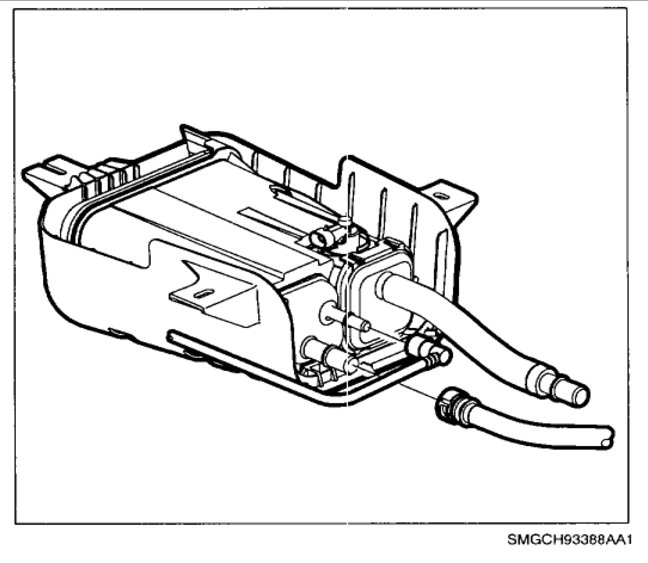

Recently my car started to smell of gasoline while driving and after it was parked. The mechanic at the service station checked it for me and showed me where it was leaking from which was near the gas tank. He explained that my fuel pump was probably fine but that on saturns it had to be replaced as a unit. He quoted me 650. For the pump and 425. For labor. Can't I just get the fuel lines replaced instead or somehow repair the leak. Thank you in advance for any advice you could give.

It's a 6 cylinder 3.5 engine. 2 wheel drive. The area under the car that he showed was leaking wasn't the gas tank but a plastic container near it. My zip is 92262.

Wow you live in palm springs thats not too far from me I used to work at the saturn dealer in catherdral city on perez road. The only thing I can think of back by the tank and then can be called a box would be the charcoal canister which only has fuel vapors going to it not liquid fuel. For a fuel pump replacement in your area I have 339-630 for the fuel pump depending on where you get it. Also the labor should be 180-230 so there labor is way high also the fuel pump itself price is high.

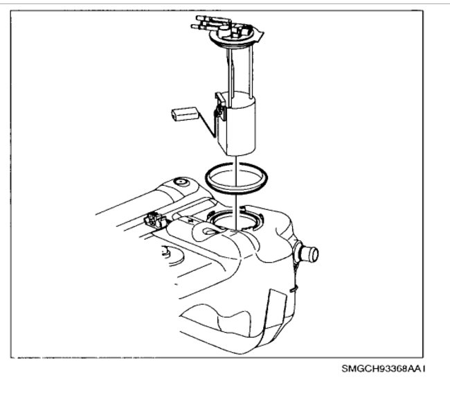

There is what is called the fuel pump module that holds the fuel sending unit fuel pump fuel pick that goes into the top of the fuel tank it also has hard plastic fuel lines molded onto the top of it that arent replaceable. If one of those lines leaks the whole assembly has to be replaced.

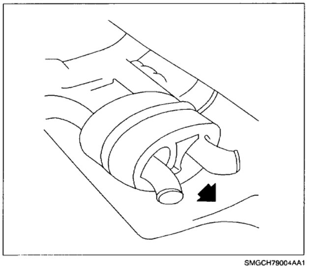

Yep this is a classic fuel pump problem which is sounds like it needs to be replaced. Here is a guide to confirm the problem.
and here is what you are in for when replacing the pump.
Check out the diagrams (Below). Please let us know what you find. We are interested to see what it is.
