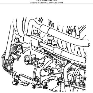

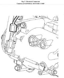

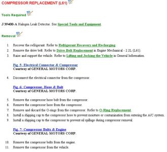

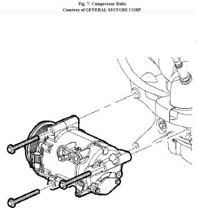

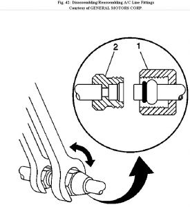

I need a/c compressor replacement instructions asap
can you help?

Post will be coming, but why did it fail?

Depending on why it failed, may require flushing the system. The drier will need to be replaced at the same time to absorb moisture from opening the system. Strongly recommend getting a new one not a rebuilt or re-man unit.
