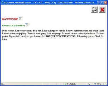

Engine Cooling problem
1997 Saturn SL1 4 cyl Two Wheel Drive Manual
How do you change the water pump.

u will want to break loose the water pump pulley bolts before u take the belt off.there is a drain at the bottom of the radiator passenger side.there is also a block drain that will save a big mess.its behind the thermostate housing underneath the car just follow the lower hose to the engine.make sure u dont loose the washer for it.good luck let me know how it goes.

Thanks I got it done yesterday evening I appreciate the help.
