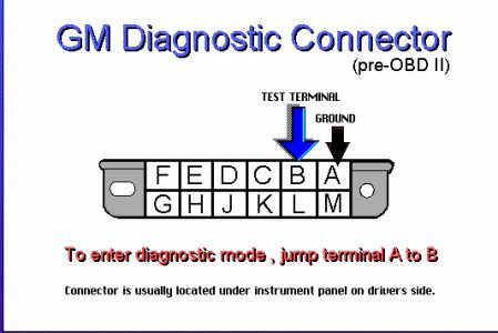

Lets read the codes then, and post the ones that flash! Cross these two terminals"A" and "B" as shown, then turn the key on. Count the flashes, a 22 will flash as 2 flashes then a short pause, then 2 flashes, if more than one code is stored, the pause will be longer. The codes will display three times and end with 12. Write them down and post here. This connector is right under the middle of the dash...
https://www.2carpros.com/forum/automotive_pictures/62217_Pre95GM1_1.jpg
Thursday, July 30th, 2009 AT 6:57 PM
CALDSTEVEN
  • 5 POSTS
Sorry, but how do I cross them?
Thursday, July 30th, 2009 AT 7:11 PM
MERLIN2021
  • 17,250 POSTS
Paper clip, or a small piece of wire.

Ok I think the codes are
32
blinked 1 time, pause, 2 times, little longer pause, then repeated the same two more times
Then a longer pause
blinked 3 time, pause, 2 times, little longer pause, then repeated the same two more times
Then started over doing the 1, 2 and then 3, 2
Sorry if I didn't do this correctly.
EDIT: After rereading the post I believe the code would just be 32.
Friday, July 31st, 2009 AT 4:31 PM
MERLIN2021
  • 17,250 POSTS
32=EGR problem, or MAP sensor voltage low, so check for the EGR sticking open.
Saturday, August 1st, 2009 AT 3:40 PM
CALDSTEVEN
  • 5 POSTS
Would that cause the kind of problem I'm having?
Saturday, August 1st, 2009 AT 3:47 PM
MERLIN2021
  • 17,250 POSTS
Either one would. EGR is the more common problem.
